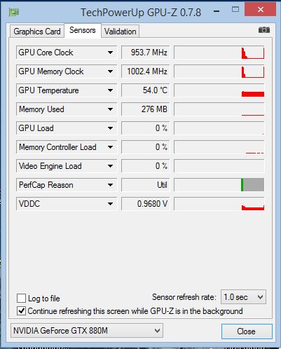

Nothing to do with temp/voltage, I am using stock vbios and it fails as soon as the driver is updated. It looks like the driver checks for some flag on the gpu and if set, will act severely underpowered. In fact, on this behavior, the temps never go above 70°
In fact, as soon as I update the driver, the perfcap kicks in in the sensors on GPU-Z

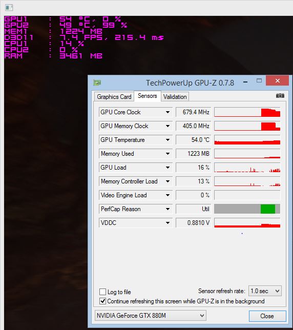

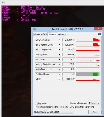

That's what it looks like under load with the new driver and stock vbios. There is no way I can keep using the Alienware like this.
