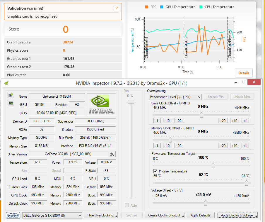

Good now go forward will always use the test CLOUD GATE to have a parameter:
The test now endured a little more locked when the ship was almost across the screen (Fisics test)
the other 2 all ok, a flicker on the screen in the second phase of the test but everything ok.
The test hangs when the video driver also stops responding

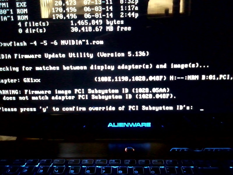

whenever I install your BIOS warning message
Right, I never uploaded a version for the Asus. Need a copy of your vbios for this.

327.23-notebook-win7-win8-64bit-international-WHQL with nvdmn.inf_v327.23_AW_GTX_880M
that you sent me the following Same thing with the 337.88 driver,
giving following crash tests in 3Dmark, and on games.
anyway thanks.
Accept any other suggestions .... = /
Unexpected error running tests.
Workload Single init returned error message: File: device_resources.cpp
Line: 313
Function: class eva::com_ptr<struct id3d11buffer=""> __cdecl eva::d3d11::device_resources::create_buffer(const struct D3D11_BUFFER_DESC &,const struct D3D11_SUBRESOURCE_DATA *) const
Expression: hr: DX11 call failed [-2005270523].
Hardware device removed.
Tried run trine 2 , game not start,bugfield 4, black screen.... just for examples..
DXGI_ERROR_DEVICE_REMOVED: ID3D11Device::CreateBuffer:
same...</struct>
I have no direct stabilizer is in the making, reinstalled 337.88, because the problem is of course not the drivers tried 3 and all present the same'' locked'' in 3DMark tests and games ...
I will download the nvinspector, because it's all original not changed anything

ok, that is just way to many problems.
Either your gpu is bad or you need to pull it out and reseat it a few times.
Then maybe a fresh windows install.

Recently: I disassembled the notebook cleaned up, formatted it notebook, and works perfect, but with the new BIOS does not work: (
Saw my Bios? can say that the differences between one and another? has some configuration that should be incompatible, because if not, with my bios would not work
Can you run an over clocked run of 3dmark11 gpu only test?
And one stock.

no one could explain it to me so far ... I think it's because at the moment will install the bios as different firmware, and or because the procedure I need to do when installing the video drivers, which is to replace some numbers in the ini video driver

unfortunatly as of today i had to revert to the original vBios for my 880M.
no game/benchmark i tried (dota2 / watchdogs / 3Dmark11 / 3Dmark13) ran for more than a few seconds without either constant throttling (read: erratic switching between 993/836/614mhz core) or a complete video-driver crash.
however i did not try to use an older v-driver (327.xx is what has been suggested i believe) since i don´t see a reason using an old driver just so the standard clocks keep stable.
using v337.88 + original vbios at least i was able to play games with (although it still throttles the core some times).
kinda sad right now, coming from an 680M with a modifed vbios, i really hoped for more. but i guess nivdia fuc*ed it up this time around -.-
