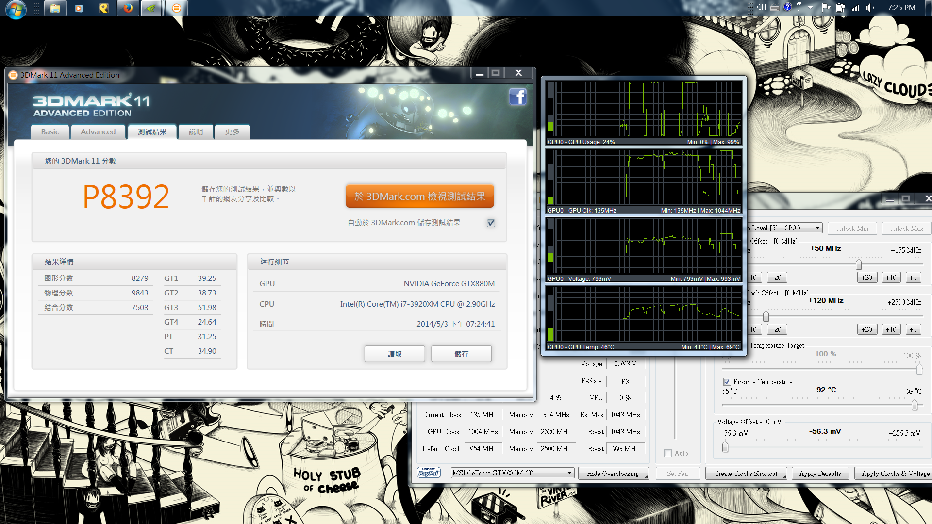

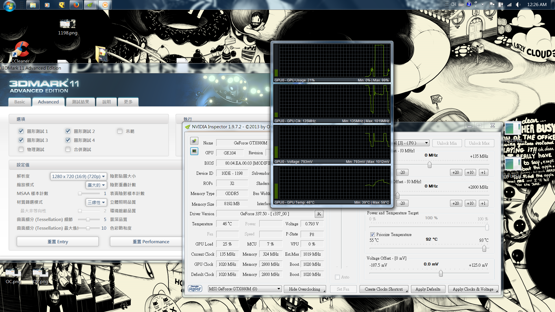

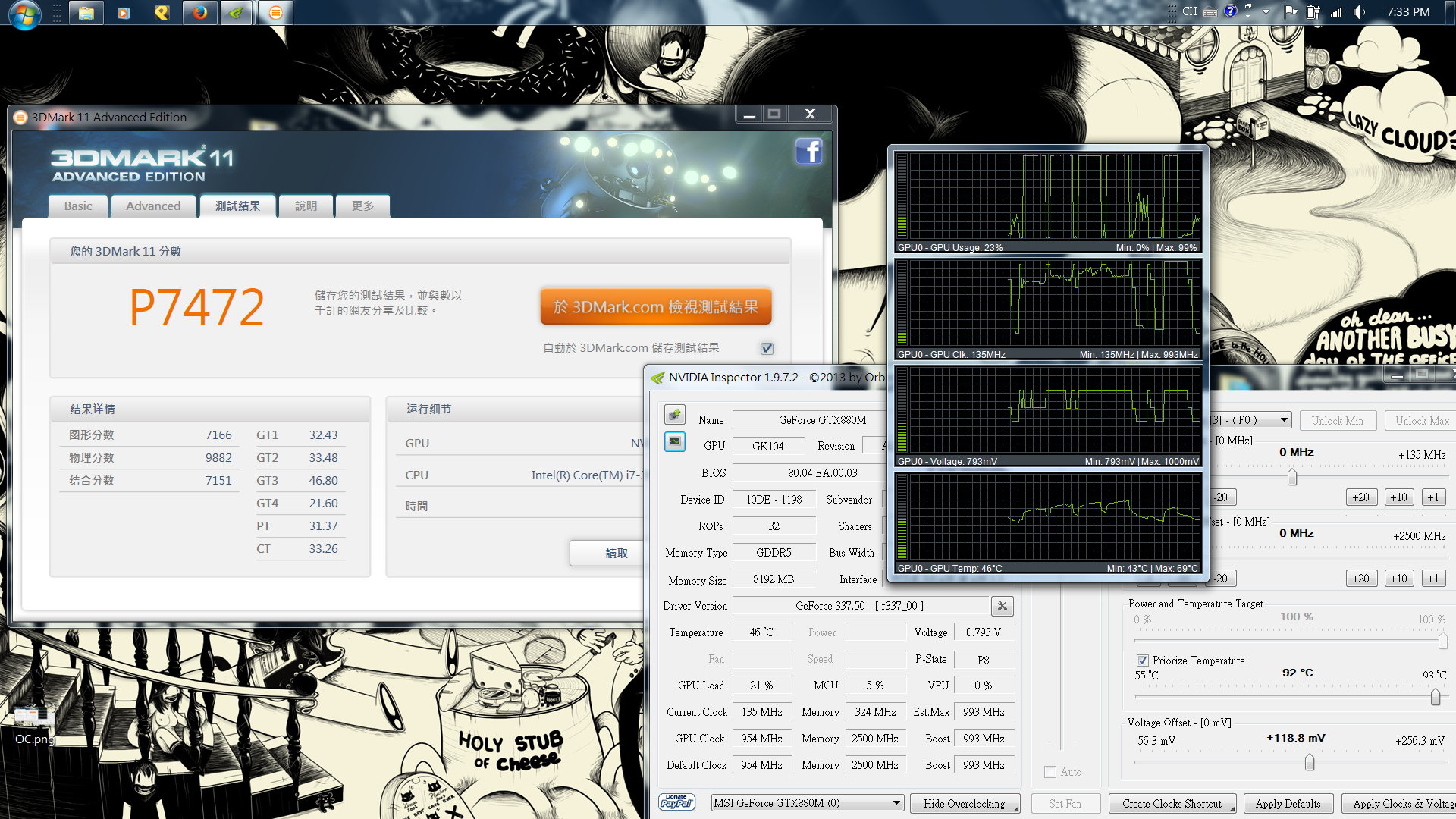

Here is my GT70
3920XM, GTX 880m with stock vbios and stock clock,
[ATTACH=CONFIG]11510[/ATTACH]
and here is OC to +50 clock and +120 memory.
[ATTACH=CONFIG]11511[/ATTACH]
With stock clock or overclock,it is throttling,when OC over than +50,it always crash.
At stock vbios,voltage is adjustable,but when I OV to 1000mv its got more seriously throttling.
Here is the stock clock with OV to 1000mv
[ATTACH=CONFIG]11512[/ATTACH]
