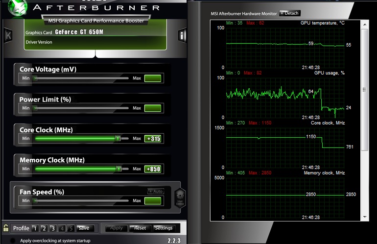

sh0gunshin Posted November 22, 2012 Share Posted November 22, 2012 i'm also experiencing small downclocks while i'm gaming. it causes some weird input lag as well similar to 60 fps spiking down to 30 fps (except im still flatlining at 60). ive tried different clocks (135 & 250, 200 & 400) and still experience the issue. i also tried turning off my turbo boost and it still happened (blops2). the downclock near the end is when i alt tabbed, which can be deducted from my gpu usage. the problematic downclock is during actual gaming as you can see under Max: 1150 MHz I also have a GT 650M in my laptop which I do some gaming on occasionally when I'm on the road. I also see this behavior with some games in certain circumstances. What you're seeing is the boost clock being dynamically throttled down due to power or thermal constraints. Unlike CPU overclocking, overclocking on Nvidia Kepler GPUs basically just raises the clock speed ceiling for boost, instead of setting a hard clock target at load like CPU overclocking. Your temps are well out of the range of thermal throttling, so it's very likely the GPU boost clock ceiling is not being reached because the GPU is exceeding its rated TDP at such high clocks under certain loads, which forces the boost clock to lower to remain within spec. I'm not sure that there's a way to modify the TDP target of mobile Kepler GPUs, but if so, that's the solution to your issue. if this is the case what can i do? Quote Link to comment Share on other sites More sharing options...
Stevenxowens792 Posted November 22, 2012 Share Posted November 22, 2012 Im really not sure on this one.. The 650 is a strange beast in that, if the utilization threshold is not met, it will not fully turbo correctly. If the temps get to high, it will down clock. Have you tried completely disabling the CPU turbo (using the same gpu clocks) and see if the same issue happens? Thanks! Quote Link to comment Share on other sites More sharing options...
sh0gunshin Posted November 22, 2012 Share Posted November 22, 2012 Im really not sure on this one.. The 650 is a strange beast in that, if the utilization threshold is not met, it will not fully turbo correctly. If the temps get to high, it will down clock. Have you tried completely disabling the CPU turbo (using the same gpu clocks) and see if the same issue happens? Thanks!yep. its not cpu. also i can easily force 99% usage (if that's the usage you're talking about?) by turning vsync off, but seeing as the m14x r2's frame rates are capped at 60 i don't see the point of turning it offshould i try turning off windows aero and force the cpu to process more of the graphics n see if it will affect anything?would forcing dynamic throttle off using nvidiaInspector help my case? Quote Link to comment Share on other sites More sharing options...

Stevenxowens792 Posted November 26, 2012 Share Posted November 26, 2012 1. The m14x is not capped at 60fps. I play bf3 above 60 all the time as well as other games. 2. the cpu and gpu have a "shared" cooling system. If you lower the cpu speed by disabling cpu turbo it will not "heat soak" the GPU and help keep it cooler. It really depends on whether or not your game or program requires the higher cpu clockspeed. 3. You should ALWAYS take steps to make sure your machine is running at its best. Setting windows to run for "maximum performance", cleaning registry, keeping hard drives defragged, removing unnecessary services and or drivers, etc. Good luck, StevenX Quote Link to comment Share on other sites More sharing options...
sh0gunshin Posted November 26, 2012 Share Posted November 26, 2012 1. The m14x is not capped at 60fps. I play bf3 above 60 all the time as well as other games. 2. the cpu and gpu have a "shared" cooling system. If you lower the cpu speed by disabling cpu turbo it will not "heat soak" the GPU and help keep it cooler. It really depends on whether or not your game or program requires the higher cpu clockspeed. 3. You should ALWAYS take steps to make sure your machine is running at its best. Setting windows to run for "maximum performance", cleaning registry, keeping hard drives defragged, removing unnecessary services and or drivers, etc. Good luck, StevenXI mean my monitor's refresh rate is 60 hz seeing as i don't play with an external monitor & nvidia CP vsync being forced on.Yeah i keep my laptop optimized and have already done everything that you've listed. Thanks Quote Link to comment Share on other sites More sharing options...
