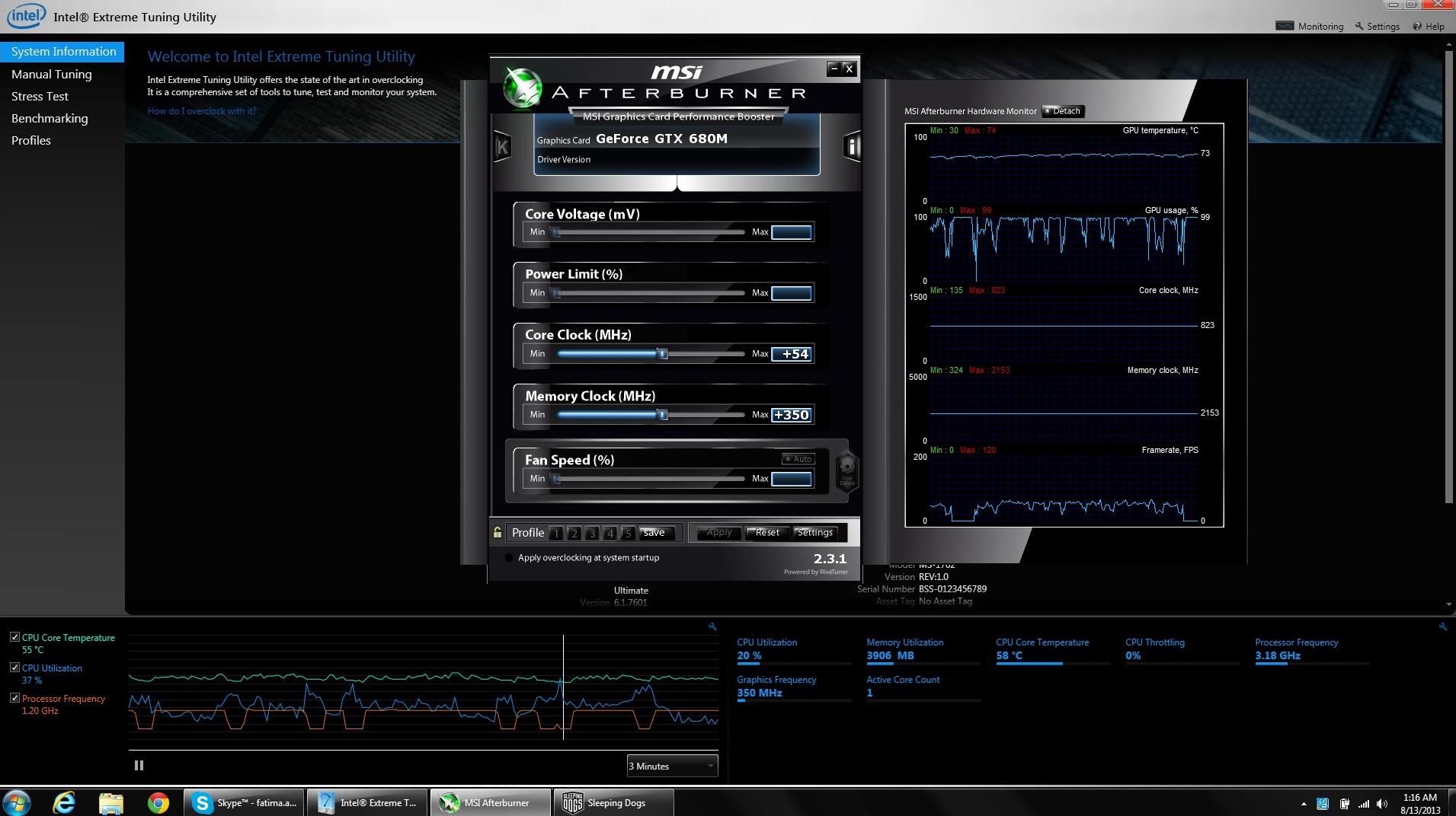

Captmario Posted August 13, 2013 Share Posted August 13, 2013 Guys im having this severe CPU throttle issue in games, there is random CPU frequency drop to 1.2 ghz.. im on 1762 barebone 3630qm with 680m. I heard GT70's had this once and some beta EC solved it, but im on a barebone and that beta EC won't work for me. Do you think this BIOS will help? im currently on E1762IG6.70U and EC is 1762EG62 Ver 5.02 What should i do? Quote Link to comment Share on other sites More sharing options...
Geoning Posted August 13, 2013 Share Posted August 13, 2013 Guys im having this severe CPU throttle issue in games, there is random CPU frequency drop to 1.2 ghz.. im on 1762 barebone 3630qm with 680m.I heard GT70's had this once and some beta EC solved it, but im on a barebone and that beta EC won't work for me.Do you think this BIOS will help?im currently on E1762IG6.70U and EC is 1762EG62 Ver 5.02What should i do?[ATTACH=CONFIG]8678[/ATTACH] Quote Link to comment Share on other sites More sharing options...
