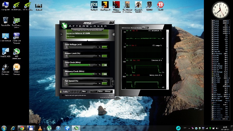

i noticed something: post-7546-14494994248887_thumb.jpg
if i run the nvidiainspector with windows start the p-states change earlier. If dont you can see. I think it is a long time. or it is normal? (i started windows with my settings 1130/2800)
