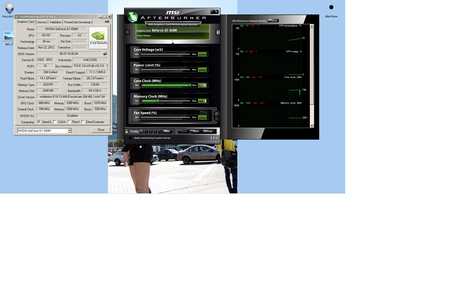

Here is the gpu-z screenshot with max overclock. Notice it shows the updated boost clock of 1070. (stock is 745). Yeah... now to see if that's stable... LOL
Hehehe, very nice, if you get the chance, can you please attach a GPU-Z log file here (or send it to me per email) I'd like to check it out, I'm wondering whether there's a better way to do this, I want to see whether the card acts as expected.
Your GPU load isn't at 100% all the time... kinda weird if you ask me. Temps are ok... so it might be a power issue, no idea, I'm a bit confused at the moment.
Btw, did you try the latest beta drivers? People report that it allows to clock higher on mem and core...

SVL that gpu-z sensor was from BF3 not 3dmark11. Its only going to process what it needs. Im using 304.48 (beta) and thats what I was using when testing. Its ok, little instable sometimes. Clock limits are the same for me (but thanks to you I can go higher). Thanks again for all your effort!
