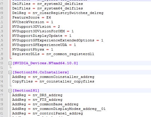

On 22/9/2016 at 2:11 PM, Tech Inferno Fan said:
Your startup.bat looks good.
Does the eGPU work with an external LCD?  If so, then it's a driver issue which will require:
1. Removal of all NVidia drivers
2. Installation of a recent NVidia driver  along with mods to enable Optimus:   https://www.techinferno.com/index.php?/forums/topic/10305-guide-how-to-get-nvidia-optimus-work-in-win10/
If you are still seeing a BSOD when attempting to initialize the eGPU in windows then you may have a power issue,  video card overclocked beyond ASIC capability, faulty video card or faulty eGPU adapter.
Okay, I removed previosly all drivers with DDU tool, but I didn´t mod the drivers, the guide is for win10, does it matter if im on 7?
Also I should use latest drivers desktop version right? Because there is notebook drivers for gtx 770 (yes, for gtx 770 not gtx 770m)
I will keep you updated
EDIT:
Found this:
Depending which OS you're using, the NVIDIA_Devices string will have either:
NTamd64.6.0 (Vista)
NTamd64.6.1 (Windows 7)
NTamd64.6.2 (Windows 8)
NTamd64.6.3 (Windows 8.1)
NTamd64.10.0 (Windows 10)
Edit: Actually long ago I tried to mod them but the  NVIDIA_Devices.NTamd64.10.0  entry in my file is empty.
Edited by Petrakis
