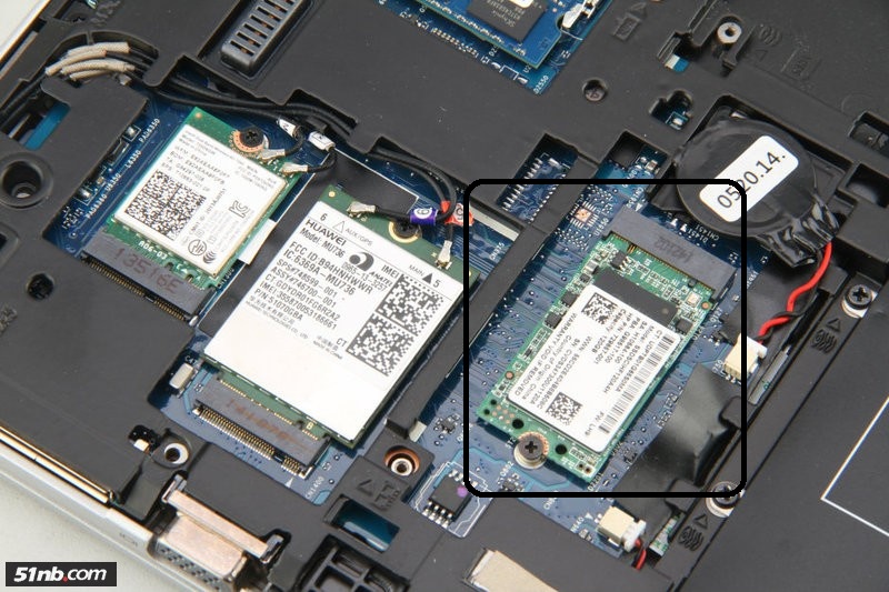

  8. Hello support. I wanted to order a ”PE4C 4.1 KEY M” for my laptop cause I don't want to remove the Wifi card. I removed the back cover and checked: I have an M.2 key M for SSD, Will it work? I read in other articles that there is a M.2 SATA and PCIE, I need the latter type for it to work!! I wasn’t able to find more info about it in the documentations, I have a Hp folio 9480M.
  9. it's not Key M . It's M.2 Key B i have the same one and no you don't put it upside-down. big mistake. In this picture you can see the Difference Between A-E(wifi left one) and B(WWan middle one) and M(SSD right one).
