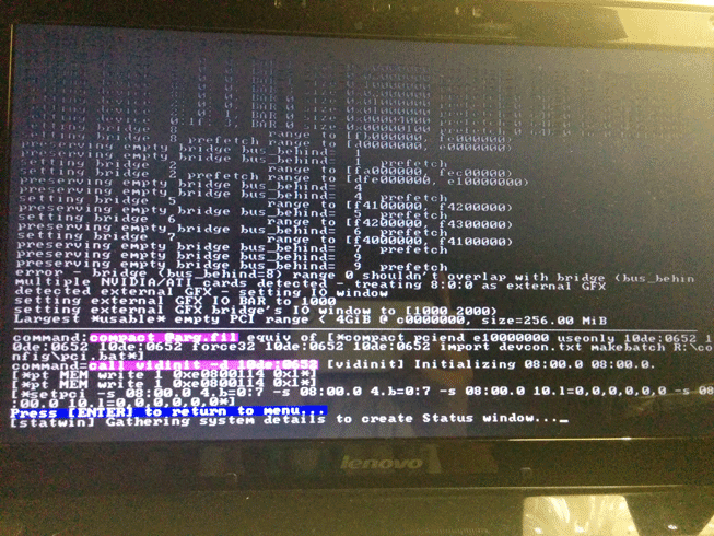

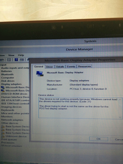

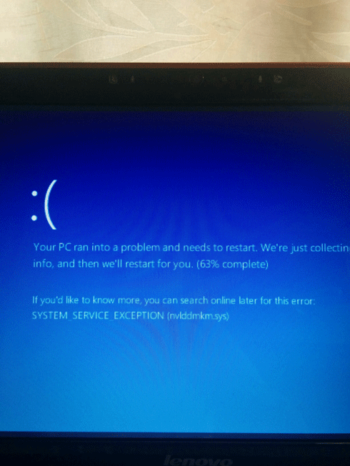

Hi Nando,
I have been struggling with these for days and so I give up figuring out on my own and seek your help.
My system is
 Lenovo Y450 GT130 version
 Win8.1
 Ram 6GB
 PE4L 2.1b
What I have done is DSDT Override (Large Memory)
The problem:
 1. When boot with EGPU attached, the system say Error 31. I guess its the driver false. So I install nvidia driver.
2. Then I boot it again with EGPU attached and the driver, it shows blue screen.
3. Maybe it because I didnt do the PCI compaction thing. So i tried and it didn't get pass to the windows. It endup with blackscreen with cursor.
 If I remember correctly If changes like
 demoted dgpu
 then run compaction
 it get stuck on gathering system detail
 and never finish.
I also attach the diag.zip
