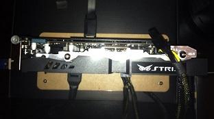

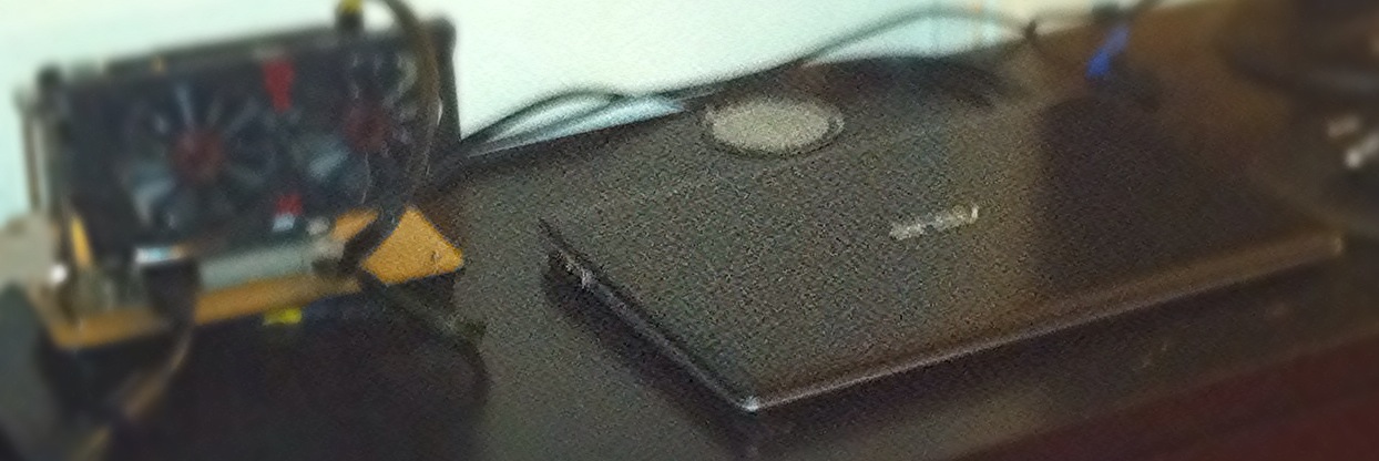

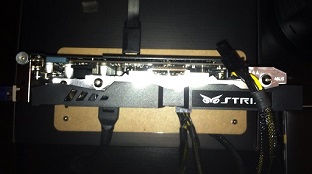

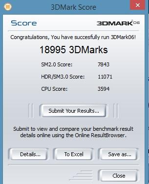

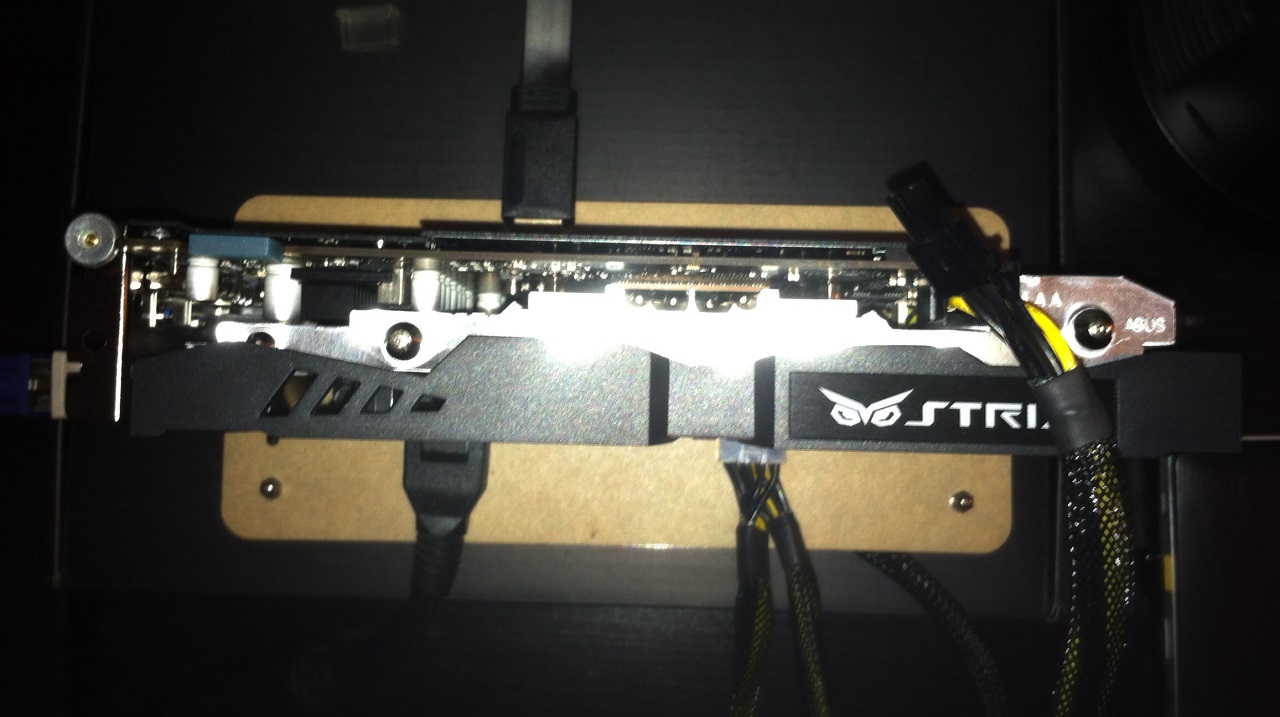

@Tech Inferno Fan Benchmark Results Ok here are the results from the 3DMark06 Benchmark: If you need the full Excel file I can send it too. Also, I will test 3dmark 11 and 13 and add those too. Additionally, here are pictures of the eGPU rig: Hope it looks good! Power supply brick is hidden, will post more pictures of it later! Thanks!
Thank you for the reply! I will release the benchmark results as soon as they finish downloading (My Wifi isn't too fast!). Also, normal GPU-Z and the Asus GPU Tweak GPU-Z say the link is x1 2.0, and doesn't mention anything about optimus, which I am pretty sure is faster, right? Additionally, I did the DSDT Override and because of that I am able to use my internal monitor with my iGPU, and my external monitor with my eGPU, and they both work at the same time. Both GPU's are detected and are working perfectly fine, and my external monitor is selected as the main, and I choose to have both displays extended. Will post results soon! Edit: Also will add pictures! Thanks!
