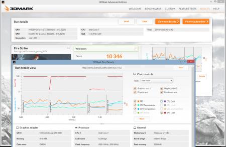

NVIDIA GeForce GTX 980M video card benchmark result - Intel Core i7-3940XM,Alienware M17xR4
Your dedicated 980m will probably get more performance as usual, but this seems to be the best in optimus so far for me.

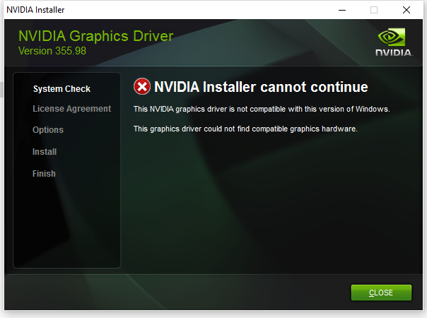

What trouble did you have installing drivers?
The thing is, that the latest inf files provided by j95 didn't contain anything other than hardware ID's. I compared his inf files line by line against the vanilla inf files in the official driver. I don't know if at some point he was modifying other stuff but I know for a fact that for optimus (I can't speak for the dedicated) the inf files are untouched, other than the addition of the hardware IDs.
Other than that I have just ordered the caddy and a 850 Evo 500GB. I missed the deal on the 2 TB. I did get a pretty sweet deal of 130 euros for the 500GB. That size should be more than enough for my needs anyways...
As for the drivers, the 980m would show up in device manager, get detected by GPUz, then suddenly, without restart, switch back to "basic display adapter". It drove me crazy and I actually thought I had a defective GPU... Formatting my hard drive and doing a clean installation of W8.1 allowed me to install the driver in 1 shot without a single issue. Just to clarify I had also done a clean install of W10 in UEFI prior to installing the 980m...

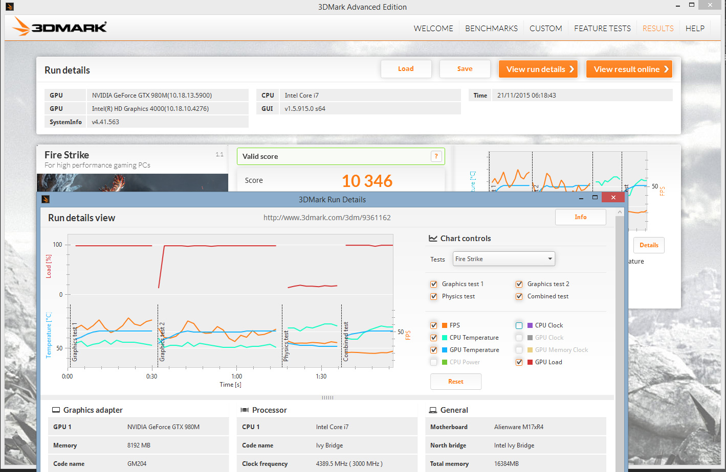

Hi again @J95 @theghosts,
Some news as promised on my M17xR4 + 970M + W10 + 352.84 mod. Sorry to have been so long before posting but here in France we were a little bit disturbed by sad events like you should know.
So... I started first some tests with my old 352.84 mod. I got very bad results when using OCCT & Valley. Indeed they were so bad (60 fps on OCCT 3D) that I suspected some issue regarding my PSU at parents home (I have another one at my student flat). A short check in the BIOS allowed me to see that I had disabled the PSU conformity check sometimes in the past - certainly during my full monty of the laptop almost 6 weeks ago. As soon as I enabled it again I got the famous message on boot regarding the non conformance of the PSU that "may not charge".
I decided to drop the battery and to run tests without it and BINGO I was able to get better performance: 130 fps on OCCT / 2026 pts on Valley / 6295 pts on Fire Strike.
These are quite honest figures - still in the low of the average I have seen for my CPU+GPU combo however.
I have to mention that I run that test without any OC of the CPU or GPU.
I checked the GPU Mhz during OCCT test and it was capped at 540 MHz even if the card is rated 924 MHz - so looking like a throttling (note: I have no issue of T°).
Then I tried to play with NVI in order to look into the p-states. The P1 was capped with a max at 540 Mhz that I changed for 1038 Mhz for a new OCCT run. Again during the test I got that cap at 540 Mhz but when the full charge of the GPU ended the frequency went up to 1038 Mhz (!). I am afraid I have some limit reached because of my parents' home PSU when the GPU is requesting power. Do you agree on this ? Am I misunderstanding something ?
NOTE: By the way the situation is not too bad - when I look at the Fire Strike scores of the non OC same configurations as mine (but the driver) I am only 10% below the best ones. What is quite funny is that these best scores are hit with using the 353.82 driver that is the one that W10 installs by default if you let the OS to choose. The even more funny thing is that 353.82 is even not said to be a 9xx driver but a Quadro one (I wrote more on this on NoteBook Review forum).
