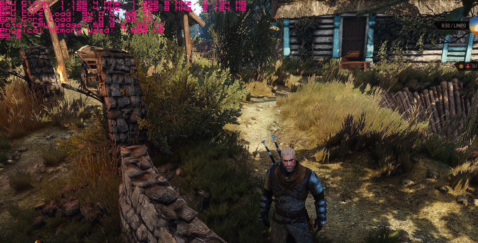

Tulius Posted October 24, 2015 Share Posted October 24, 2015 Second day testing 353.00 drivers and original Clevo VBIOS, no throttle yet, gaming with very graphic demanding games on ultra. I'm using Hwinfo64 on-screen info now instead of Msi Afterburner, GTX 980M SLI / P0 - P1 NV inspector switching core and Vram default values. I believe testing more 2 days I can give a true opinion about this driver. One thing I noticed is that sometimes GPU runs at normal core clock of 1038MHz insteady of 1127MHz boost in very demanding scenes, but thats not much a problem at all because almost gives no decrease in game FPS. Edit: Found that this behavior comes from Clevo BIOS, having nothing related about installed video drivers. Edit 2: Its confirmed, no throttling at all in the third day. a shame its coming for an old Nvidia driver 1 Quote Link to comment Share on other sites More sharing options...

Tulius Posted October 26, 2015 Share Posted October 26, 2015 Please test CLEVO_8GB_GTX980M_OC_PM_v1.1.1NV Inspector -> P0/P1 matching. GPU throttling w/ v1.1.1...then you will need to ask @Prema to link previous version 1.1 instead. Yes, it seems this driver is really throttle proof... two days gaming testing with Prema 1.1.1 BIOS, the AW PEG MOD 353.00 don't flinch a inch with sustained 1127Mhz GPU clocks (boost clock), it's a really nice fix indeed. Now if just the newer drivers could be this good... Batman Arkhan Knight will be back in Steam Store in 10/28. But anyway thanks J95 for this perfect driver fix for 980M, I'll be using for my default video drivers from now on while testing new ones too. 1 Quote Link to comment Share on other sites More sharing options...
J95 Posted October 27, 2015 Author Share Posted October 27, 2015 Yes, it seems this driver is really throttle proof... two days gaming testing with Prema 1.1.1 BIOS, the AW PEG MOD 353.00 don't flinch a inch with sustained 1127Mhz GPU clocks (boost clock), it's a really nice fix indeed. Now if just the newer drivers could be this good... Batman Arkhan Knight will be back in Steam Store in 10/28. But anyway thanks J95 for this perfect driver fix for 980M, I'll be using for my default video drivers from now on while testing new ones too. No problem, Batman AK or other games requesting latest drivers is not an issue anymore...trick... This will keep your 980Ms both Throttle proof and updated, until the vBIOS fix is released. 2 Quote Link to comment Share on other sites More sharing options...

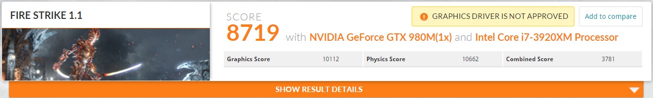

ShatteredX Posted November 1, 2015 Share Posted November 1, 2015 Hi all, just a quick note: Finally installed the 353.00 PEG MOD drivers by J95 for my 980M. After a couple quick tests, I have no throttling at all at stock clocks even with Azalia Enabled! See below for stock Firestrike score: Very satisfied to have no throttling even at stock clocks with Azalia enabled. I'll try some overclocking again soon. Many thanks to J95, Prema and others for their amazing work! 1 Quote Link to comment Share on other sites More sharing options...
Tulius Posted November 2, 2015 Share Posted November 2, 2015 Interesting, I disabled the SLI to see if my scores are consistent with yours and indeed is(stock gpu clocks): 1 Quote Link to comment Share on other sites More sharing options...
