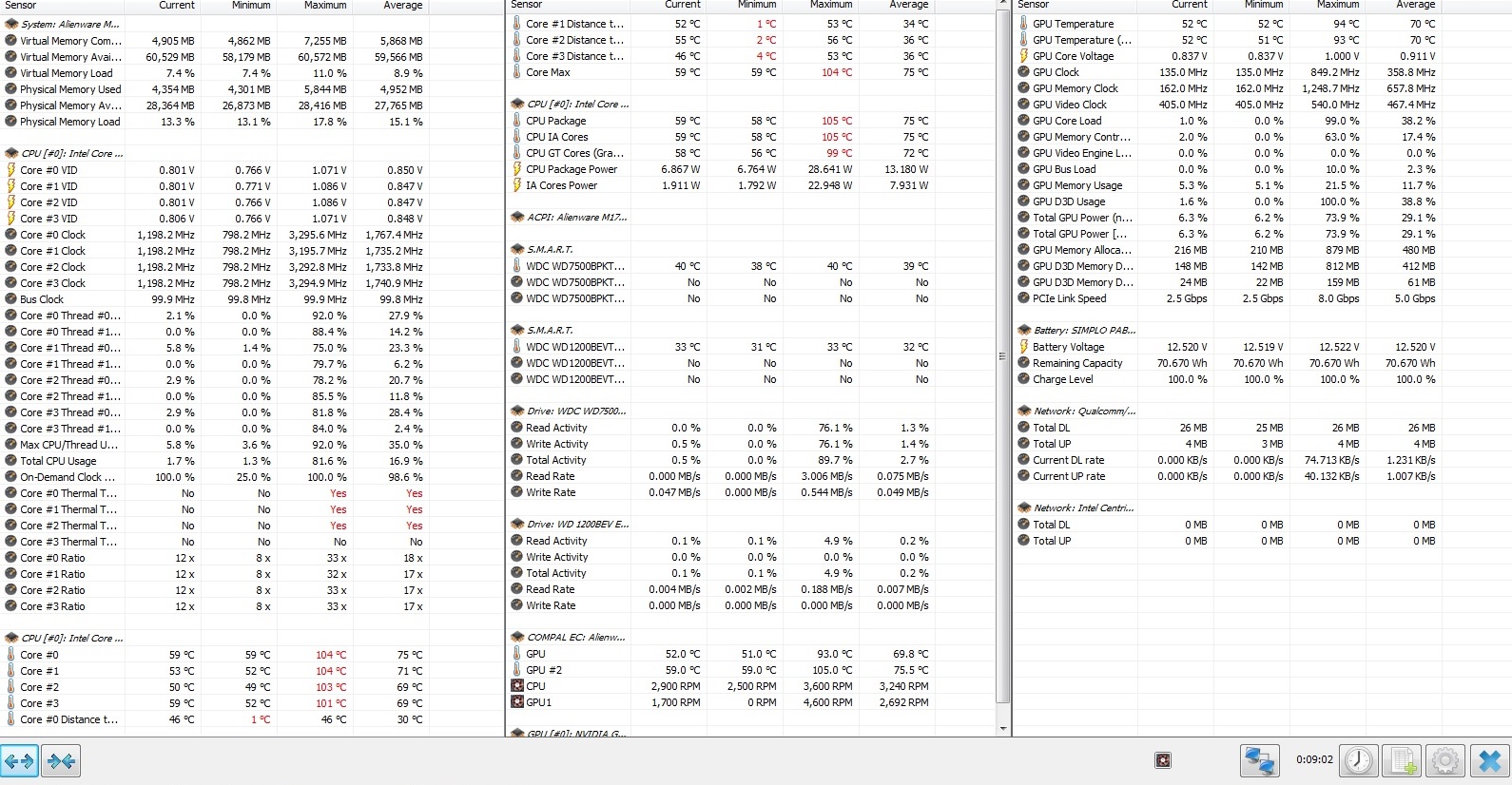

TomJGX Posted October 4, 2015 Share Posted October 4, 2015 Right... is possible share your overclock? i try here, my best fps min is 11 and max 70 in moment =/ ... hard man rsFergus, before you do any overclock, wtf are your temps in game? I have a feeling with all the variation in fps you are overheating.. Download HWinfo64 and let us know your max GPU and CPU temps while playing some game..Sent from my LG-H811 using Tapatalk Quote Link to comment Share on other sites More sharing options...

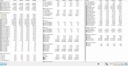

Fergus Posted October 4, 2015 Share Posted October 4, 2015 Fergus, before you do any overclock, wtf are your temps in game? I have a feeling with all the variation in fps you are overheating.. Download HWinfo64 and let us know your max GPU and CPU temps while playing some game..Sent from my LG-H811 using Tapatalk Hi TomJGX!, The following image my machine without overclocking playing for 5m borderland2 in ultra ... I know there's something wrong but do not know how to solve = ( Overclocked can maintain 65C, yet falls too FPS from 60 to 10fps ... I'm running out of ideas how to solve ... Quote Link to comment Share on other sites More sharing options...
TomJGX Posted October 4, 2015 Share Posted October 4, 2015 Hi TomJGX!, The following image my machine without overclocking playing for 5m borderland2 in ultra ... I know there's something wrong but do not know how to solve = ([ATTACH=CONFIG]16177[/ATTACH]Overclocked can maintain 65C, yet falls too FPS from 60 to 10fps ... I'm running out of ideas how to solve ...According to the images, CPU is throttling due to high temps and so is the GPU... 90C++ isn't safe.. I would firstly stop overclocking..2nd thing to do is remove the bottom cover, clean fans and remove dust and then repaste your GPU and CPU with some good thermal paste... Use something like IC Diamond or Gelid GC Extreme...I wouldn't overclock your GPU, you will burn it out... Prop up the back of your laptop with some books or something as a temporary solution but do the repaste...Sent from my LG-H811 using Tapatalk Quote Link to comment Share on other sites More sharing options...
Fergus Posted October 4, 2015 Share Posted October 4, 2015 According to the images, CPU is throttling due to high temps and so is the GPU... 90C++ isn't safe.. I would firstly stop overclocking..2nd thing to do is remove the bottom cover, clean fans and remove dust and then repaste your GPU and CPU with some good thermal paste... Use something like IC Diamond or Gelid GC Extreme...I wouldn't overclock your GPU, you will burn it out... Prop up the back of your laptop with some books or something as a temporary solution but do the repaste...Sent from my LG-H811 using TapatalkThanks for the quick response, good, come on ...This print was using the machine normally without using overclocking, but I'm already using it open at the bottom with a 20.000RPM cooler focused on the GPU, reducing at least 10C ... I ordered to Article 5 silver for maintenance ... I'm using the wrong note in time to avoid damage.I've done all the cleaning, lacking only the folder ... only think that would solve the heating problem and fall of FPS? I have done almost everything ... Quote Link to comment Share on other sites More sharing options...
TomJGX Posted October 4, 2015 Share Posted October 4, 2015 Thanks for the quick response, good, come on ...This print was using the machine normally without using overclocking, but I'm already using it open at the bottom with a 20.000RPM cooler focused on the GPU, reducing at least 10C ... I ordered to Article 5 silver for maintenance ... I'm using the wrong note in time to avoid damage.I've done all the cleaning, lacking only the folder ... only think that would solve the heating problem and fall of FPS? I have done almost everything ...The temps are too high.. Arctic silver 5 is old and junk nowadays... What other pastes can you get?Sent from my LG-H811 using Tapatalk Quote Link to comment Share on other sites More sharing options...
