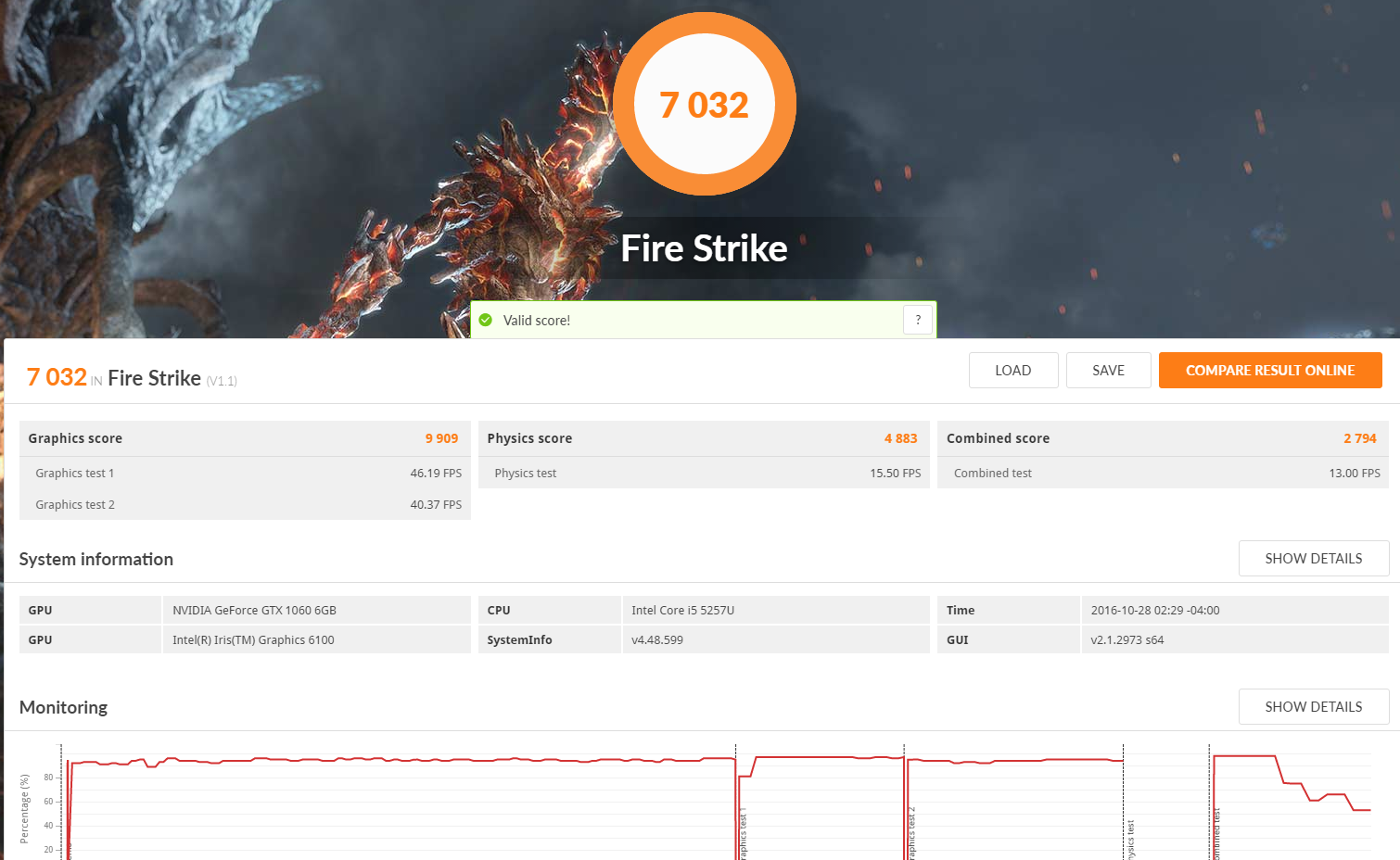

EdowadoHense Posted October 31, 2016 Author Share Posted October 31, 2016 6 minutes ago, ~ h@PpY nO08~ said: Thanks for sharing. I got a similar setup: Zotac GTX1060 Mini 3GB + Akitio + 2014 11" Macbook Air (TB1) + Win10, did you do any 3D benchmark on your setup? Btw, your should be TB2 instead of TB1 right? Yes, the attachment is my 3Dmark benchmark. 1 Quote Link to comment Share on other sites More sharing options...

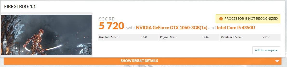

~ h@PpY nO08~ Posted November 2, 2016 Share Posted November 2, 2016 On 10/31/2016 at 4:40 PM, EdowadoHense said: Yes, the attachment is my 3Dmark benchmark. Thanks for sharing.....My score is 5720 as attached, noticed that the Graphics score is not significant increased with TB2 ..... 1 Quote Link to comment Share on other sites More sharing options...
EdowadoHense Posted November 2, 2016 Author Share Posted November 2, 2016 yea. it is slightly different.it is slightly different. It is slightly different. I usually get 9400~9900 for graphic score. Btw, my gtx 1060 is overclock. I think TB1 and TB2 perform the same result. Quote Link to comment Share on other sites More sharing options...

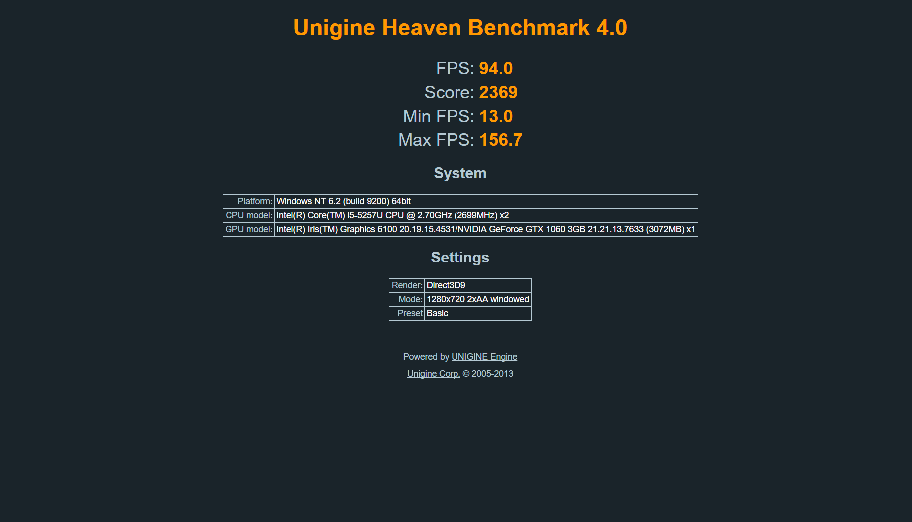

honzicek69 Posted December 27, 2016 Share Posted December 27, 2016 (edited) Hi, i have a setup EVGA 1060 3GB SC + 2015 13" Macbook pro + Win10 (1607) over EFI USB (https://bleeptobleep.blogspot.cz/2013/02/mac-install-windows-7-or-8-on-external.html) I can install drivers 376.33 without issue. But it works only after first reboot after instalation. Getting some error when launching any game or application about DX. Since then im getting the wheel or even the blackscreen. Can somebody advice? Edit: It somehow works just right after installation of drivers. But can't get it run after reboot again (requires driver reinstall again). Using the DDU tool to remove the drivers and then install them as new again INternal screen benchmark Edited December 27, 2016 by honzicek69 Quote Link to comment Share on other sites More sharing options...
