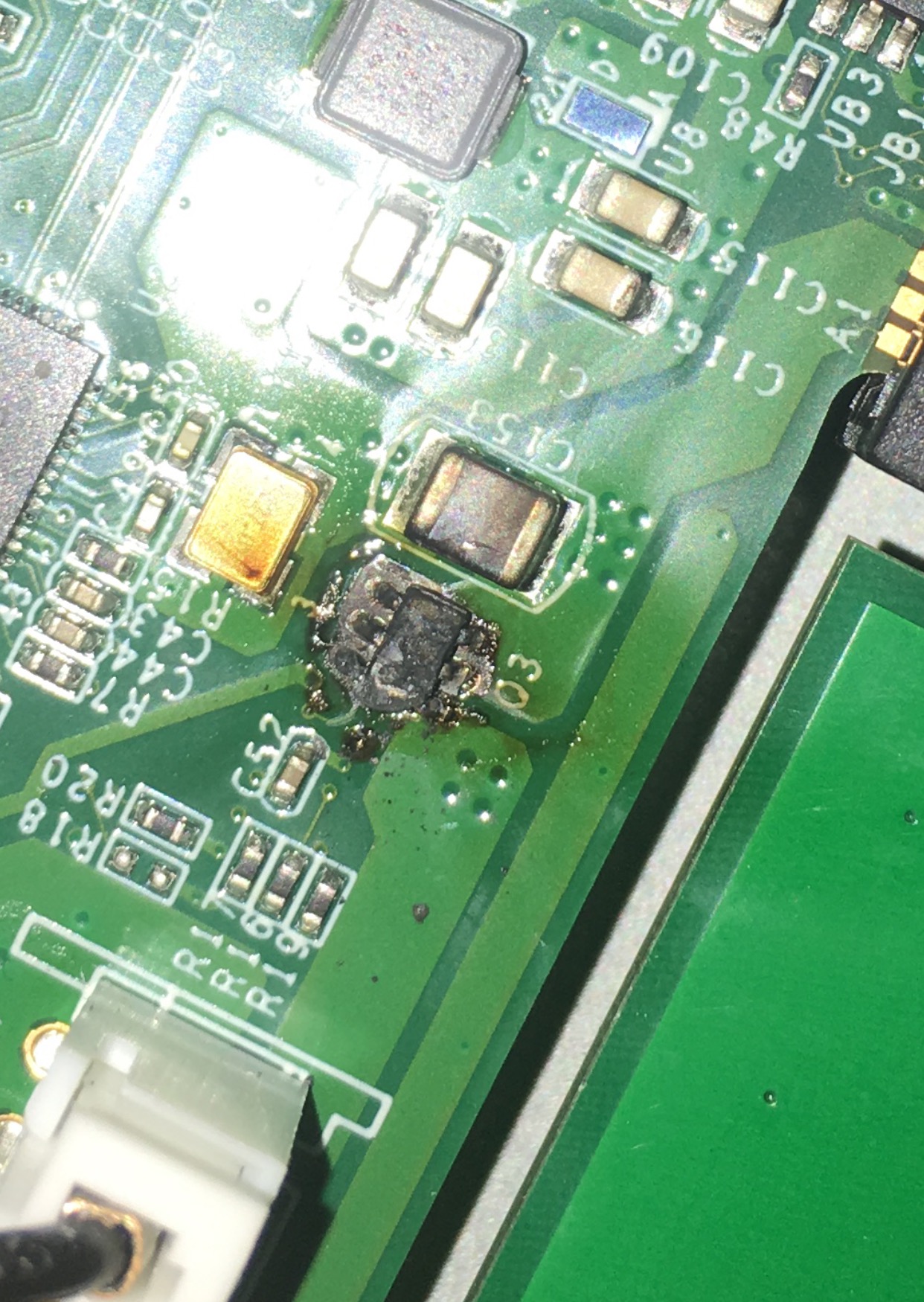

  1. Just want to post an update: i was able to use my akitio box by using a PCI E Riser with molex+ barrel to the akitio board so i have two power powering the whole thing from 1 PSU. And everything works back to normal. For anyone having this issue you can use my trick
  2. Hey i just fried my Akitio thunder 2 box. My mac cant detect the gpu but detect the box. anybody has experience this and has some workaroung? rma is not posibble because it is too expensive to ship it(200 usd)
