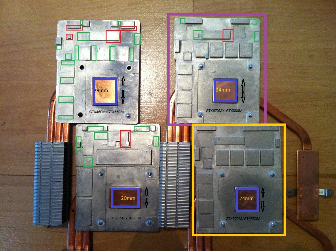

Hello At first You need some Eyeglasses,the GTX 680M looks different.:-) In the Picture You can see the different Heatsinks for Nvidia Cards. The Price for the Card is to high,for this Price You can find sometimes cheap GTX970M. in Your GT70 You can use every NVIDIA Card up to GTX 1060. But for the different GPU Generation You need also different Heatsinks or modified Heatsinks. Upgrading with the right Heatsink is normally very easy,if the Card is not from MSI You must Flash the MSI Vbios.
