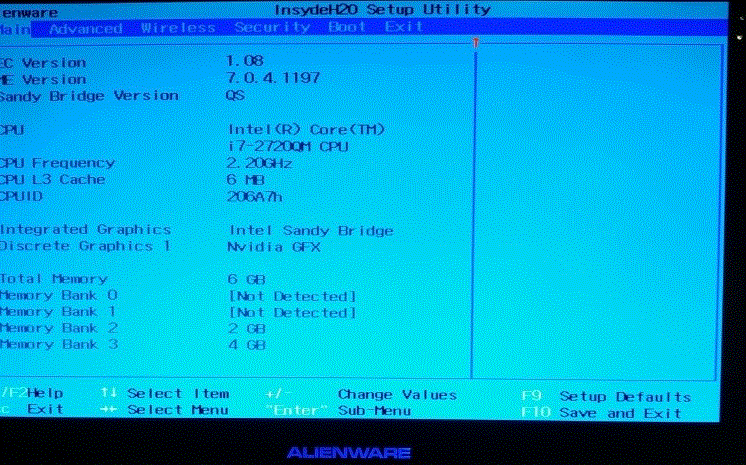

@KlemI just tried removing all the RAM and powering on the laptop, then powering it off, and then inserted a new RAM module of a different size to all of them, and I'm still just getting the beeps on startup. :/
EDIT: Just removed the coin cell battery having removed all the RAM and the battery, and have managed to boot successfully!
Edited by Papuang
Hello everyone,
My Alienware m17xR4 has official A13 bios. After the update i noticed that my laptop has slowed down by A LOT. And then i noticed that once i load my cpu fully the clock speeds go to 2.2 Ghz. Right now all i can do is use software like Throttle stop to increase my cpu freaquency by increasing current limit (changing multipliers does nothing in bios) and that software is annoying because once the update is released you are forced to update and once you do all your settings are gone and you have to do everything from start...
My question is if i were to install unlocked bios could i make such changes in the bios without having to rely on software ?
