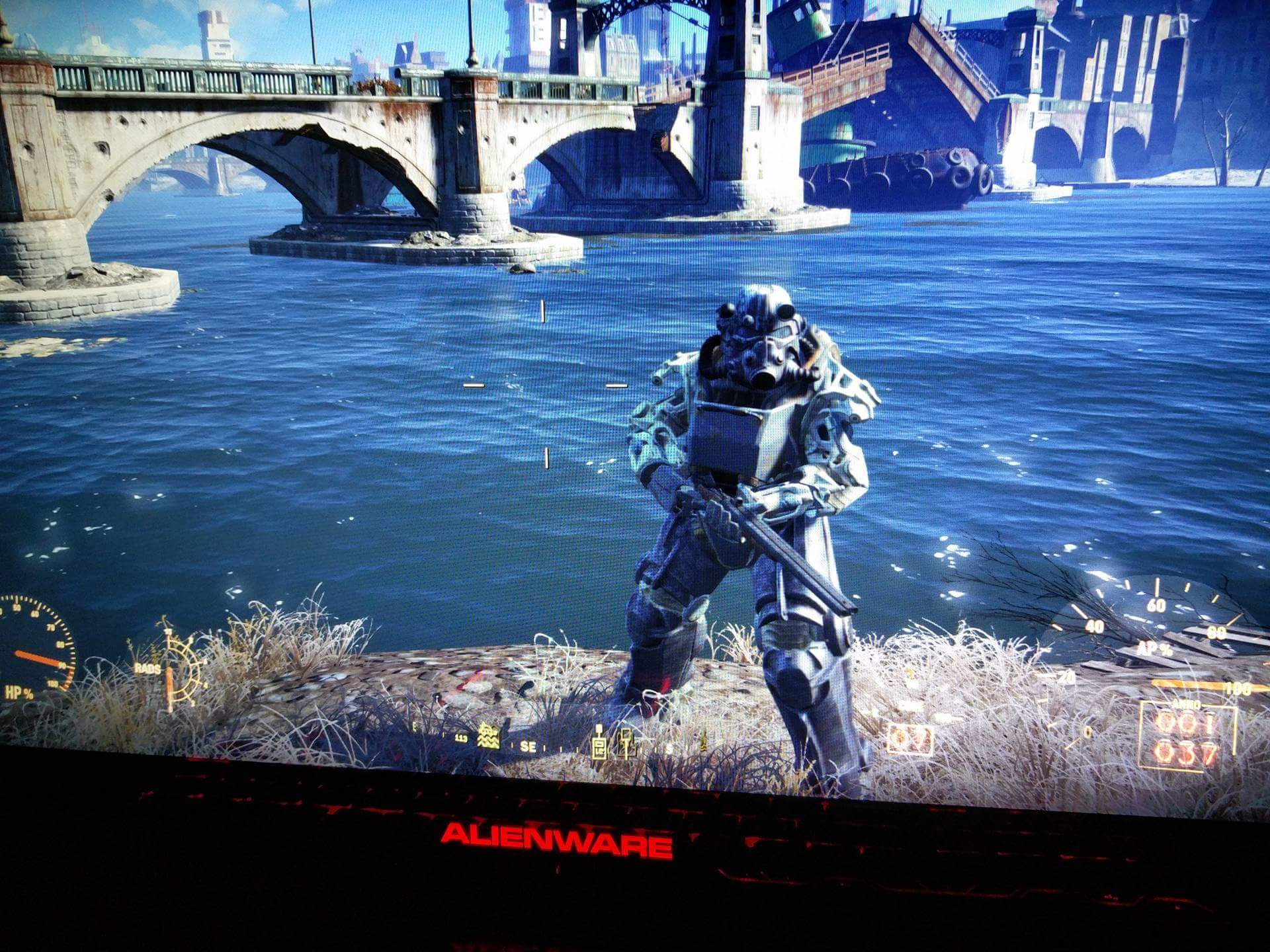

So finally got my 980m in today and install was a breeze I've been fighting this 780m and turned out to be something wrong with the card. I'm now running the 980m on the 120hz screen it looks great ! 3940xm with m14 r2 fan modified to fit only had to remove one tab and slightly modify the other two flows great. If anyone needs help let me know.
The only wierd problem I have is fallout 4 is stuck at 30fps and on the 60hz was 60fps so not sure what's going on but I'll figure it out.
