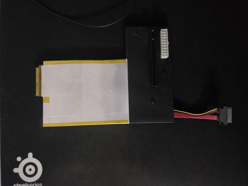

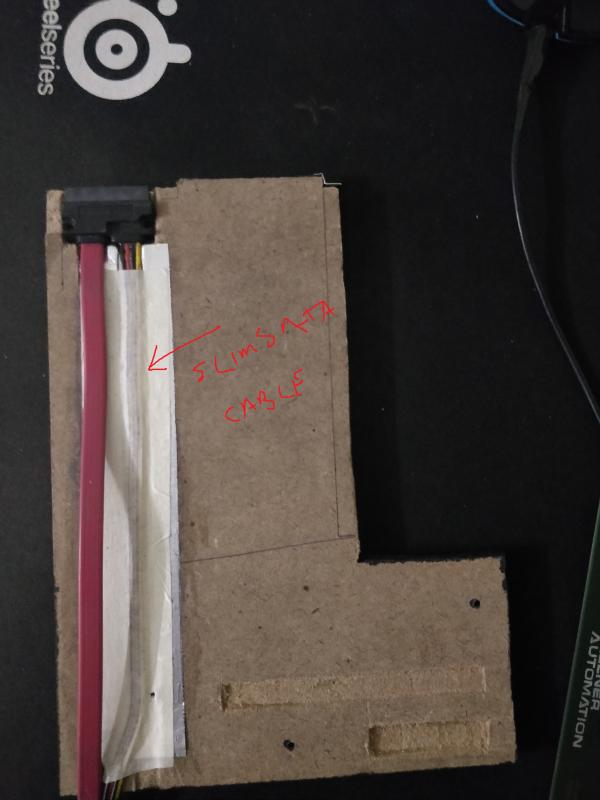

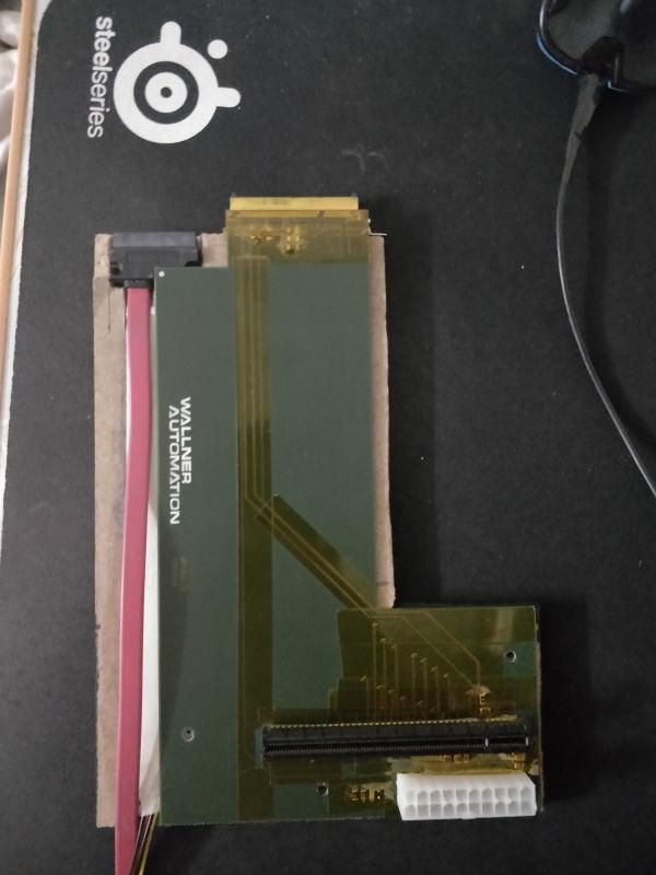

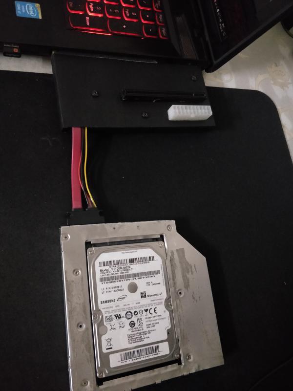

Hello.
I assume you have a HDD caddy to use additional HDD in the ultrabay port (not the ultrabay HDD that lenovo advertised but never sold?).
I use a HDD caddy myself and used to be in the same situation as you where I wanted to be able to use HDD with or without eGPU and to be able to go mobile quickly whenever needed. Hence I thought of a solution.
I bought a simple SlimSATA cable and created a enclosure for both slimsata and the ultrabay adapter (I have gerald's final design ultrabay adapter). SlimSATA is the port where the HDD is connected to with HDD caddy.
You can see that the HDD Caddy is attached to laptop through ultrabay as is, meaning, if I wanted to go mobile all I have to do is:
1. remove ultrabay adapter from laptop
2. remove HDD Caddy from ultrabay adapter
3. Insert HDD Caddy to ultrabay slot in the laptop and that's it.
Doens't matter which design of ultrabay you get you can modify it to something like explained above. All you'll need is some sata/slimsata cable.
I hope that is what you wanted to know!
EDIT: I forgot to mention that this is not the final iteration of the modification I made. I moved the cable to the back side so that I can put the HDD Caddy behind the laptop and it would'nt get in way while I use my mouse :D
