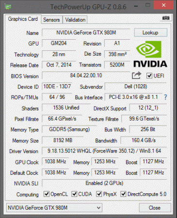

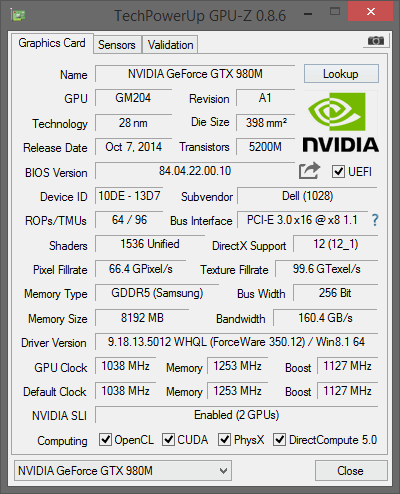

This is a SS of my current setup for my graphic cards atm as im not sure which bios file is the correct one to flash. Setup is a M18Xr2 on the A12 Bios with Dual GTX980M's. Anyone know which would be the best file to use dont wanna pick the wrong one and brick it accidentally.
You can either use the AW18 version or the Clevo Mod...just stay away from 361 driver as it crashes, freezes on far too many systems...

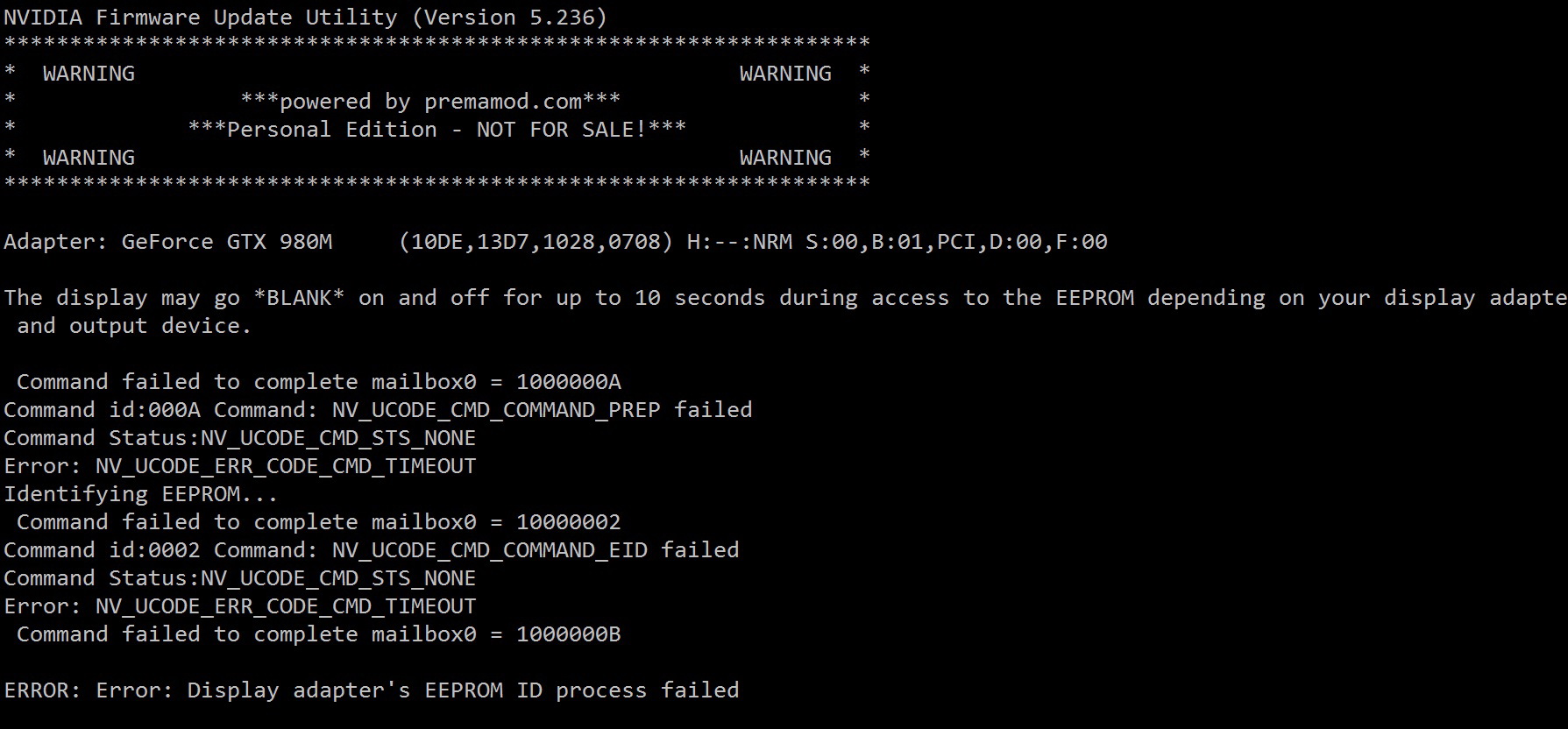

Hi, Prema) Could you please tell what does this mean? Tnx
