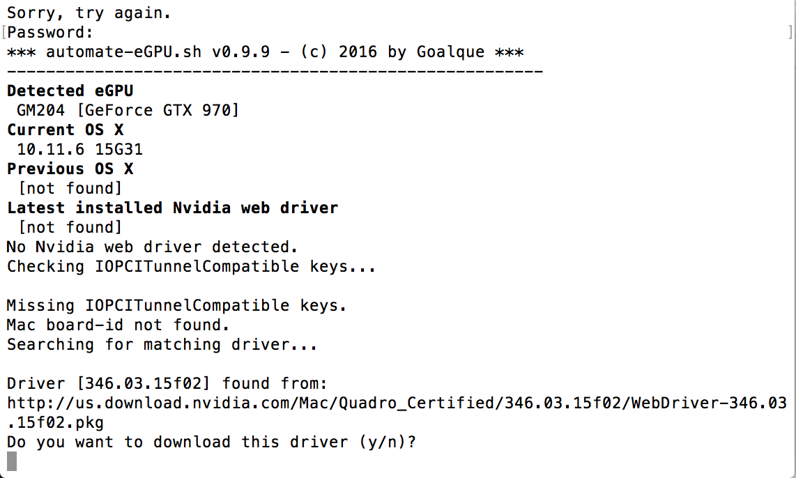

w4vz Posted December 8, 2016 Share Posted December 8, 2016 OMG I learnt something !!!!! got my egpu working by forcing the script to install from url for anyone just append -url and paste the url to the previous driver good day 1 Quote Link to comment Share on other sites More sharing options...
Uhlhorn Posted December 8, 2016 Share Posted December 8, 2016 44 minutes ago, w4vz said: for anyone just append -url and paste the url to the previous driver Can You give me an example please? And thank You for Your explanations. Quote Link to comment Share on other sites More sharing options...
Halbertus Posted December 8, 2016 Share Posted December 8, 2016 (edited) Hey Uhlhorn, I think the following line is what w4vz was trying to say: sudo ./automate-eGPU.sh -url http://de.download.nvidia.com/Mac/Quadro_Certified/367.15.10.15f03/WebDriver-367.15.10.15f03.pkg (This is assuming you are running Sierra 10.12.1 Build: 16B2659 Edited December 8, 2016 by Halbertus syntax mistake Quote Link to comment Share on other sites More sharing options...
w4vz Posted December 8, 2016 Share Posted December 8, 2016 1 hour ago, Uhlhorn said: Can You give me an example please? And thank You for Your explanations. automate-eGPU.sh -url http://www Quote Link to comment Share on other sites More sharing options...
Uhlhorn Posted December 8, 2016 Share Posted December 8, 2016 Thank You. And where can I find the correct URL? Quote Link to comment Share on other sites More sharing options...
Uhlhorn Posted December 8, 2016 Share Posted December 8, 2016 Is the URL something like this? http://us.download.nvidia.com/Mac/Quadro_Certified/367.15.10.15f03/WebDriver-367.15.10.15f03.pkg Quote Link to comment Share on other sites More sharing options...
Uhlhorn Posted December 8, 2016 Share Posted December 8, 2016 (edited) This was working for me (with a GTX 980Ti): sudo ./automate-eGPU.sh -url http://us.download.nvidia.com/Mac/Quadro_Certified/367.15.10.15f03/WebDriver-367.15.10.15f03.pkg Thank You!!! :-) Edited December 8, 2016 by Uhlhorn 2 Quote Link to comment Share on other sites More sharing options...

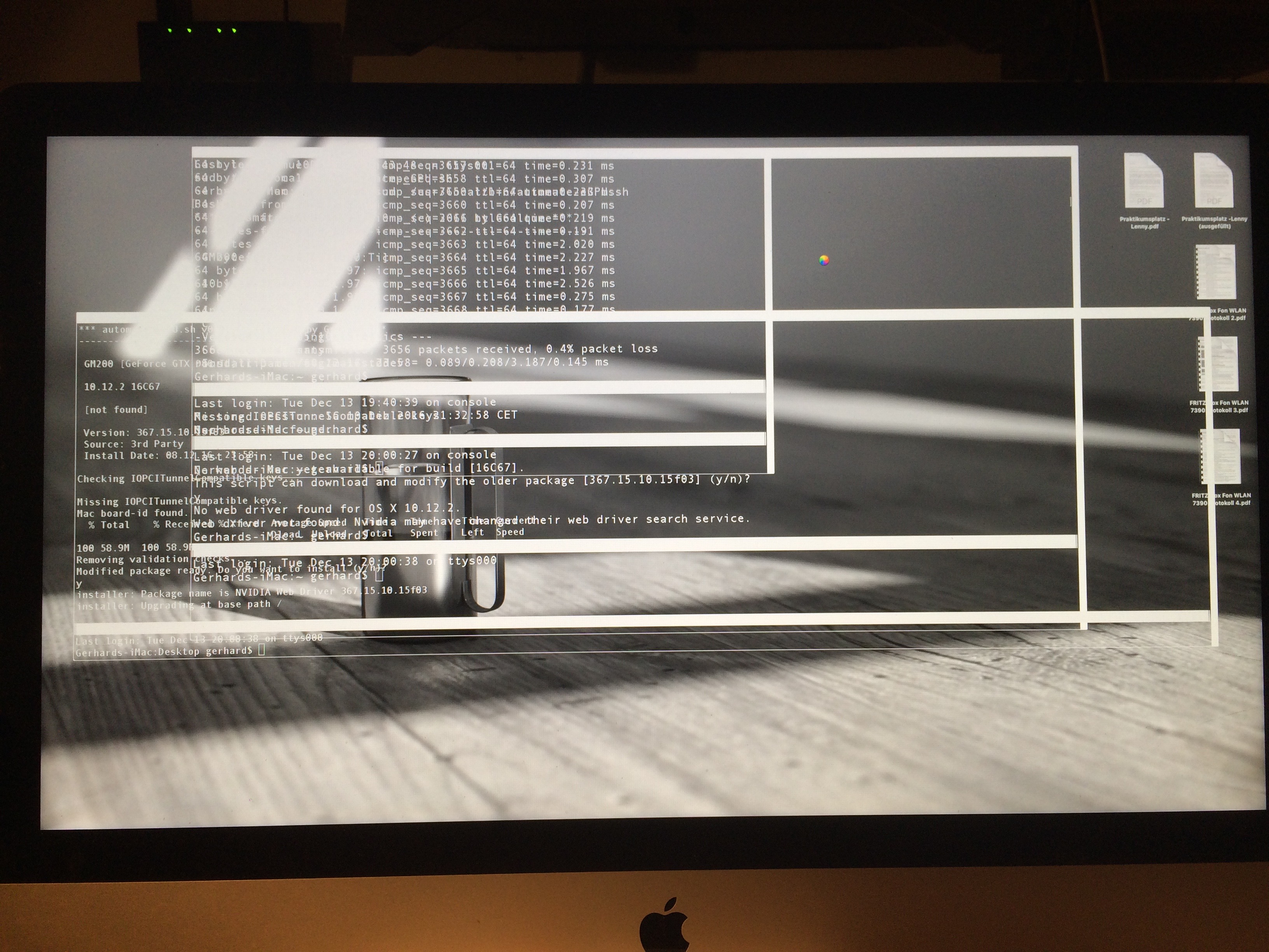

Uhlhorn Posted December 13, 2016 Share Posted December 13, 2016 (edited) After the update from today macOS Sierra 10.12.2 (16C67) the script does not find a driver again. (This is Nvidia’s fault.) So I installed the driver like in the previous post, but after this my Mac was not able to run with it. The screen was grey (without colors) and was not working correctly. Now I deinstalled the driver and can not use the eGPU for rendering. :-( Edited December 13, 2016 by Uhlhorn Quote Link to comment Share on other sites More sharing options...
