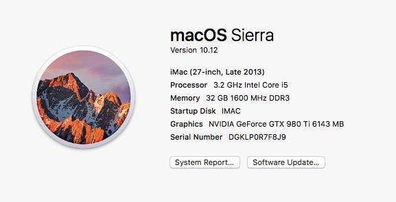

  1. Did you get it working?? I have a similar setup to you and mine is all working fine with Adobe Premier on Sierra with my 980 ti
  2. It seems there is some confusion here. I am using the same type of setup and its work fine with sierra os with all Adobe apps. I just plugged my external cinema display into the gtx 980 ti and now it uses that card as the primary card no probs!! Did you guys all try that? It work fine with Premier Pro for me. My setup IMAC 2013 I5 3.2ghz GTX 980ti Akitio PCI 32gb ram Sierra Premier Pro = Working fine
