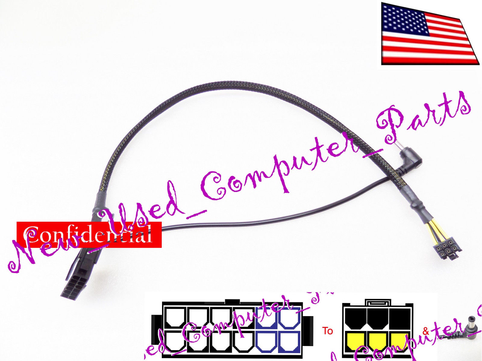

Yours is definately different from mine (which is good news for you, I guess). Also comparing to the diagram in the opening post of this thread it seems correct to me. But I got only limited knowledge in this field, thats why I was opting for a ready made solution in the first place. I'ts noticeable we both bought our adapters from the same eBay seller. Maybe he has gotten something wrong? I had a nice email conversation with him and he is now sending me another adapter with different layout. Shipping to Germany might take a while though. Once I receive my unit I will gladly report whether it might be different again from you adapter. Maybe one of the more experienced members can provide more feedback for you in the meanwhile -

The LED on your DELL-DA-2 turning orange is normal behaviour. Could you perhaps provide a picture of the adapter you purchased from eBay? -

Thanks for your feedback and for offering your support! Unfortunately I was not able to find a GTX 970 that I had reliable information would work with my Dell UP2715K@5K@60Hz. So I needed to go GTX 980. I found a great deal for an open box EVGA GTX 980 on Black Friday, so I ordered that. (for reference: https://www.amazon.de/gp/product/B00O3JZAYA/ref=oh_aui_detailpage_o00_s00?ie=UTF8&psc=1) Thanks for the Info. I will not overclock the graphics card. It is only being used for video production, memory bandwidth is important in that case and I guess the GTX 980 220GB/s should be sufficient for quite some time. In the meanwhile I got my custom cable (shipping from North Carolina, USA) and the Dell DA-2 power supply. Unfortunately the colours of the wiring (black/yellow) / the placement of the paperclip seems to differ from the diagrams that can be found in the beginning of this thread. There is few different ways on how I could connect the adapter cable to the PSU. None of both variants is identical to the image in post #1 Would this still work? Am I missing something? Or is the adapter soldered incorrectly? UPDATE: I contacted the eBay seller, he told me I got a wrong cable indeed. Variant 1: Variant 2: -

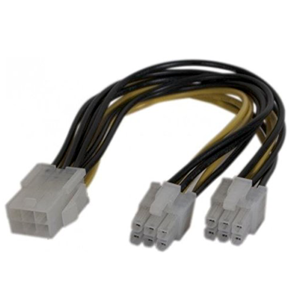

So, after reading about your builds on this forum a few weeks I finally decided to build an eGPU for myself to improve performance in video editing software. I got an Akitio Thunder 2 and a DELL DA-2 Power supply that i would use to drive an nVidia GTX 970. As i am not really into physics and tools I ordered a cable solution from eBay: Unfortunately I cannot find a GTX 970 that is capable of connecting my Dual Cable Monitor, which requires 2x miniDisplayPort (Dell UP 2715K) So I had to change my mind and would now like to use a GTX 980. This card however requires 2 X 6-Pin Connections for power. As shipping costs to Germany for the above cable solution have been quite expensive I was wondering whether I could still use that cable and add something like a 1x6-Pin to 2x6-Pin Adapter like one can be found on Amazon: While not that aesthetically pleasing this could be an affordable solution. Do you think this would work? Or would this cause any (risk of) damage? Thanks!
