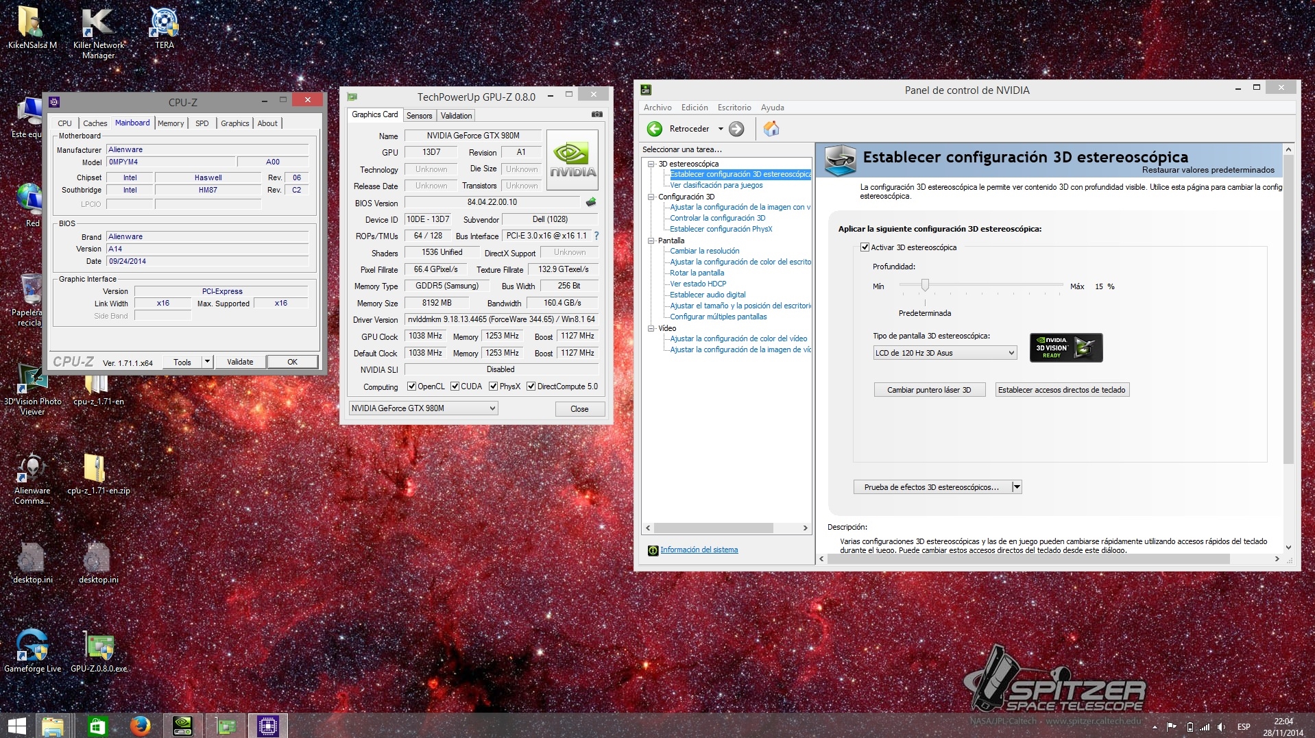

Quark Posted November 28, 2014 Share Posted November 28, 2014 People, I did test 3D by mini displayport and is fully working, I'll put a snap later Quote Link to comment Share on other sites More sharing options...

Quark Posted November 28, 2014 Share Posted November 28, 2014 svl7 could you upload your 344.75 drivers and share them with us? - - - Updated - - - As I promised... 3D working Quote Link to comment Share on other sites More sharing options...
