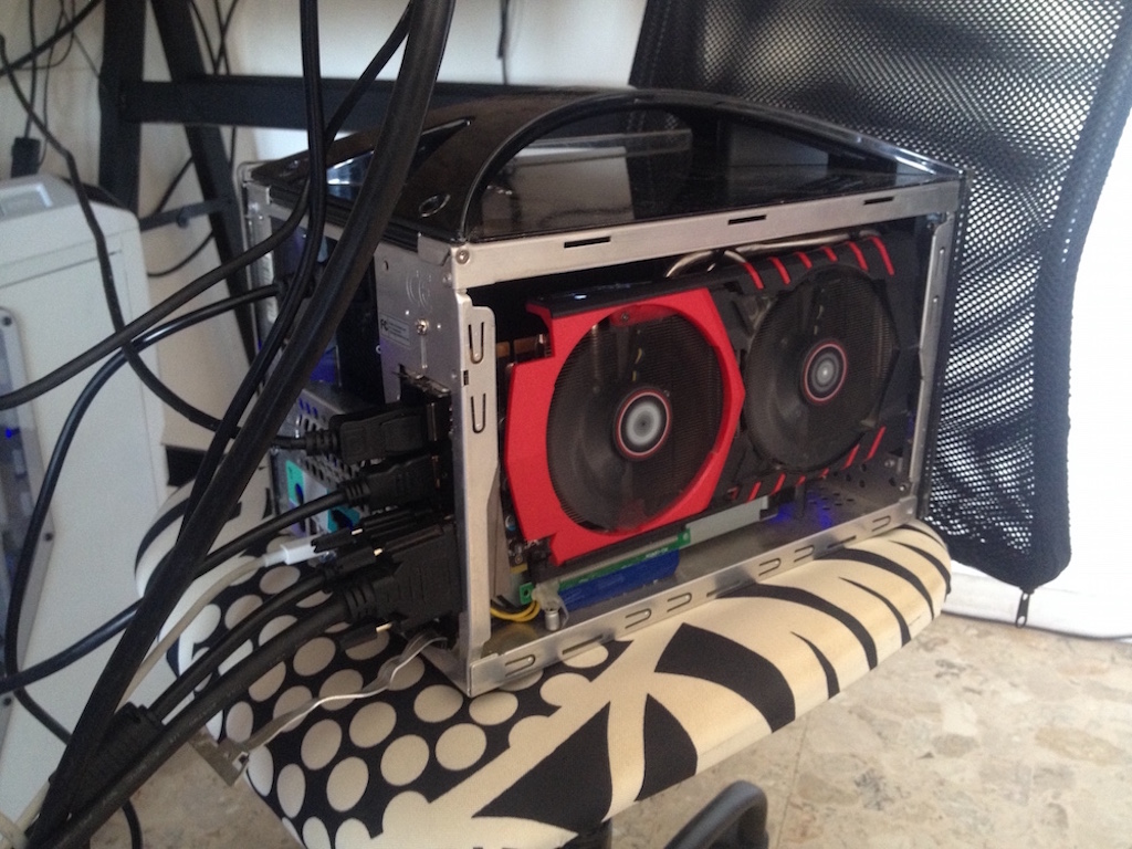

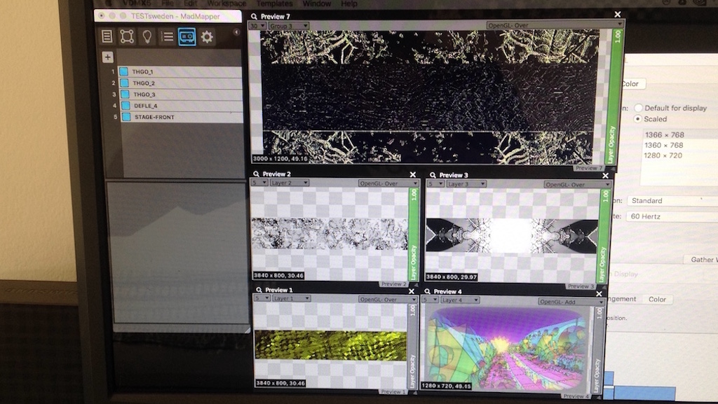

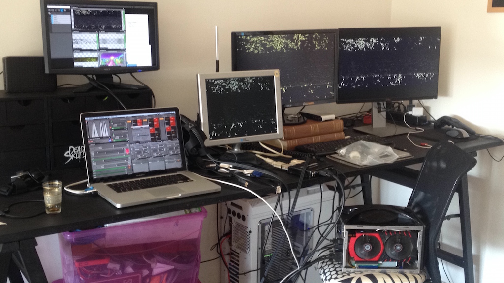

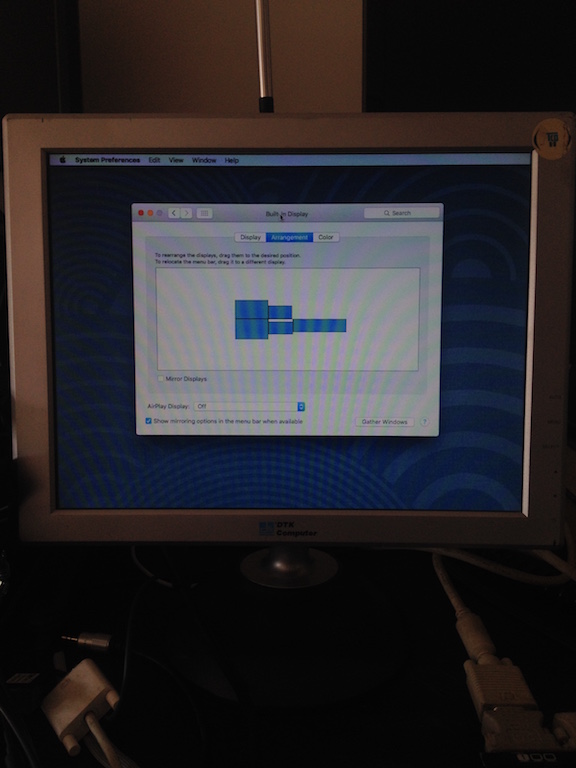

Hi everyone,
just wanted to share my experience with my e-GPU rig: a Portable MEDIA-SERVER for VJING and VIDEOMAPPING.. which is going great!
I'm running my visuals at 50-60fps constant with 4 layers of Full HD contents and one layer with a heavy ISF SHADER (GLSL for VDMX),
with lot of very heavy video filters and effects (all ISF and running on GPU),
outputting to 7 monitors with different resolutions (and each with different images):
A-laptop monitor (used only for the softwares controls and NOT for any video preview - it will slow down completely the machine)
B-external preview monitor (acer 1366x768 res)
C-3 outputs of 1024x768 from DVI-D to Matrox TripleHead2go
(in the picts outputting only to 1 monitor but is effectively outputting out all the 3 DVI ports - sorry didn't have enough monitors in the house!)
D-external monitor 1 (1920x1080)
E-external monitor 2 (1920x1200)
HARDWARE:
-MBP Late 2011, 16GB RAM, 256 SSD and 500GB HHD storage;
-Akitio Thunderbolt 2 PCIe + PCIE 16x16 Extender (powered);
-MSI GTX 970 (bypassed the voltage control of the fans straight to the PSU to be always at max speed);
-Cooler Master 500w PSU;
-used small PC box (un-named);
SOFTWARE (running)
-OSX El Capitan;
-VDMX (syphoning to Madmapper)
-MadMapper;
TO NOTICE:
-i've tested the e-GPU with newer Retina MBP from 2013 and 15 and they don't work as good, actually running faster with their own built-in graphic cards;
-i've daisy-chained an Elgato Thunderbolt dock with an external SSD USB 3.0 drive and it was working still fine (when reading videoclips form it was only dropping a few frames);
-daisy chained a BlackMagic Ultra-studio mini Recorder with 1920x1080 HDMI signal in to capture another video signal and was working still fine, but dropping more frames as
heavier the patch of VDMX and Madmapper is. For less stressing patches and setups i believe can run fine.
hope it helps,
Federico
www.deltaprocess.it

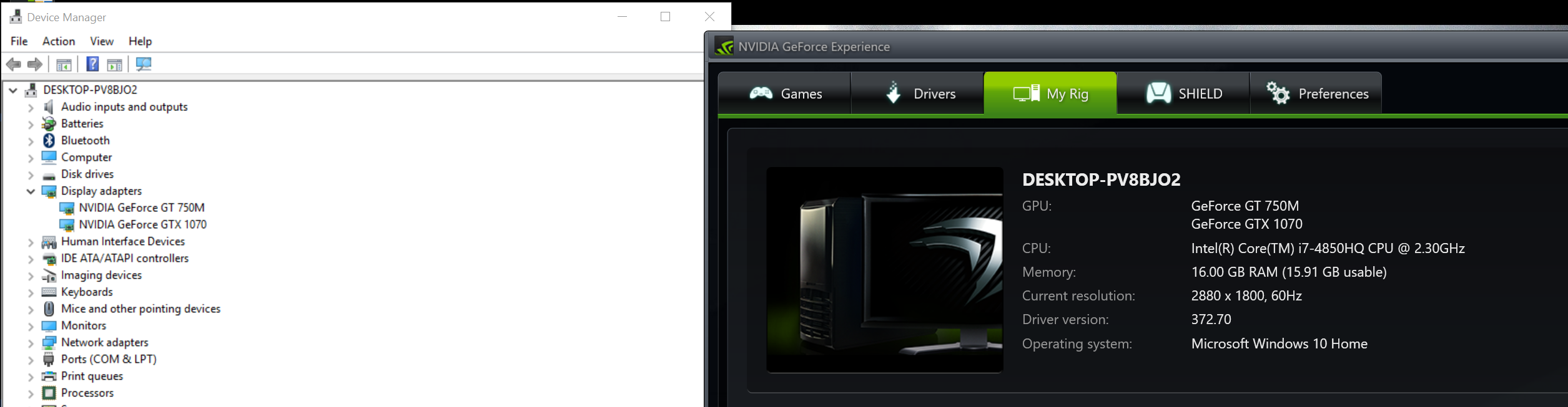

23 hours ago, CodeSix said:
After installing NVidia 372.70 driver and disabled 750M from device manager, enable Intel Iris Pro using rEFInd, it finally works now, also the eGPU is working on internal rMBP monitor (i guess), 3dmark gets a score of 4038, thanks everyone for the help!  But the funny thing is that even I have disabled the 750M, it is still visible to 3dmark.
Below is a footage running 3dmark
https://www.youtube.com/watch?v=sm18M-i4_68
I have a similar setup (Cept I have the i7 4850).
It only seems to use the dedicated card for acceleration on the internal monitor. Efforts to disable have not fixed that little problem.
And I don't think I'm in a position to use rEFInd since I'm bootcamp... Thoughts?
Hi herb, rEFInd is used to enable Intel Iris Pro on windows side such that you can disable the dGPU, Optimus will kick in if you are running graphic hungry software which will bring the process to the eGPU.  so you need to use rEFInd for that purpose.  However I am facing another strange problem, when I am using spoof_osx_version in rEFInd, windows does not boot up and hang in spinning dots.  I am trying to reinstall windows again.
After starting up the eGPU successfully, I am facing another problem.  I can get everything works fine after a clean install of windows like playing GTA in max resolution.  But once I boot back to OSX, I can no longer boot into windows again, it hangs at the spinning dots.  I need to uninstall the Intel Iris 5200 driver (installed by bootcamp) with DDU in safe mode before I can get back to normal mode.  When I entered normal mode, I tried to reinstall all versions of Intel Iris 5200 drivers, all of them turned into black screen and freeze when I hear the "New Hardware Found" tone.  I then tried to remove NVidia drivers with DDU in safe mode, the same thing happened when I try to reinstall the NVidia driver in normal mode. So i guess it would be a windows 10 issue instead of drivers bug.  Does anyone have the same problem as it?
Edited by CodeSix

Hi guys,
I'm new to this forum, Mac world and also to eGPU world! So I decided the better thing to do is to put my hands right into the mud..
I purchased an used, original Akitio, a Palit GTX970 JetStream and a cheap Micro ATX PSU (Vultech GS500M) - My pc is a mid 2014 MacBook Retina with Windows 10 and -from today- Sierra (I5 2.6 GHz, 8Gb RAM, Intel Iris 5100, 256Gb SSD).
First thing first, I prepared the PSU to power all the things.
The datasheet says it is a 500w, with two 12v rails, 29A total (348w). I cut all the connectors, isolated the other lines I won't use (3.3, 5v, 5vsb and -12v), shorted the power on with a negative. Then I had six 12v positives, and all the commons. I gathered 4 wires and solder them to the positive of the two PCI 6 pin cables, same I did for the negatives, except two.
I used the remaining wires (2 positives and 2 negatives) to make the barrel connection for the akitio.
Tested without anything plugged, it works (fan spinning)
Then I build a plexiglass enclosure to contain everything, i kept the layout of the original metal case, so the position of the board is the same; next to the video card, on the opposite wall I planned to install the psu, with the air intake obvously facing the outside, and the air output in the rear. In the front I installed a 120mm fan, plugged into the fan port of the Akitio board.
I partially assembled all the parts, leaving the top and the right side (opposite to the board, to be clear), and power on.
Surprisingly, nothing blew up... I managed to make the card recognized by Windows, installed the drivers, AND make some gaming - benchmark test to test the setup.
I made a short session of Farming Simulator 2015 and suddenly nothing wrong .. BUT .. after some minutes the PSU started to buzz. The more the card required power (by doing some "complex" tasks), the more PSU buzzed. I also tested with Unigine Valley, in ultra setup. Everything worked, I made two benchmarks, I reached 85°C on the GPU and 96° (WOW..) on the CPU..
And now.. my concerns..
- is the PSU buzzing just because is sh*tty? Or I made some terrible mistake by wiring, soldering and so? I took a look inside it and TBH.. even if I don't know electronics so deep to reverse engineering I noticed that 12v wires come ALL from the same pad on the pcb.. so I guess it's not a problem to put them together. If the power table is correct .. I should get 350 w from the 12v line .. during the benchs I logged the power consumption with HWINFO, and the 970 drew about 120w on its peak .. if summed with the Akitio I get less then 200w .. far more than the limit..
- the temperatures .. ok 85° in full load would not scare me if the GTX was inside my good old desktop gaming rig .. but here I think the game is different, is there any risk to "cook" the Akitio Board? The space between the card and the board is really low (I'm not using a riser), I'm thinking about improving the ventilation by drilling many holes in the wall very next to the board, and maybe installing a more efficient fan connected directly to the 12v. Would it be ok?
- the riser .. TBH I don't really know if I need the riser or not. By now the card is plugged directly into the Akitio Board, powered by the buzzing PSU, that also power the board. Everything works even if the mentioned troubles above.
Any kind of suggestion is accepted, last things to say, I'm quite able to solder and etcetera. I own also a Dell DA2, but I preferred to make an "everything integrated" solution and last but not least .. JetStream GTX970 on review peaked quite 200w itself. I need more power, I guess.

-- EDIT ---
Here are some pics of my setup .. now it's running fine, no buzz BUT no load .. tested again Unigine and here are the results (AGAIN the psu is buzzing).
Respect to the post I modified the case by drilling holes behind the Akitio Board, drilling the psu case, and most important, I dressed the power wires of the akitio board with a silicone-fiberglass sheath to protect it from the heat produced by the gpu.

Hi everyone,
HARDWARE:
SOFTWARE (running)
-OSX El Capitan;
-MadMapper;
TO NOTICE:
hope it helps,
Federico
www.deltaprocess.it
