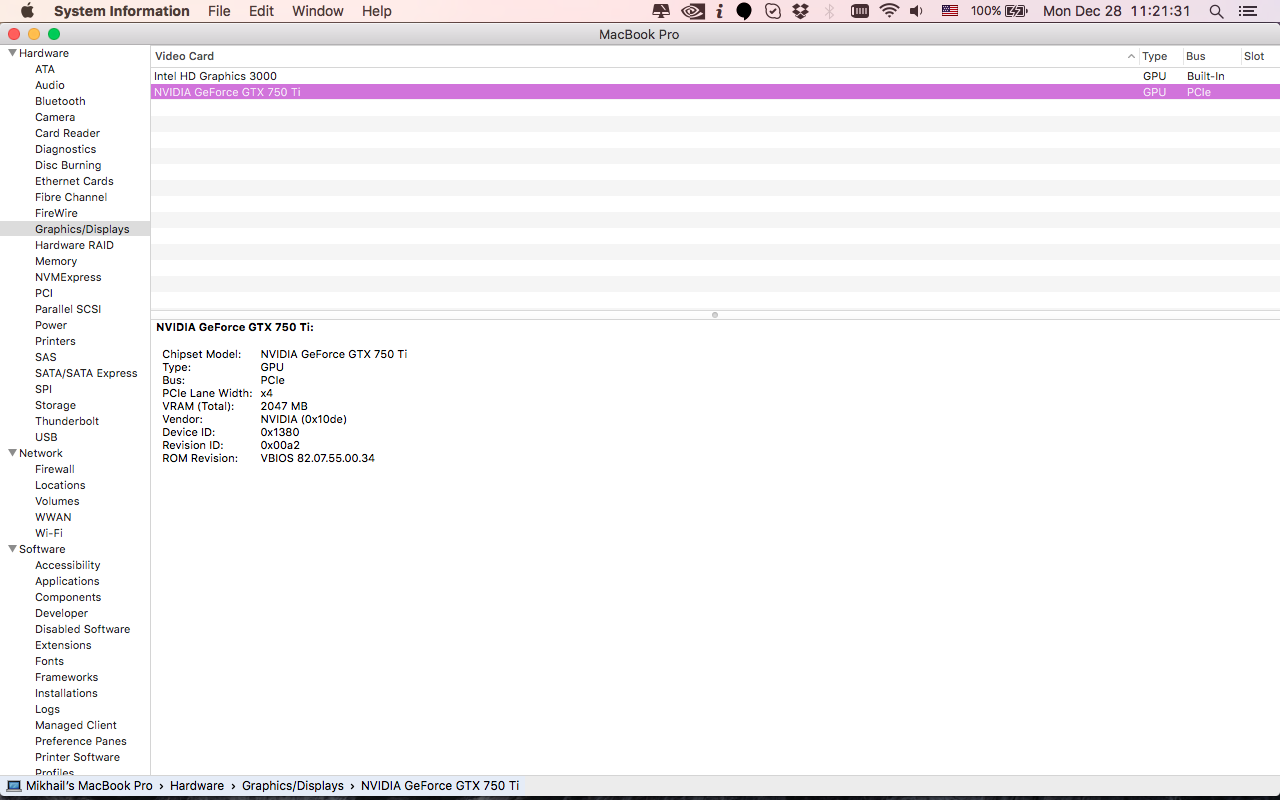

Hi
I see GTX 750 Ti among the graphic cards but don't know how to switch to it
Used egpu automate script
MBP 2011 13" Akitio T2
OS X 10.11.2
Mikhails-MacBook-Pro:Desktop mikhail$ syslog -B -F '$Time $(Sender): $Message' | grep NVDA

7 hours ago, MikhailBV said:
Hi
OS X 10.11.2
Connect a display to the eGPU, go to system pref., Displays, arrange, drag the white menu bar to the external display and make it your main display. Start a game or benchmark on the external display.

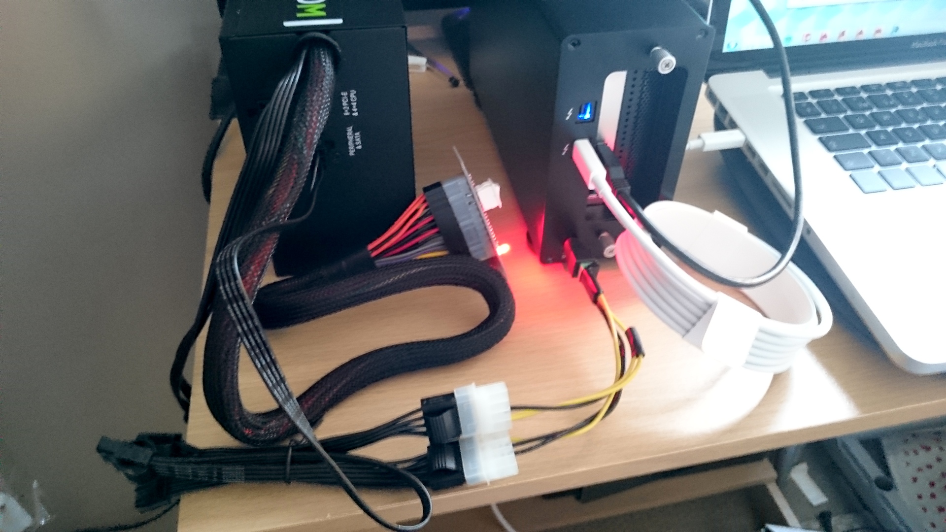

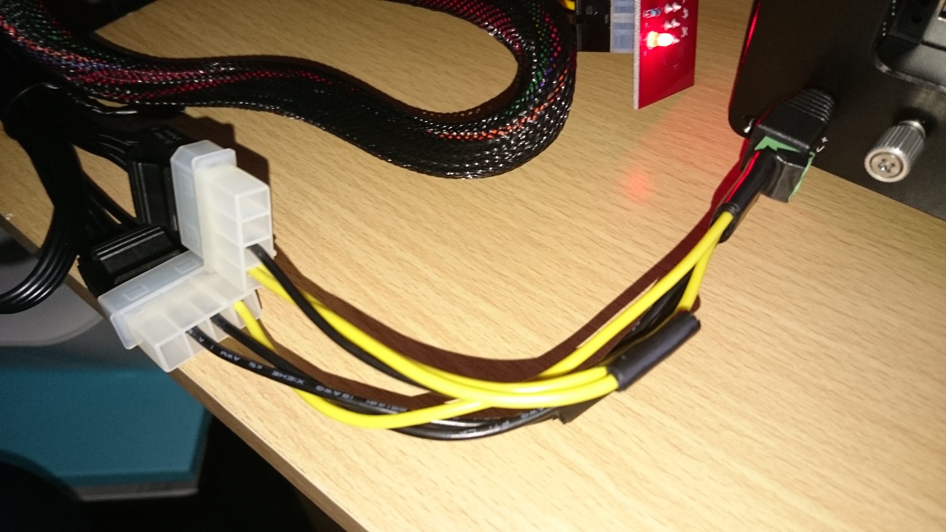

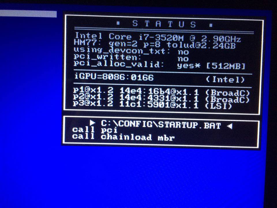

Hey man! It's a success! The eGPU is powered by the PSU, was a pain getting the plug and molex in this country, but anyways. Thanks!
Now i found a really noobish issue apparently. Don't know if u could help me out......
Saw this thread about installation, but to be honest mkdevcon doesn't seem to work. I see you have to copy devcon.txt to c:/config , but no config folder. Should I create it?
I mean, this is what happens due to that:
12435794_10156174572285538_1274561340_n.
As far as I know it should be:
  • Yes
  • No
  • Yes
And once eGPU is detected it changes to Yes / No / No, so that you can proceed. I even get a warning after going into menu based setup due to the devcon.txt
I know it's not the correct thead to ask @Dschijn , but so far I don't know where else to look for a solution. (Should've starded with an easier project don't u think?)
Again, tyvm.

Forget about that post, got to fix it. The set up works perfectly, but there is a huge flaw.
The static generated is ridiculous. I mean i wasn't even able to touch the laptop in peace. Foami made the trick, but an extra way of discharging all of that would be a perfect addition to the forum in general.
