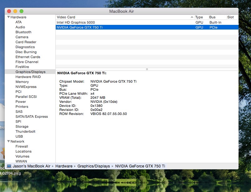

Hello, I have successfully set up my macbook air with EVGA gtx 750 ti under OS X 10.10.3. Under system report, graphic card, i can see the gtx 750 ti and the original intel graphic card 5000. My question is how do i make the gtx 750 ti as my primary display card? Does my macbook air automatically switch to gtx 750 ti if i play games?
Here is the picture:
Thanks.
@shadfan130: In OSX you need to connect an external monitor to the eGPU. After that you would hasve to make take monitor your main display by dragging the menu bar into that display in the settings.
