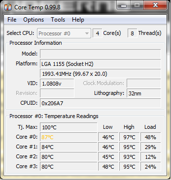

Hi all, I've been playing around with my new laptop and I tried to run GTA IV on 1600x900, all settings with auto configure(all high). I monitor my cpu temperature with CoreTemp 64bit and also overclock my GT555m to 750/1000 with EVGA. I noticed that my CPU core temperatures are really high and as far as I can tell it is not good. My GPU max temperature is around 75C. I noticed that there's only one fan underneath the laptop, which is on the left, can anyone tell me what's the component above the big 'hole' on the right side?

EDIT again: I played again for 30 mins and the core temps are climbing as above, max temperature reached is 97C, which is only 3C away from Tjmax.

@OP- I can tell you to repaste and check heat sync screws but in truth I would get Alienware on the horn right away and allow them to do it. Let them know that you expect it to operate around 80-85c which is where most m14s at 100 percent utilization are at. Good luck! StevenX
How new is your laptop? It does take time to burn in. When I first got mine it would hit 92-95 while playing Starcraft 2. I propped </SPAN></SPAN>the back up with some small books to help it circulate for the first few weeks. Now it only gets into hi 80's on flat surface. But still could be a bad paste job as Jimbo said, just thought I would give my two cents

@OP i know where you are coming from, my 14x gets to over 100*c on at least 2 cores when i play gta 4. i am getting a new mobo from dell and if this happens again i will demand that a new paste job is done. ive had my m14x actually hit TJ max after about 20mins. the system just shuts off. (i posted thread on here)
see you are using a cooler i am going air. i have nothing save for the desk lol. ive since raised the laptop off the desk about .85in and teh temps are at about 89 -95*c so that new mobo sould fix this.

alright so i got the Mobo and wow the heat is low i mean REAL LOW by 10*c (we did a tim re-apply) and teh best part... they send me a 3gb GFX card :DDDDDDDDD upgrade! for free i <3 dell screw ups.
