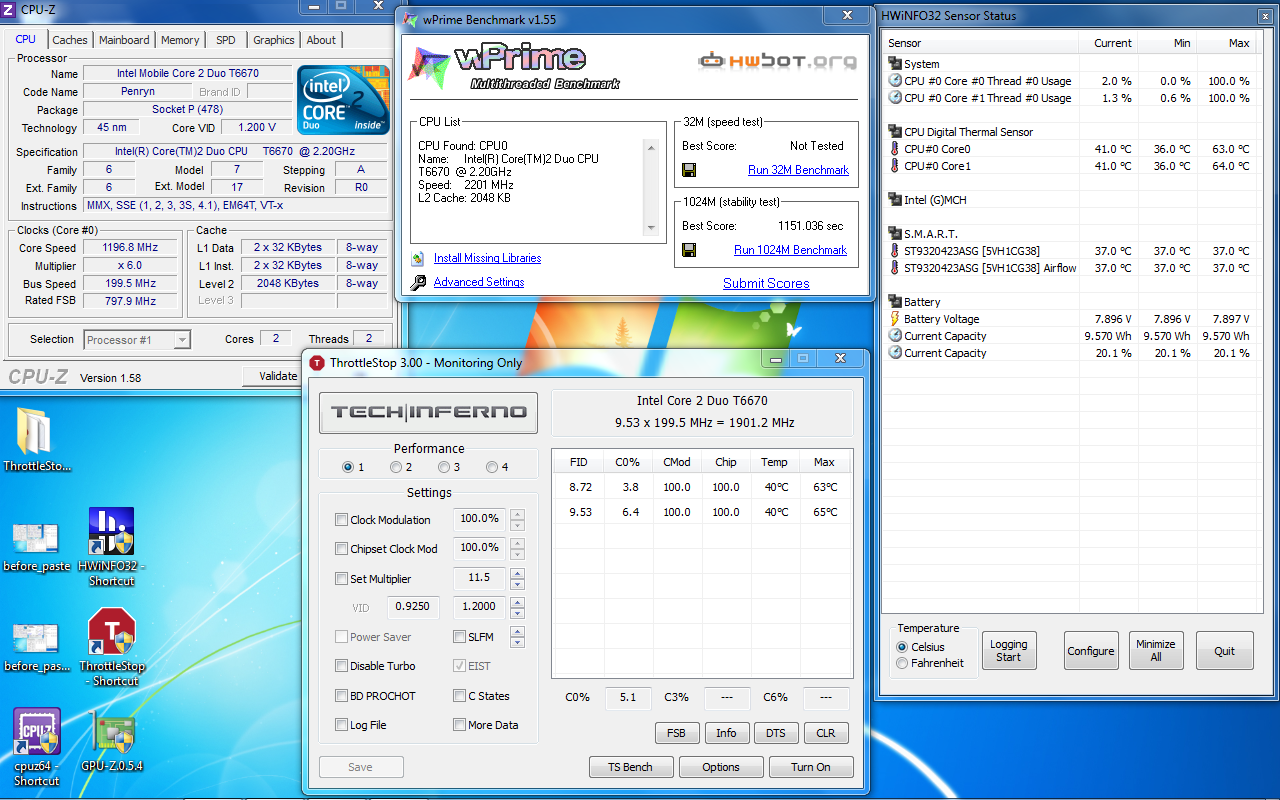

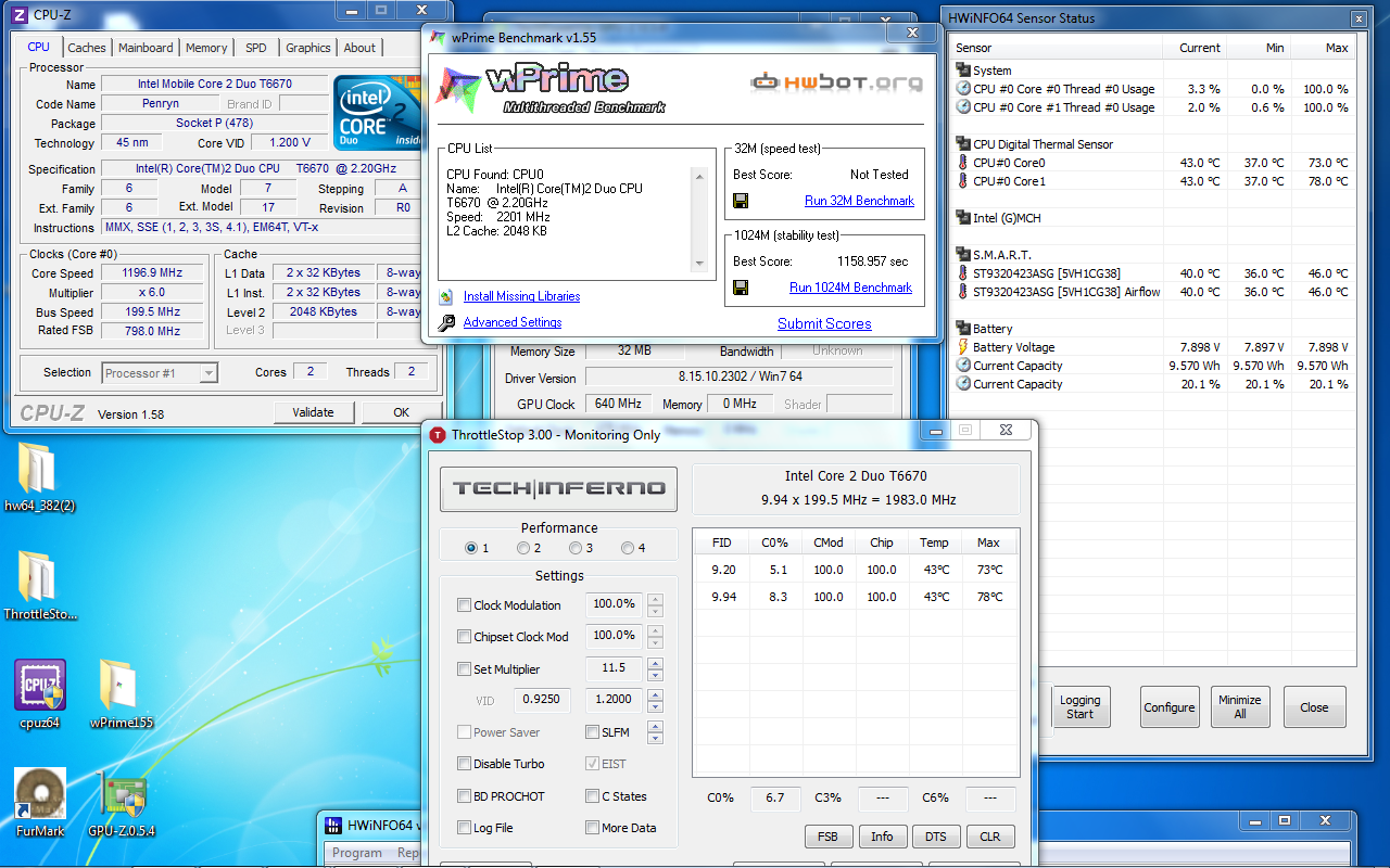

I have finished testing on a Dell Vostro 1520 (T6670 @ 2.20GHz) that I borrowed from a friend to do some testing with the paste, the difference between stock paste and ICD 24 under load using wprime 1.55 the 1024M (2 threads) was 10C lower for core 1 and 13C for core 2.

I use ThrottleStop to monitor temps at the same time cause I saw that there were instances where there was a difference of 1C+- between them so instead of choosing one over the other I used both at the same time. I have taken screenshots so you will see.

This is a teaser, Dell Vostro 1520 saw a 10C and 13C decrease in temps for core 1 and core 2 respectively under load (wprime 1.55 1024M using 2 threads)
_______Stock__________IC Diamond 24___
