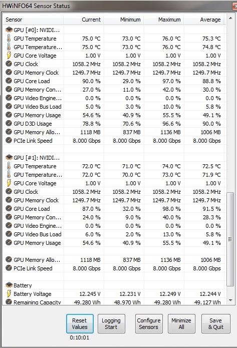

octiceps 256 Posted August 1, 2014 73.0% for first GPU, 68.3% for the Ultrabay card. So that's why I can't undervolt as much as you guys, huh? But in the end I can overclock/overvolt higher?I'm not sure as I've never needed to undervolt my GPU's, but I'm assuming it works both ways, as undervolting is technically just overclocking at a lower voltage. I could push my clocks and voltage a lot higher if I wanted to, but it's only suitable for short benchmark runs. Not practical for real usage and games because I run into a thermal wall pretty quick. Quote Share this post Link to post Share on other sites

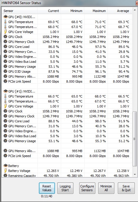

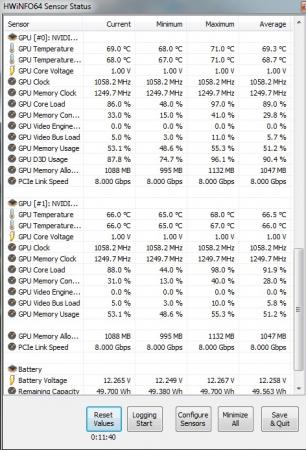

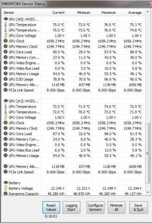

ghoul 29 Posted August 2, 2014 @Jerenny, Valley, not Heaven.... What benchmark is not boring for you? Furmark? And yes, it takes time, beacuse if you want co compare coolings, they have to reach working temperature. After that, you have to eliminate heatup readings, you have to reset hwinfo so all the readings are done during load. And yes, even the screenshot have to be taken during that time. And you have to sroll down to show gpu readings, cpu is irrelevant in this case. ( almost... ) Notice, there is 3C fluctuation, so thermal load is almost constant, no idle readings to alter average and minimum. Let me give you an example: It was taken with 26-28C ambient, CPU is down to 2 cores with HT, max 3.1GHz, to match i5. Laptop is slightly elevated, no external cooling, since we want to compare effectiveness of raised fan speed. So the upper case is with default fan speeds There is another 6C is shaved, so if you are near boiling temp, increasing fan speed can help you. Note, this is still without external cooling. But: Why do you need to shave more degrees, if you are very far from the maximum? Ok, you can say enthusiasm, i can accept it. Maybe, strong maybe, i could accept the elevated noise because of high rpm, but hey, this is a laptop, won't be that silent as a watercooled desktop. But in current state, this pulsating noise is a killer. So if you can do the same as above, extending it with 2 other cases, when laptop cooler is on, we could get a better picture, what can one expect from a cooler, this mod, this mod with a cooler, etc.. To bulk answer all the remaings post since that: Using high msaa can lead to lower GPU usage, because performance will be narrowed by membus width, and gpu will be bored. @1V 1124/1350 is stable with 2-3 degrees higher, still under 80. ASIC is 84/76, so there are similar quality chip like 650m, but it is silicon lottery, some gets better ones. @1.2V with low ambient i was able to benchmark @ 1.3Ghz, but not usable for 24/7, not just cooling, PSU was about to explode too. Edit: About cooling mods: With that you are able to squish thermal pads a bit more, so heatsink is touching and/or pushed to gpu better. Modifying ultrabay fan is a tricky one, a wouldn't recommend that, only if you want to reach 1.2Ghz or higher. Don't wait for a video tutorial, read that through a few more times, and it will be clear. If don't, feel free to ask. Quote Share this post Link to post Share on other sites

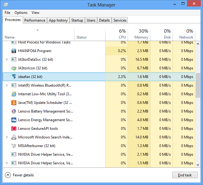

octiceps 256 Posted August 10, 2014 IdeaFan has high CPU usage at idle? Goes down to 0% when I start the fans. Quote Share this post Link to post Share on other sites
allstone 53 Posted August 10, 2014 FYI the auto start option doesn't work. It adds an IdeaFan shortcut to the Startup folder but it is automatically blocked by UAC in Windows 8 after log on. I'd recommend creating a startup task for IdeaFan in Task Scheduler if you want it to start with Windows.IdeaFan has high CPU usage at idle? Goes down to 0% when I start the fans.Put everything into the improvement list. Quote Share this post Link to post Share on other sites
