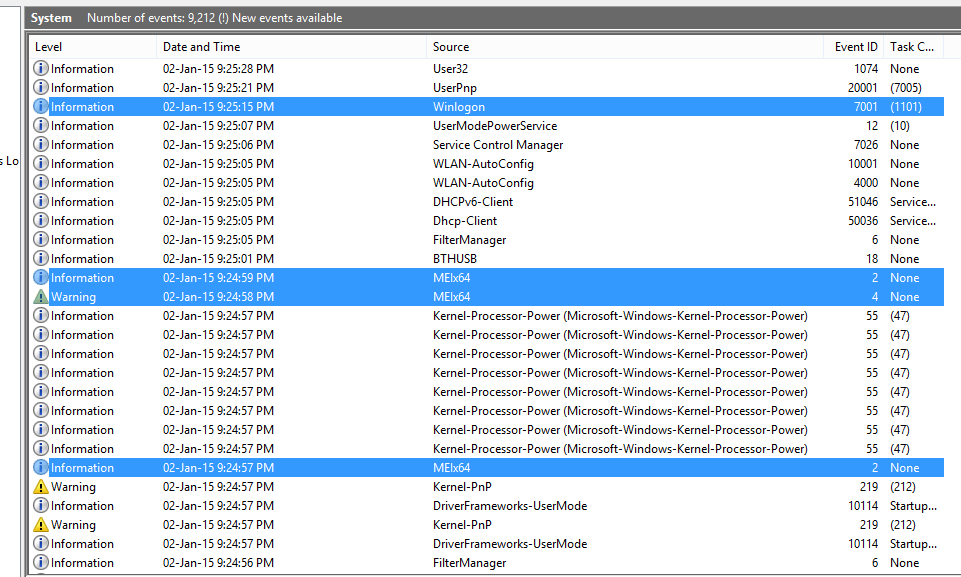

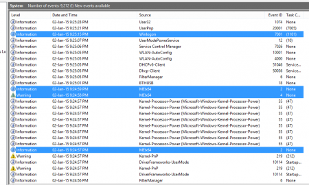

I assume you are referring to me in one of the spoilers. I'm the person who switched out his GTX770 for a GTX760. I must admit I was a bit fast in crying victory, as I mentioned in a few post further down in that thread. The GTX760 does reduce the problem significantly compared to the GTX770 (it happens a lot less often and also much later compared to my GTX770).
However, I do have a GTX460 (1GB, 2 x 6 PCI-e power pins) as a spare graphics card and have been using it for over a week now without a single crash. It's obviously not as powerful as a 700-series card, but it runs flawlessly. I may get my hands on a GTX560 of a friend for a while and can use it to test this card as well.
Btw, I checked my event logs when using the GTX760 and GTX770, and both of them give the entries you describe in the OP. Using the GTX460 only gives one MEIx64 entry in the log after the WinLogon event.

[ATTACH=CONFIG]13892[/ATTACH]
Yes, it was you I was referring to but I didn't want to search for your post as I didn't know anymore in which thread I had seen your post and I didn't know your name either :S.

This is very interesting information. Optimus can only be enabled with the iGPU present. Your Macbook having the GT 750M but giving the same messages hints that it isn't Optimus or iGPU related.
As I previously wrote in the first post, something is going on at boot which leads to those messages. I'm starting my Macbook by pressing Alt until the boot menu appears, then I plug in the already powered eGPU, wait a second or two and then I boot Windows. Same procedure all along but sometimes it loads with the iGPU enabled and I do not know why, it also happens if I don't load OS X in the meantime. I then have the messages like you but I only have the iGPU in my Macbook which is why we thought it's Optimus related.
I don't know, maybe this is some weird allocation failure happening at boot? I'd still like to know if this the reason for the crashes or if it's really something electric related to the Akitio board.

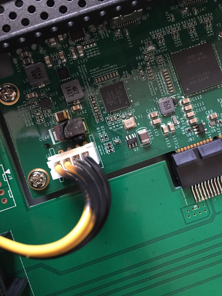

Update: After soldering two cables on the jackplug rearside I connected it wrong on the 12V molex, I confused the + and -. Look what happened:
That's the end of the story lol...
[ATTACH=CONFIG]13897[/ATTACH]
Ouch! :(
Looks like one of the condensers on the TB card is fried but there's probably more damage elsewhere. I hope your GPU is still OK.
Yes, do you have any idea what type of chip/condenser this was? I can't read it anymore, I might try to solder a new component on it.
That's the reason I wouldn't touch this thing in such a way without a detailed super dummie guide ;)
Sorry for your loss, though =/
Thanks!
It looks like an 107C SMD Tantalum capacitor. You can get a replacement part from here. It's a polarized capacitor so make sure it's soldered in the same orientation as the original part (see pictures here). Like I mentioned before, it's likely that this is not the only damaged component on your AKiTiO boards. It's worth taking a closer look at both boards and checking for burned tracks or other damaged components. Some you can check with a multimeter, others (such as the ICs) won't be easy to check without more sophisticated equipment.

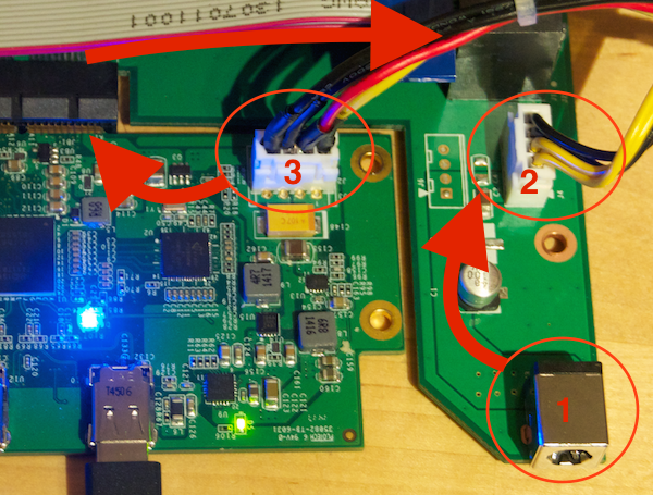

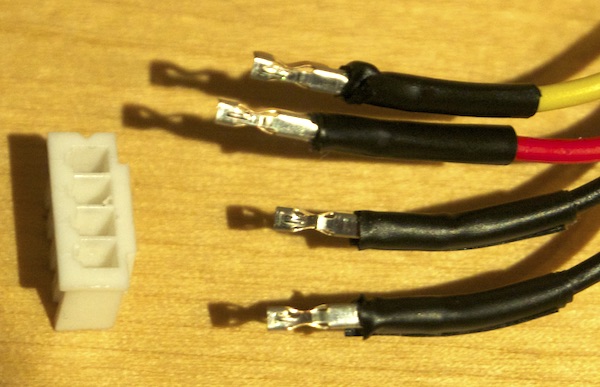

I re-evaluated the purpose of a small 4pin power cable of the AKiTiO PCIe board WITHOUT CUTTING WIRES. I just used a modified floppy drive connector.
OWC Mercury Helios has the same PCIe board (exactly the same part number) and maybe some of you have noticed that it’s equipped with three 4pin sockets (1 for TB card + 2 for PCIe board), but let’s focus on the AKiTiO which has two of them.
Please do not take this how to properly power the AKiTiO PCIe box. Modifying the cables by yourself is dangerous. I don’t take any responsibility if you fry your board. My tests are just a proof of concept. If you consider doing something similar, please use a multimeter and always check the voltage and polarity before plugging in any wires!
All the combinations of previous methods resulted in unstable AMD eGPU and a blank white screen during the physics part of the 3DMark11 test. I was interested in how much the J4 socket (2) consumed power, but as a side result my configuration passed 3DMark11, 3DMark13 and Valley benchmarks completely. I used two PSUs, and two risers (RSC-R2UT-E16R + the riser of Milo ML07). I can repeat this after each reboot, but second run of 3DMark11 physics part crashed. I was able achieve same results sometimes with one PSU as well.
AMD Radeon R9 280X video card benchmark result - Intel Core i7 4702HQ,Apple Inc. Mac-3CBD00234E554E41
AKiTiO has 3 power sources ready:
- 2.5mm/5.5mm DC jack, (1) in the picture
- 4pin power socket, (2) in the picture
- 4pin power socket, (3) in the picture
Additionally J6, which is connected to J4 directly - both of them have a +12V line to J11 (the biggest socket place on the other side of the board). OWC utilises J6 instead of J4.
Observations during the 3DMark 11 performance test:
- Either one of power sources (1) and (2) is compulsory. If you don’t plug anything into these, GPU will never show up in the device manager.
- Power consumption of (1) and (2) are almost equal. Constant ~9W-10W and it doesn’t change a lot during the performance test but there is a slight difference when you use another GPU. GTX780 gave a very constant 8.9W number during all the performance period, but with the R9 280X the consumption was approximately 1W greater, still very constant as well.
- Power consumption of (3) depends on the GPU. We have now a proof that x4 slot is able to output much more than 25W through the TB card + PCIe board. Note that we are not sure how safe it is for the TB card and PCIe board, because AKiTiO is designed for 25W cards and the inner lines may be too thin for 75W. The safest option is to use a normal powered riser.
Unfortunately it doesn’t seem to have an effect on stability whether you feed power directly to (3) or via (1) and (2) with the original 4pin cable. I doubt to get 100% stable AMD eGPU after every reboot, but at least I found some keys to pass 3DMark11 physics part, new powering methods and interesting power consumption numbers.
Thanks, I already ordered a new 107C to fix this. Only this component was damaged, everything else is OK.
This is of course not very useful to hear after a disaster like this (been there myself), but always double/triple check with a multimeter for polarity and use a marking pen, especially when there are only yellow cables. I really hope you manage to revive your board with the 107C.
