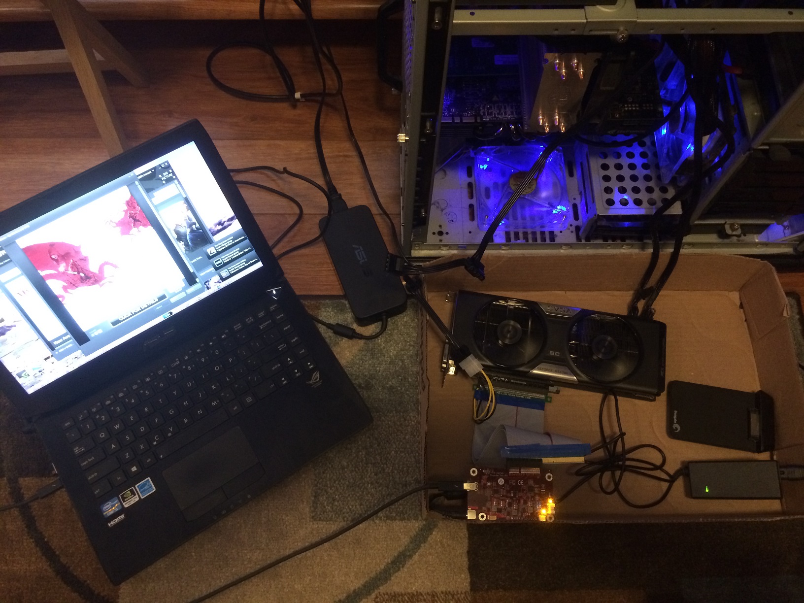

This isn’t so much of a guide as it is a review even though I’ll be listing what I did. This was, honestly, not very hard to get working at all. Back in the T420 days, I had a much harder time getting the power/delay switch working, EC always locking up on me and not being able to run with more than 3GB of ram until Lenovo FINALLY released a BIOS with the correct TOLUD. I lost a lot of interest but gained traction after finding a motherboard for my current daily driver that has a thunderbolt chip on it.
My BOM:
Asus G46VW: $630 from Newegg. This was the base laptop with a Core i5 and 8GB of ram. (Link)
Asus G46VW Thunderbolt Motherboard Rev 2.2: $180
Intel Core i7 3840QM: $350 – From Lenovo W530
8GB DDR3 1666: $35 – Old laptop I had laying around
Firmtek Thunderbolt Adapter: $199 shipped with enclosure (Link)
2M Thunderbolt Cable (Apple): $39 (Link)
Corsair 650: $100
PCIe x16 Powered Rise: $10 (Link)
GPU Of your Choice: $xxx
Total: $1545 + GPU of your Choice
Yeah.. not saying I don’t like Macbooks (I never use mine) but this is a much better deal.(Minus his awesome enclosure) Plus I have powerful dGPU when on the go.
First off, I’d like to start this out by talking about my power supply findings. I was using a no name brand (literally had no brand markings other than a rail amperage chart) to power my 550ti. This led to very unstable operation and I really couldn’t figure out why given it was a 400 watt power supply. My recommendation is to use a power supply that is Haswell certified. This totally makes sense as running an eGPU only puts load on only the 12 volt rails and while it’s idling it uses VERY little power. This can sometimes cause the fault protection certain to kick in and shut down the whole thing. As long as you’re using a high quality supply this won’t be a problem. I am a power draw nut and I watch every every watt when it comes to load an idle. I spends days trying to save a watt off idle whenever I can lol so I figure I’d put that out there when It comes to picking the right power supply.

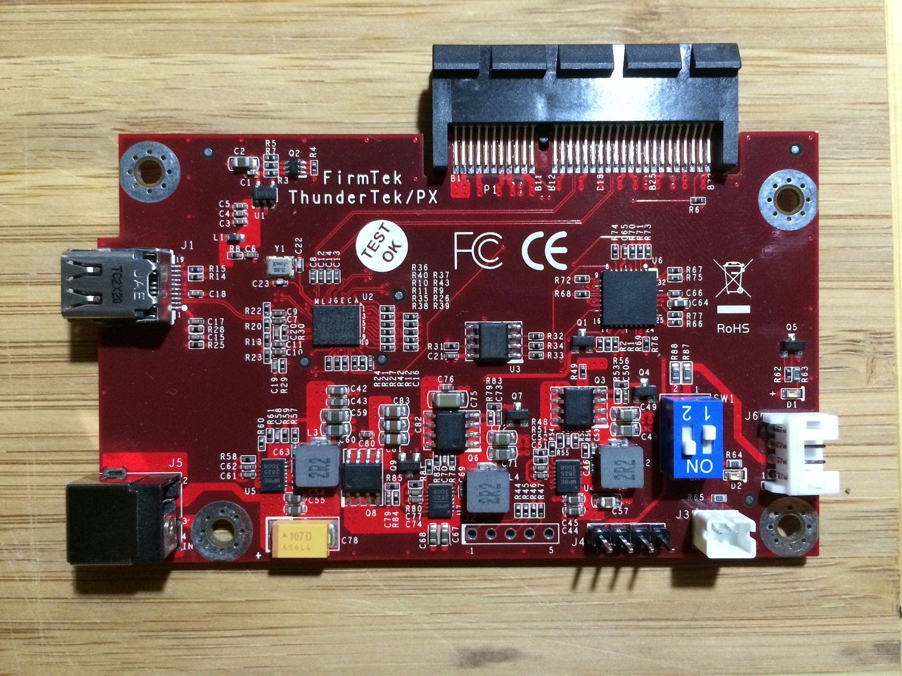

FirmTek Adapter Details:
The Firmtek Adapter is a x4 slot that is not opened ended. I had to cut out the end at first because I wanted to try a GPU without a powered riser. It worked but was very unstable. I went with a x16 slot powered riser (Link) in case I needed to borrow it for other projects (that's really the only reason). The two white headers are for the enclosures fan and power LED's. The DIP switches' function are still unknown to me. Photo's Below:

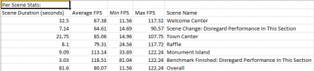

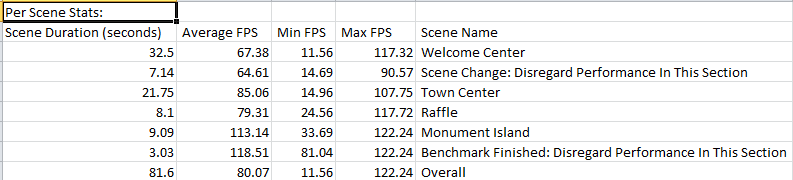

BioShock Infinite: (Highest Benchmark Setting)
Just Case 2: Everything on/set to max
Average Framerate: 241FPS

Power Draw Numbers:
Windows 8
Laptop Windows 8 Idle: 7.8Watts
Laptop Windows 8 + eGPU (780Ti) in Optimus Mode Idle: 39Watts
Laptop Windows 8 + eGPU on External Screen: 63Watts (added power draw for the screen)
Laptop Windows 8 + eGPU Optimus Under Full Load: 389Watts
Laptop Windows 8 + eGPU External Screen Under Full Load: 410Watts
Windows 8.1
Laptop Windows 8 Idle: 7.1Watts
Laptop Windows 8 + eGPU (780Ti) in Optimus Mode Idle: 58Watts
Laptop Windows 8 + eGPU on External Screen: 68Watts (added power draw for the screen)
Laptop Windows 8 + eGPU Optimus Under Full Load: 401Watts
Laptop Windows 8 + eGPU External Screen Under Full Load: 420Watts
Using Windows 8 to control the dGPU causes increased power consumption it seems.. This doesn't affect my battery life obivoulsy but is something I am looking into. My rough guess is that the dGPU isn't being shut down properly in Windows as Windows is essentially disabling the device in the Device manager...

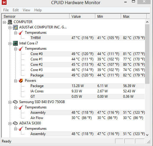

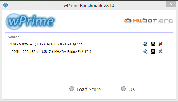

Could do a run of 1024M(4 threads) in wPrime and measure your max temp and duration for the 3840QM (like this)?
Actually, the G46VW was one of my first candidates that I was looking for early on, but there was no low cost TB->PCIe hardware at the time.
Thanks buddy!
EDIT: Ohh, one more thing, I'm about to buy a G46VW.
How can the seller check if it's a thunderbolt revision or not, device manager maybe?
Would be really happy for a fast answer since he might be selling it off to someone else.
You can't buy a G46VW with thunderbolt. They were never released. I had to source the motherboard from a company in Korea who had to use their contacts to find one. Also, it wont show up in the device manager unless there is a thunderbolt device connected as it disables the chip to save power.
As for your first request on the benchmark and temps. Sure thing!
EDIT: wPrime

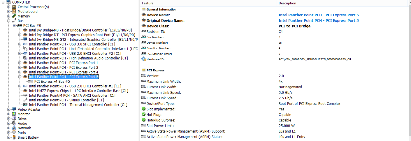

Are you sure there is nothing stated in BIOS that reveals TB functionality?
My stock motherboard had some simple thunderbolt wake delay settings but no thunderbolt. Ask the seller to plug in a thunderbolt device and have him take a snapshot of this screen using HWinFo
The highlighted entry is where the thunderbolt chip sits. it will show something underneath when connected.

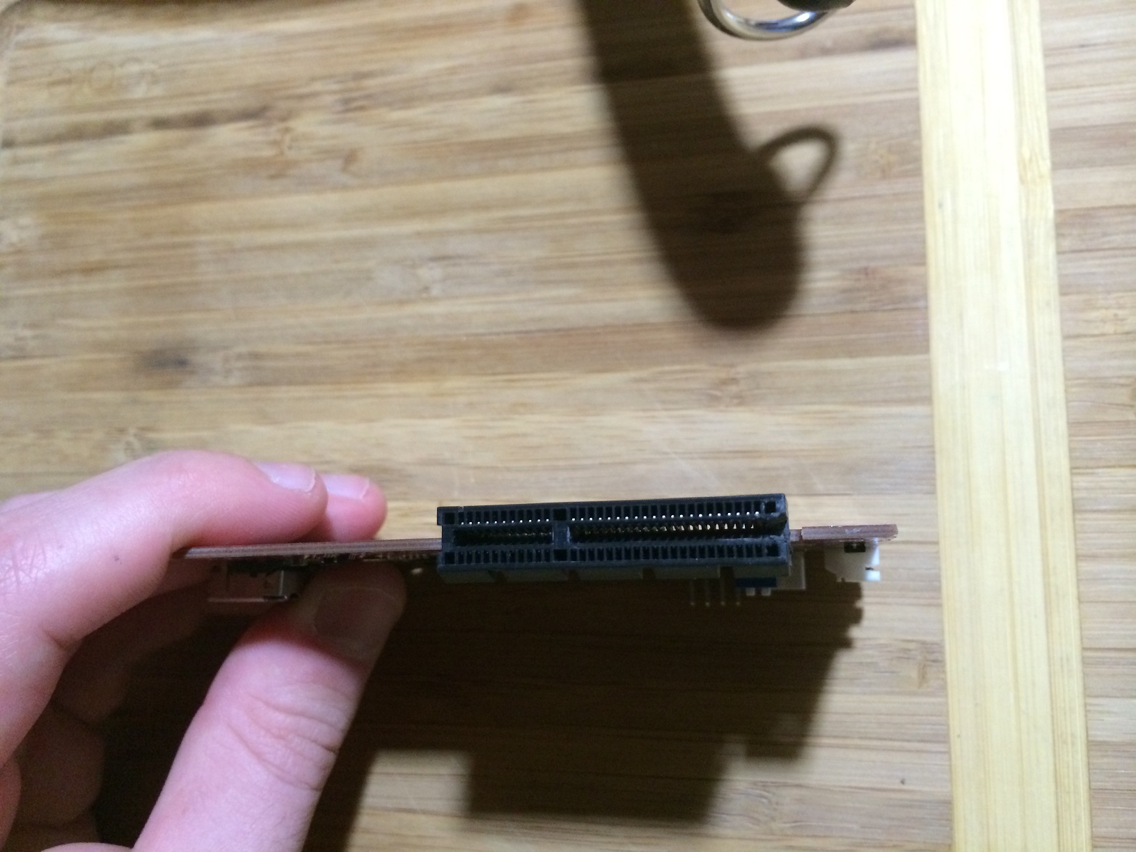

Regarding 3),I was looking for one as well, but didn't find any item that had the capacitor and 3 cables for power. Please link one here if you find one.
The cheapest way is to buy 2 adapters:
1) One to plug into the ThunderTek/PX: PCI-E 4x to 16x Riser Ribbon Extender Cable Adapter Extender Cable +/- $ 4
2) One to add the power: Powered PCI-E Extension Cable 16X To 16X Riser Extender Card with Molex LTC DOGE +/- $ 7
I guess this would work?
Or you can buy only one adapter (4x to 16x with power) but they ask too much money: 4 x PCI Express PCI-E 1X to 16X Slot Riser Card Flat Flexible Extension Cable +/- $ 40
I pretty sure the picture doesn't show a 4x connector, its more likely 1x.
I'd buy a 16x -> 16x with power and split/cut/mod it to 4x instead, seems like the cheaper choice.

meaning its a PCI enxtender/extension or riser all the same thing.. but PCI is different than PCIe. The one pictured is a PCI adapter not a PCIe one
Omg you're right, it's the old PCI interface! By the way the G46VW seller just went up in smoke so I have no deal yet, irritating...

Is this specifically the enclosure? The link on the first post only leads to their front page:
ThunderTek/PX: PCIe Thunderbolt Expansion Chassis for Macintosh
Then I'd add this:
PCI Express PCI-e 4X TO 16X Riser Card Extender Ribbon Cable with w/ Molex Connector, View PCI-e card, ulanson Product Details from Shenzhen Ulanson Electronic Co., Ltd. on Alibaba.com
and just need an external PSU to run it.
