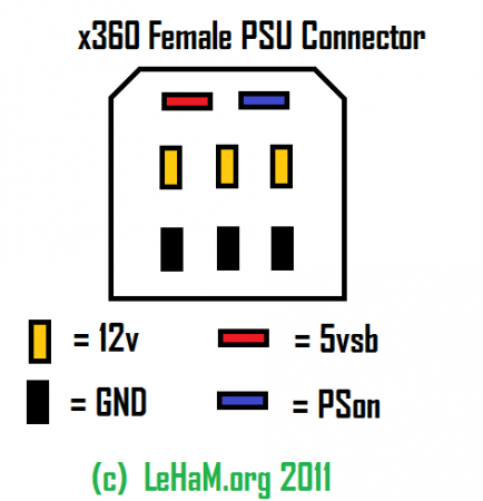

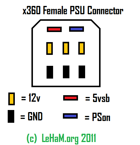

I can't say for the Dell PSU as I've never used one. For the XBox 360 PSUs (i.e. there are 3 different ones of varying wattage) some soldering is required. The XBox360 Jasper unit has some 150w, which was more than enough to power my GTX 670 o/c and the TH05. The 150w xbox 360 PSU needs to be cut to expose the wires underneath. The wires are as follows: - 3x yellow wires (12v) - 3x black wires (grounds) - 1x red wire (5v) - 1x blue wire (return/checker) I connected one yellow each to the six-pin GPU connectors by wiring those together directly. I then powered the TH05 with the other yellow wire. I then hooked up the blue and red wires to a switch because the blue and red wires are essentially a power safety mechanism that checks whether there's a closed circuit and allows the PSU to come out of sleep-mode, if so. I'm planning on using the 203w xbox 360 PSU for the newer Akitio Thunder2 unit, not that it actually requires more power (i.e. it may, but not an additional 53w - more like 10w). The wires are the same expect there is an extra yellow and black/ground. I'll be wiring the GPU directly as mentioned above, then the GPU riser molex in order to power the x16 interface with another yellow wire. I will then power the actual Thunder2 daughter-board directly by splicing another yellow wire. It's best to splice the wires by twisting them together, then using a little bit of solder to create a solid bond. I then like to melt some plastic cover over top of the solder reduce chances of fire/wire-crossing. *** caveat: I'm not an electrical engineer. I just tried this and it's worked for the last two years without any issues, so... *** Best picture I've found so far... And I've never seen this 200W Pico PSU before. It looks pretty awesome actually. If you can get 200w out of it, you'll just need to wire it up properly and Bob's your uncle! Honestly though, that's a pretty cool find. I might consider trying that one instead. -

@arclord - do you know if the 2.5mm DC jack needs to be plugged in or can we simply power those boards directly into those yellow/black molex plugs??? I have my Akitio in front of me while I am trying to plan my soldering... I'm using an 203w xbox 360 psu, as opposed to my old 150w jasper unit because I need to power the PCI-e riser. I get four yellow 12v wires, 4 grounds, one red and one blue for power safety switch. I'm planning on using two 12v to power the GPU 6 pins, one for the PCI-e riser and one for the boards. What do you think??? -
