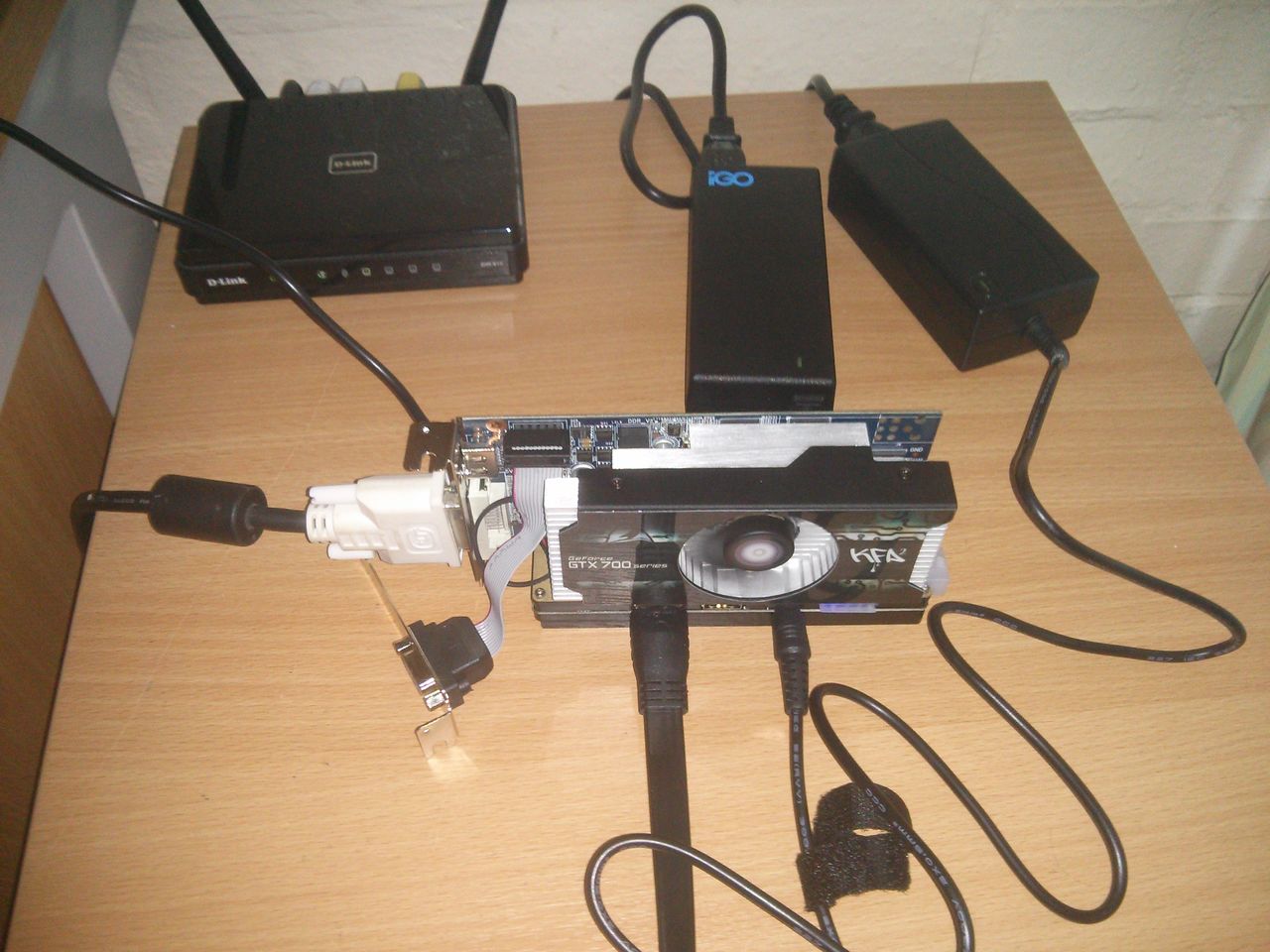

rhx123 Posted May 9, 2014 Share Posted May 9, 2014 Great news! A small, £7 PSU from eBay can be easily used with the DC port on the EXP. I have tested with 750Ti, running valley benchmark for 2 hours, and no instability, and the power pack gets no hotter than the one that I have for the Elitebook its self. Power supply is Pin Positive. 3 Quote Link to comment Share on other sites More sharing options...
jacobsson Posted May 9, 2014 Author Share Posted May 9, 2014 This is great!! Ok pin positive is standard pinout I guess? Nice job and slick Quote Link to comment Share on other sites More sharing options...
rhx123 Posted May 9, 2014 Share Posted May 9, 2014 Yes, pin positive should be standard, but if someone has a power supply they aren't sure about, they should always check, a £5 multimeter from eBay is much less expensive than £100+ GPU.The only downside, as was mentioned, is that the automatic switching on/off doesn't work. Can't seem to find an inline one for sale here, but making one should be no problem because jacks and sockets for that size plug are very common.In addition ,I've done some multimeter testing on the USB port on the EXP, and would suggest that it should be steered well clear of on the power side. Whatever voltage regulator that is on the EXP for the 5v line is really poor, if it's something like a wireless mouse then you might get away with it, but an external HDD is a complete no go.If you did want to use the USB port to make some sort of all-in-one dock, find a powered USB hub, cut the power lines from the B port, and power the hub from a higher quality 12v to 5v regulator from whatever PSU you are using (unless ATX PSU when you can just use it's own 5v lines). Quote Link to comment Share on other sites More sharing options...
