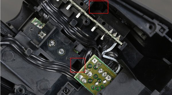

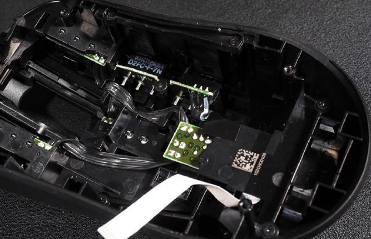

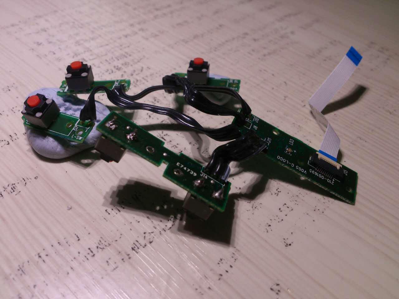

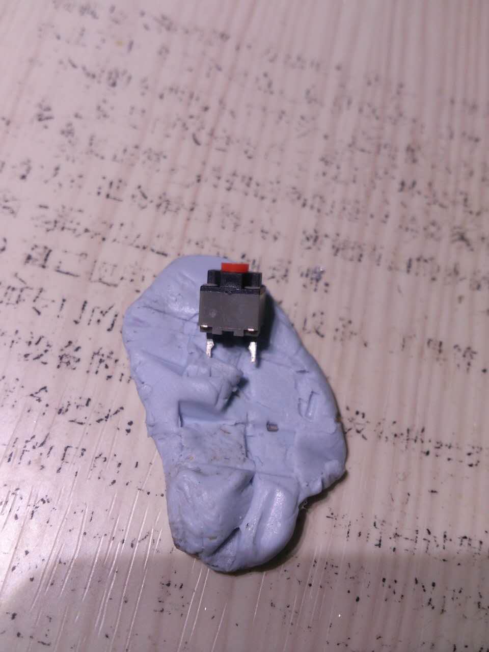

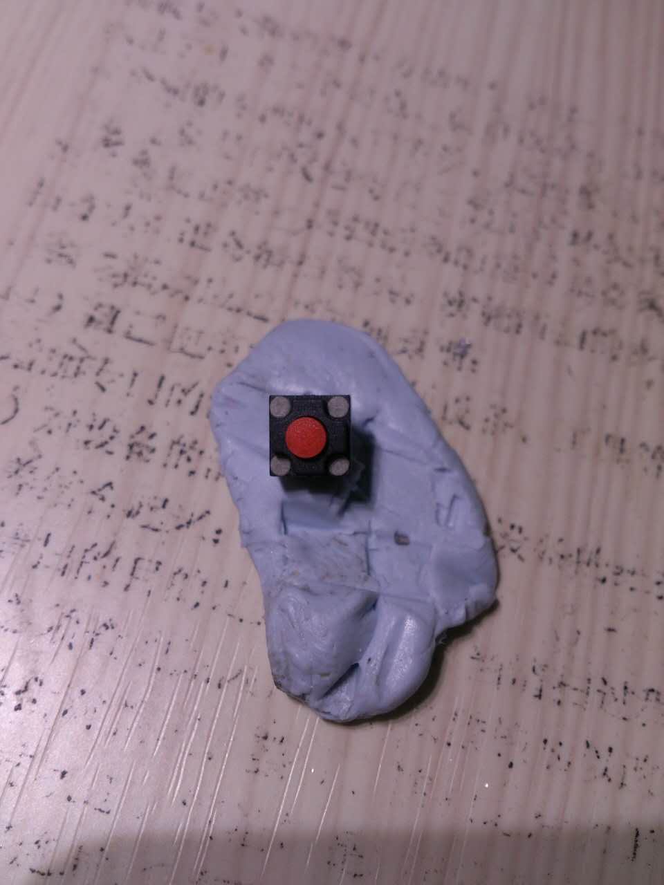

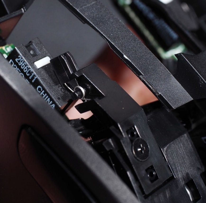

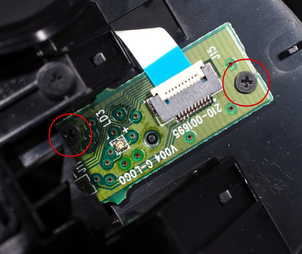

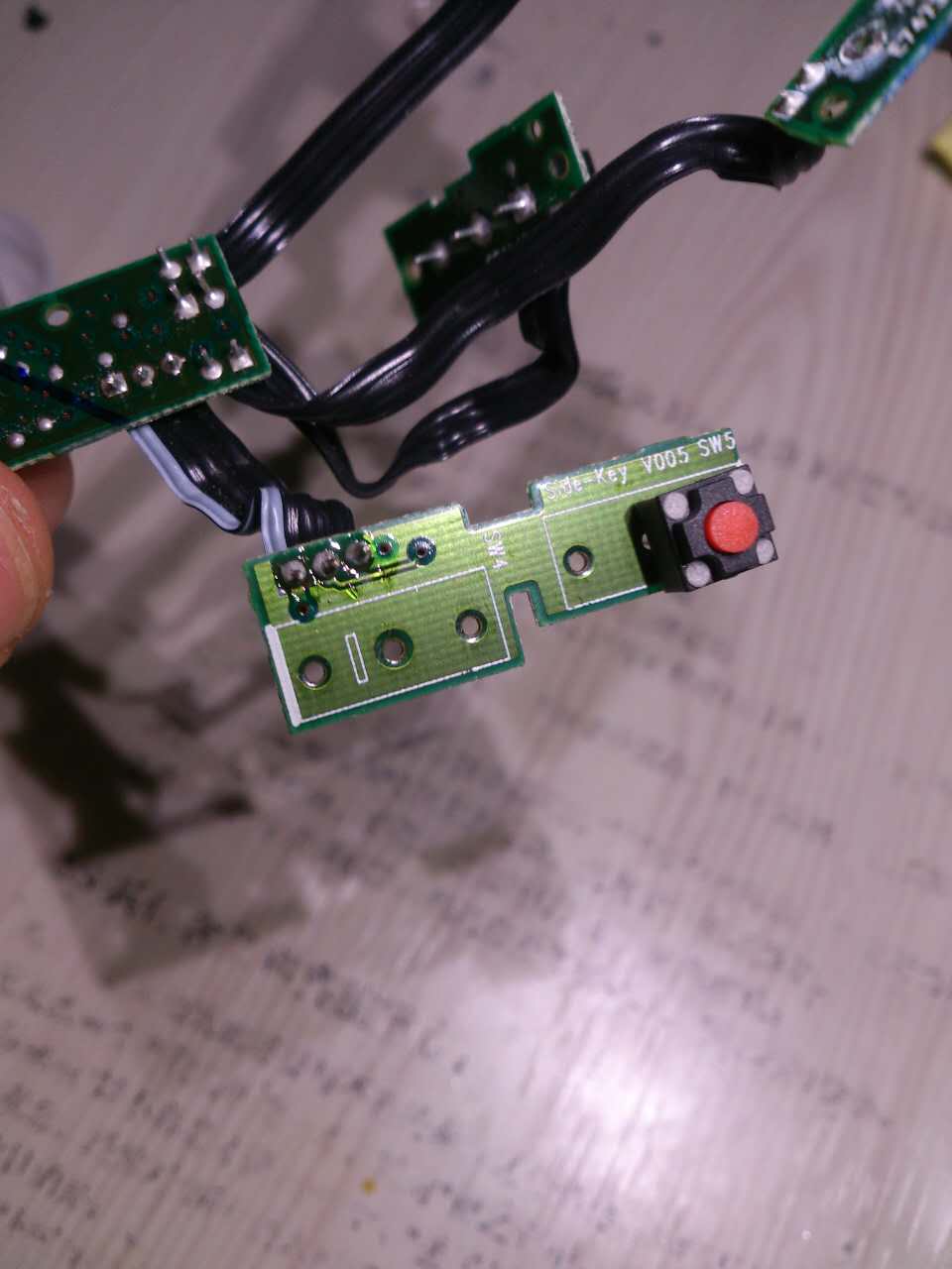

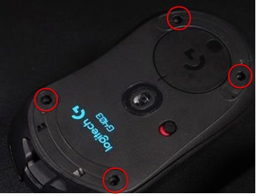

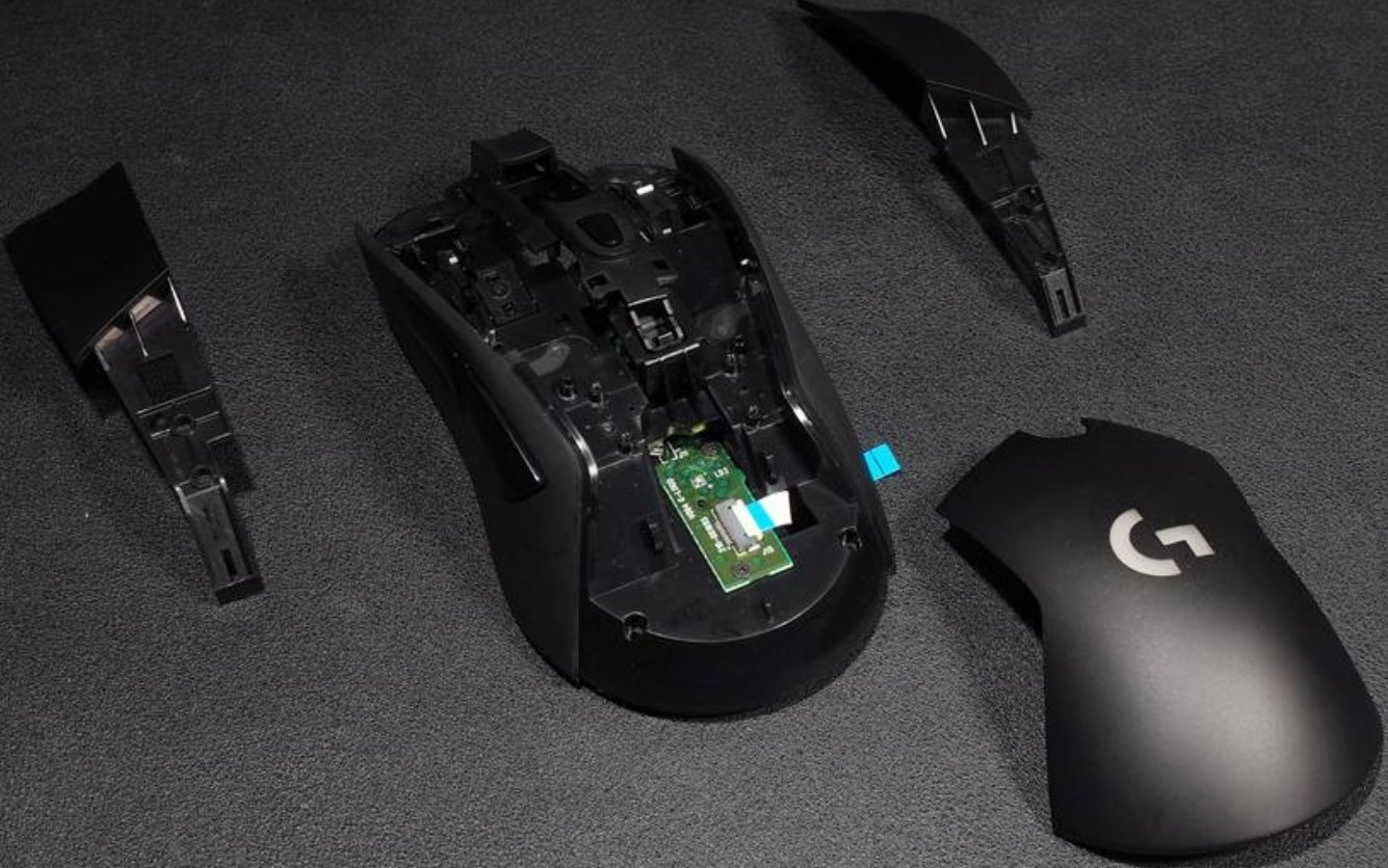

Hello everyone! Everything is very easy if you have a pair of hands, solderer, flux, desoldering pump, and magical silent switches. All of these you can buy online almost for nothing. Teardown your mouse, change original switches to silent ones. Remember, that one of the three legs is useless (see the marks on the textolite). That is it! No one will be annoyed by clicking sound from no on! Be careful if you use solderer for the first time: 1. It is always good to watch some Youtube videos first; 2. Do not overheat textolite or components. During soldering things, apply heat no more than 3 seconds, otherwise there is a risk to damage textolite or components. Good luck! And happy noiseless gaming!

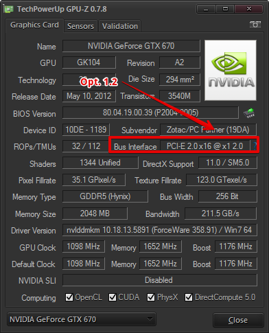

No, no and no. If you use nVidia I strongly advise to set "Automatic" for Express card port in "Power section", and "Gen2" for PCI Express Root in "Advanced" section, otherwise your eGPU will work on Opt 1.1 speed and not on Opt 1.2, which cuts speed in half. -
