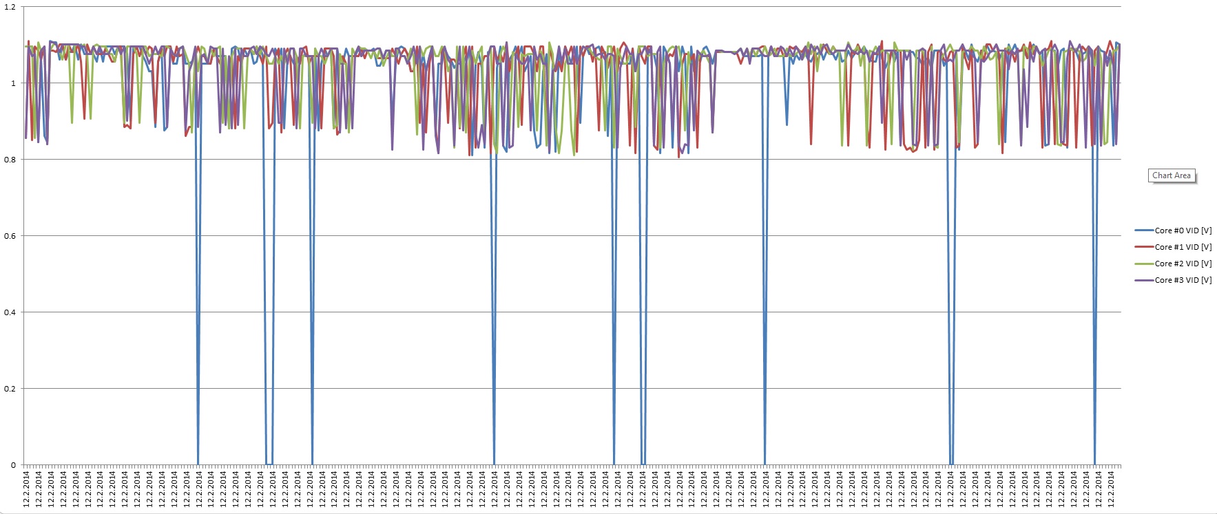

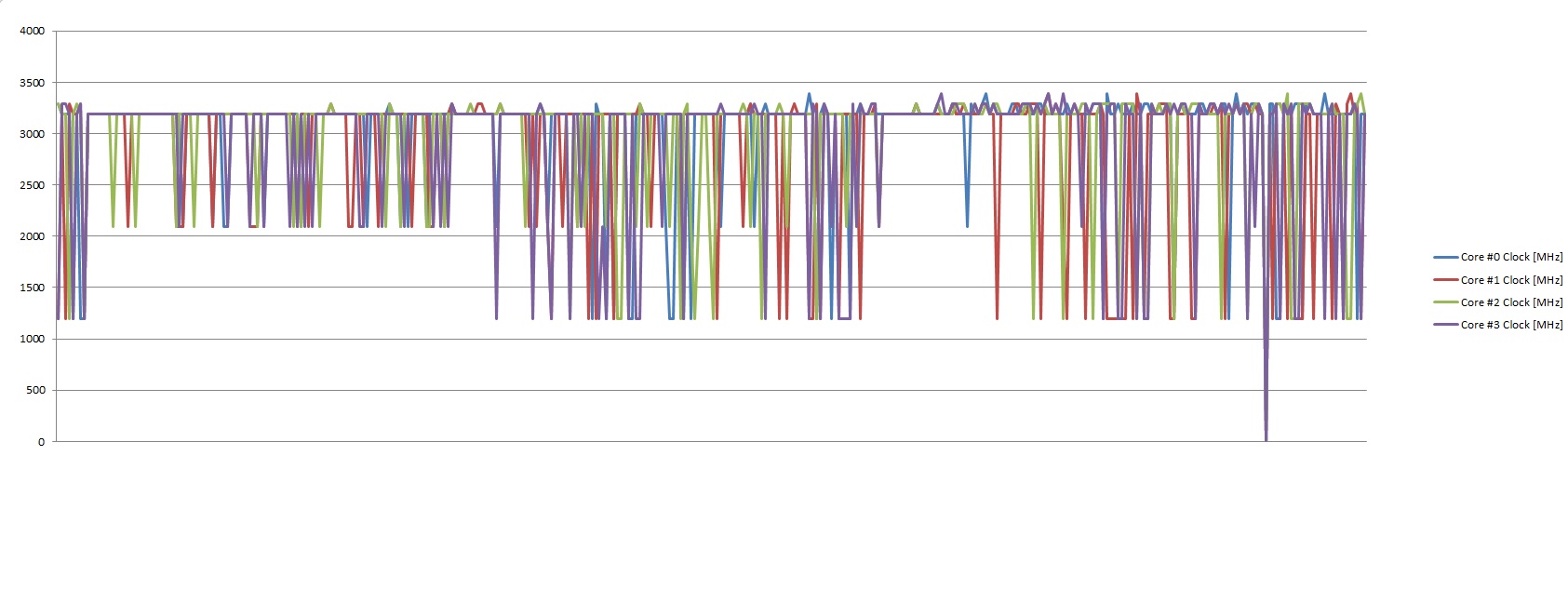

Update. I also created these two graphs to show the CPU voltage and Mhz during this last Fire Strike Test:
I also tried to run the test with ThrottleStop 6.0 on, - it does not change the result.

What are your CPU temps? Looks like turbo boost is running wild. Have you tried using Throttlestop?
Thank you for your response. I've tried to use Throttlestop 6.0 with it (I have checked EIST, C1E, Set Multiplier 63T - and also BD PROCHOT unchecked) - it shows Max CPU temp being at 66 C.
The score does not really changed.
