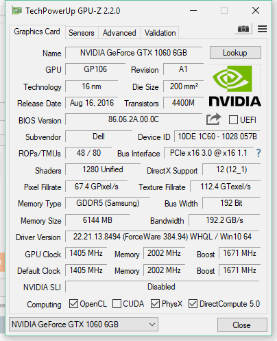

I quickly got into bios, changed the settings and installed the 1060.
But alas, it didn’t start. 8 beeps again. Woodzstack helped here again.
The issue was default display setting in bios and the uefi settings. Uefi needs a compatible gpu to save that setting and boot with that gpu. As k1000m wasn’t a uefi compliant gpu, I was stuck again. But changing the graphics settings to auto and then it let me disable the legacy settings.
After applying these settings and installing the 1060, it let me boot.
Somewhat.
No bootable media detected. Press any key to restart.
Turns out that the gtx 1060 is fussy even about bot drive partitions. Had to reinstall windows on a GPT partition. MBR to GPT conversion did not work. Needed a fresh install.

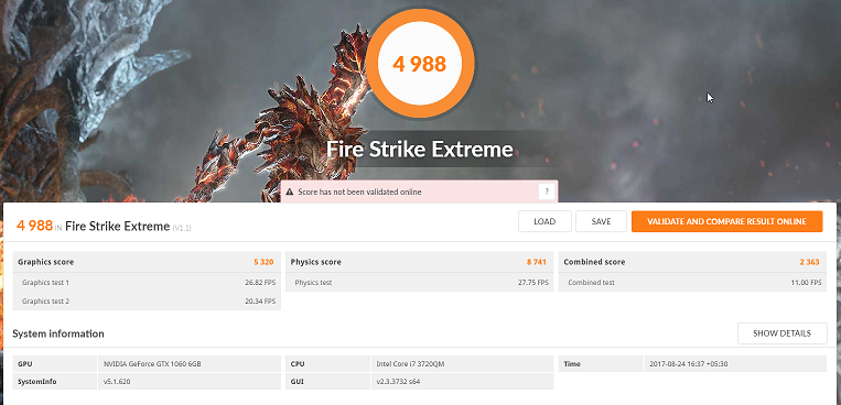

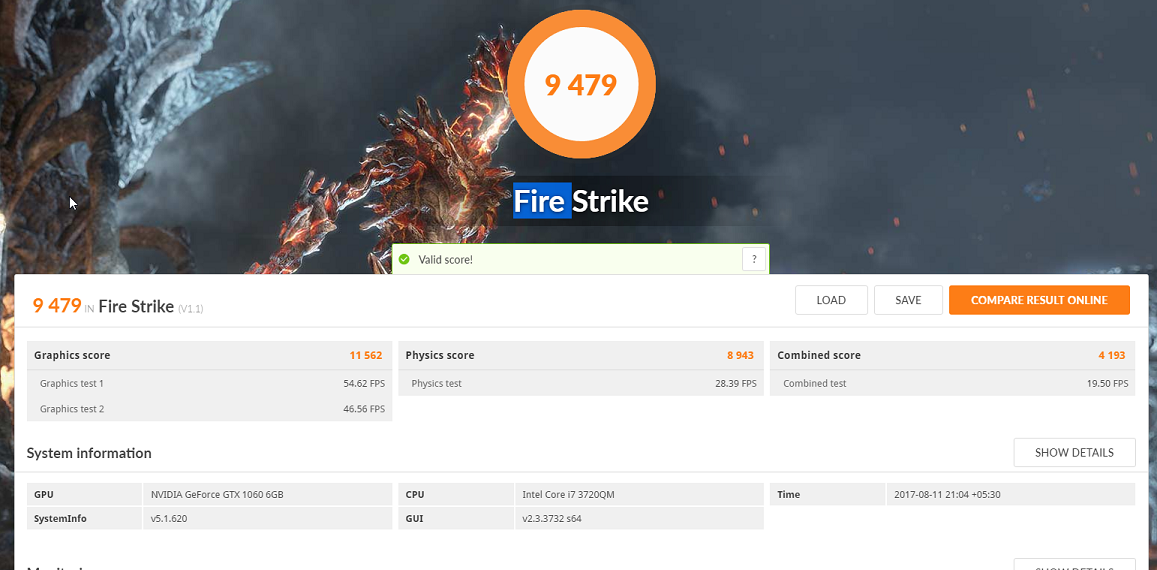

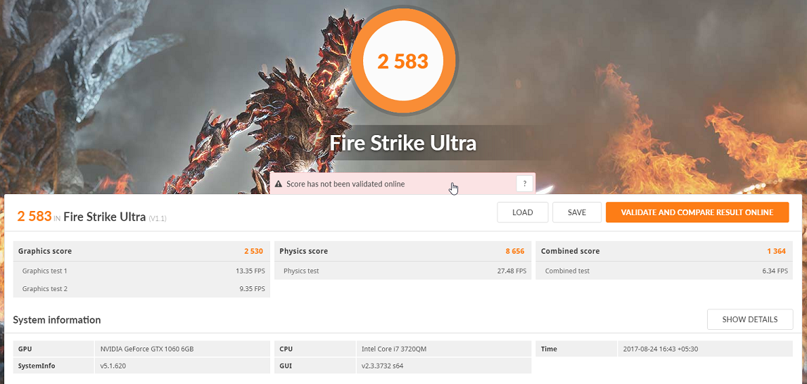

Note: for 680m, the benchmark was done on max overclock +300 core and +500 memory. Stock score would be nearer to 3DM11 P=6300-6500, Ex=2200-2400
Unfortunately, I don’t have 3dmark scores for 680m
Note: This is same as my thread on NBR. Posting here as well for people not on NBR.
http://forum.notebookreview.com/threads/m17xr4-upgrade-680m-to-1060.808327
Some benchmarks
