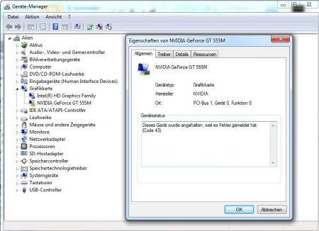

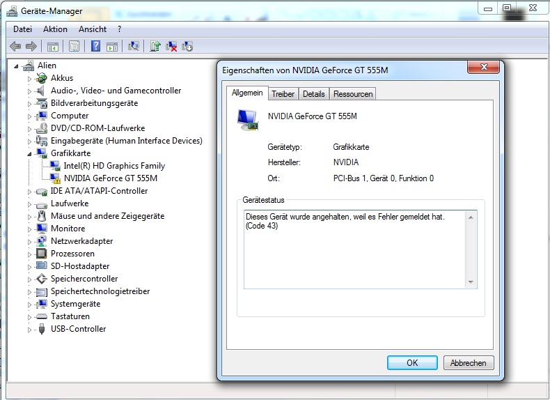

mark foster Posted September 26, 2011 Share Posted September 26, 2011 ok so i have tried the untested bios and it seems to disable the nvidia gt555 in device manager, it isnt working correctly. Back to old bios and works fine 1 Quote Link to comment Share on other sites More sharing options...
svl7 Posted September 26, 2011 Share Posted September 26, 2011 Ok, thanks for testing @Tyler27 and [MENTION=800]mark foster[/MENTION]. Any chance to see a screenshot of the device manager mark? Quote Link to comment Share on other sites More sharing options...
mark foster Posted September 26, 2011 Share Posted September 26, 2011 basically it just disables functionality of nvidia. i dont want to install bios again!! hahasays driver not working properly in the propertiesnothing else has changed ie drivers or software. they are all the same. just bios changed Quote Link to comment Share on other sites More sharing options...

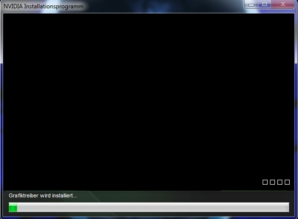

Nekojin Posted September 27, 2011 Share Posted September 27, 2011 Hi, ok after installing the new bios I run into the same problems than mark foster. 1 Volt seems to be too much for the card. I tried to install the NEW nVidia drivers 285.38 (yesterday release) and, well see for yourself^^ Black screen while driver install, deactivating the card... Back to A05 vmod unlocked. Can you change the voltage to 0.962 (or others, to see if this works)? Quote Link to comment Share on other sites More sharing options...
n3ocort3x Posted September 27, 2011 Author Share Posted September 27, 2011 I ran into the exact same issue a few weeks ago...@slv7 seems that this method he try dont work... we can´t use 1 V... we must find a way to go slightly below... i´m also running games at 840 and there is no problem... xD Quote Link to comment Share on other sites More sharing options...
