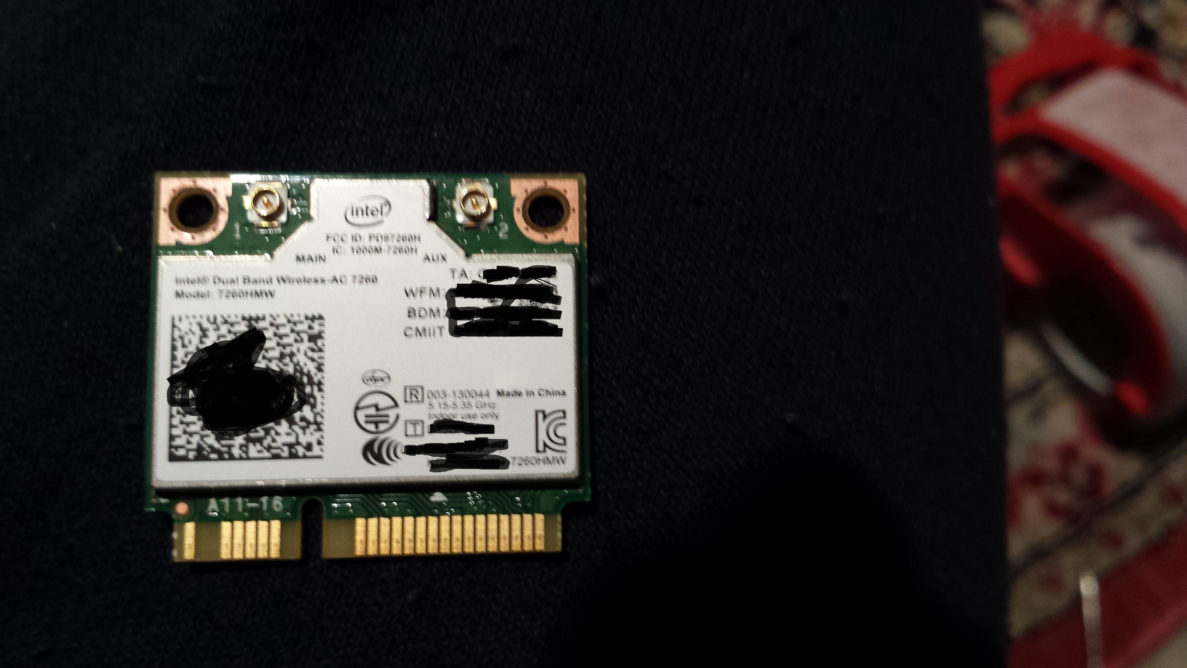

I have the same problem.. i have a y510p as well and i bought an intel 7260 ac from newegg and when i installed it into my system, it said that i have an unauthorized wireless card and that i should turn off the system and remove it... I called lenovo and they claimed that there was no such thing as a whitelist...
