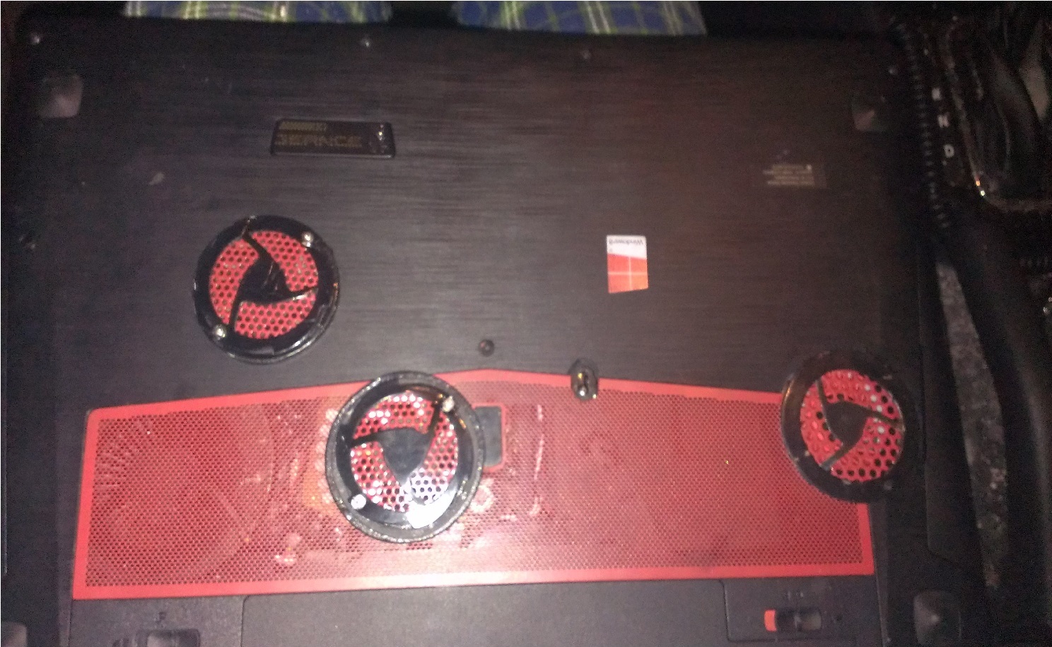

I think that when I drill small holes in the bottom cover there will be more airflow to keep the Y500 cool. Of course I will use a dustfilter... I've searched for a bottom cover but I didn't find one. I want to keep this one in case the project fails.

[ATTACH=CONFIG]9624[/ATTACH][ATTACH=CONFIG]9625[/ATTACH][ATTACH=CONFIG]9626[/ATTACH]the best way i have found so far is to totally rebuild the machine. more copper more fans= no heat
Well I'll be damned...
What kind of maximum temperatures under stress testing are you getting for CPU and GPU with this Frankenstein?
BTW great first post. :78:
Not the best looking modification, but if it does its job then well done.
I do not know how does the heatsink in y500 look by default, so I'm not sure what do you mean by "more copper". Did you add more radiators or...?

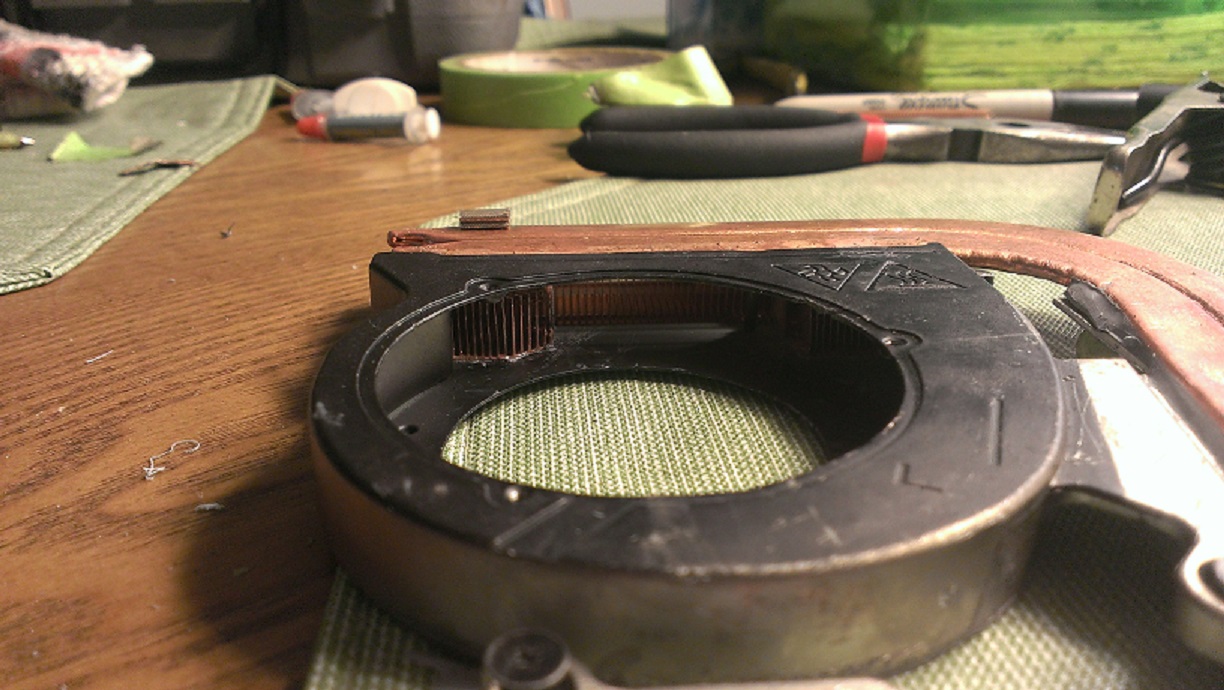

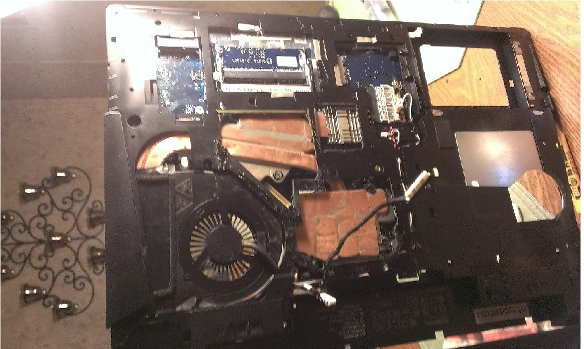

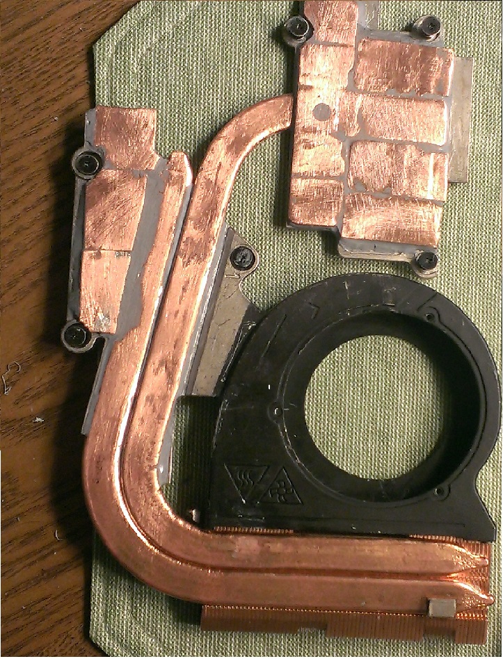

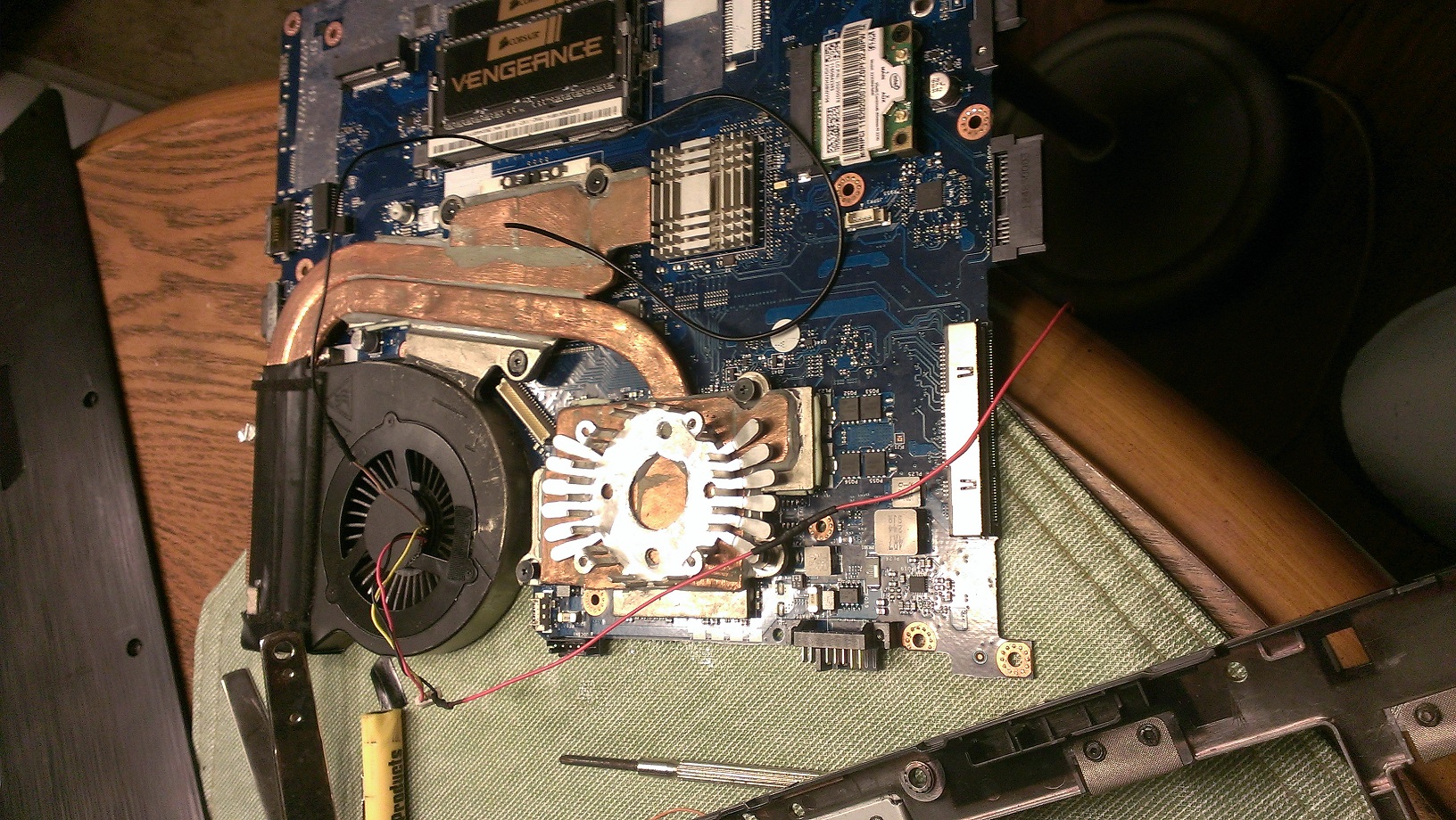

i did in fact add to the radiators. i added about 1/3 more. it was too iffy to solder the parts. copper heat pipes melting point is about the same as the solder. i opted for a custom thermal adhesive instead. i mixed it in a 2 parts thermal compound (antec nano diamond formula 7), to a 3 parts devcon 2 part clear (low viscosity ) epoxy ratio. adding the extra copper to the heatsinks required me to modify the whole motherboard tray, as i also was going to add 2 fan to directly cool the thicker heatsinks. post-12330-14494996421857_thumb.jpg i will provide some temperature tests soon . i been really busy lately

i did in fact add to the radiators. i added about 1/3 more. it was too iffy to solder the parts. copper heat pipes melting point is about the same as the solder. i opted for a custom thermal adhesive instead. i mixed it in a 2 parts thermal compound (antec nano diamond formula 7), to a 3 parts devcon 2 part clear (low viscosity ) epoxy ratio. adding the extra copper to the heatsinks required me to modify the whole motherboard tray, as i also was going to add 2 fan to directly cool the thicker heatsinks. [ATTACH=CONFIG]9643[/ATTACH] i decided to cut out a "breather" hole for the ultrabay gpu. [ATTACH=CONFIG]9644[/ATTACH] i will provide some temperature tests soon . i been really busy lately
