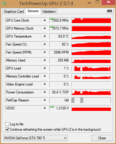

DStealth Posted November 21, 2013 Share Posted November 21, 2013 SVL7 thank m8 again for the great support and your fabulous BIOS for 780Ti..here's what my bad OC 71 asic card can do with it : 1 Quote Link to comment Share on other sites More sharing options...

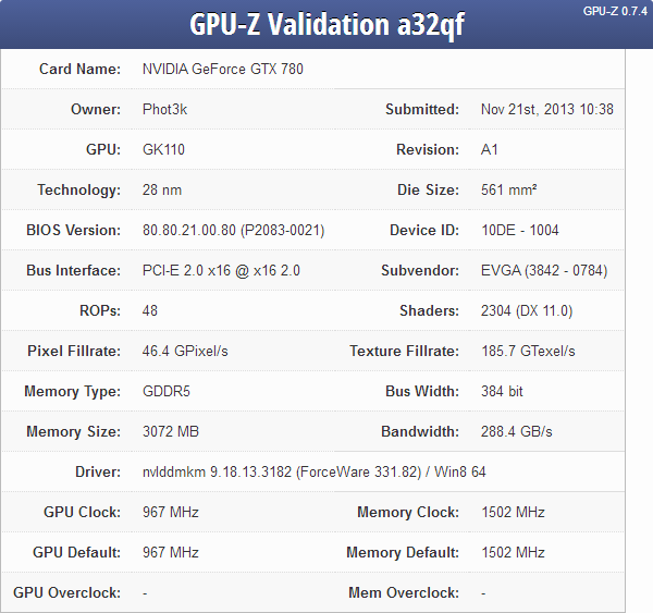

Phot3k Posted November 21, 2013 Share Posted November 21, 2013 Will you be creating a bios for the newer cards, I have the EVGA GTX 780 SC ACX. I would be willing to donate for it. Thanks. Quote Link to comment Share on other sites More sharing options...

svl7 Posted November 24, 2013 Author Share Posted November 24, 2013 Will you be creating a bios for the newer cards, I have the EVGA GTX 780 SC ACX. I would be willing to donate for it.[ATTACH=CONFIG]9629[/ATTACH]Thanks.Yes, that's on my list, hopefully tomorrow.Hey, im having a little question here, i wonder if someone has a working Modbios for the GTX 780 Super Jetstream from Palit, the card i have has the the BIOS "80.10.3A.00.07", what i really need is the possibility to increase the powertarget, and maybe raise the vcore to 1.21 or something, so i can clock higher, since i run into powertarget throttling with my 2 cards all the time.That card has a custom cooler, right? You could use one of the ACX vbios, that will work, but the fan control might be a bit off for your cooler.Haven't modified the Jetstream vbios yet.I have a MSI 780 Gaming Twin Frozr, I downloaded your Nvidia_GTX_780_(EVGA)_80.10.3A.00.82_-_'OC_edition_v03', I used dos nvflash -6 to flash and I have : Ovveride subsystem, I said Yes. Now I have : Board ID mismatch.Is it because my card is non reference design ?You probably have a card with a B1 chip. Haven't modified the vbios for that yet. Can you send me a copy of your verison? Quote Link to comment Share on other sites More sharing options...
