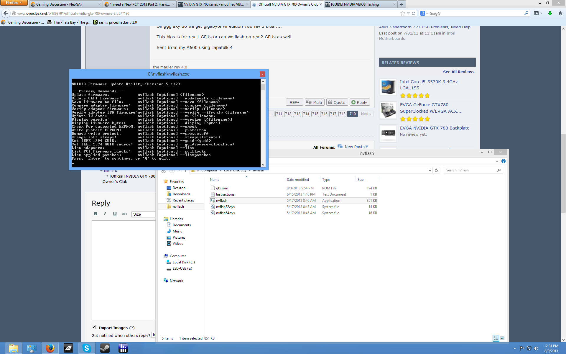

how do I flash it with nvflash? I keep getting this [ATTACH=CONFIG]8654[/ATTACH]
Shift-right click in the folder, open command window here and then type nvflash -6 filename.rom
I did -4 -5 -6 but it worked, is that okay?. Kinda weird though, I accidentally pressed shutdown instead of restart after flashing, anyway when I booted up I had no internet and precision X was still saying max power was 106%, restarted, now everything is fine, 115%, 1020 clock, is there a reason for this?
Doesn't matter in this case, but you will never have the need of -4 -5, just stick with -6 only and you're fine.
As for the issue after the restart... that can be related to many things. Nvidia's firmware is doing a lot of things beneath the surface which I don't like, that's related to the phenomena you noticed.
