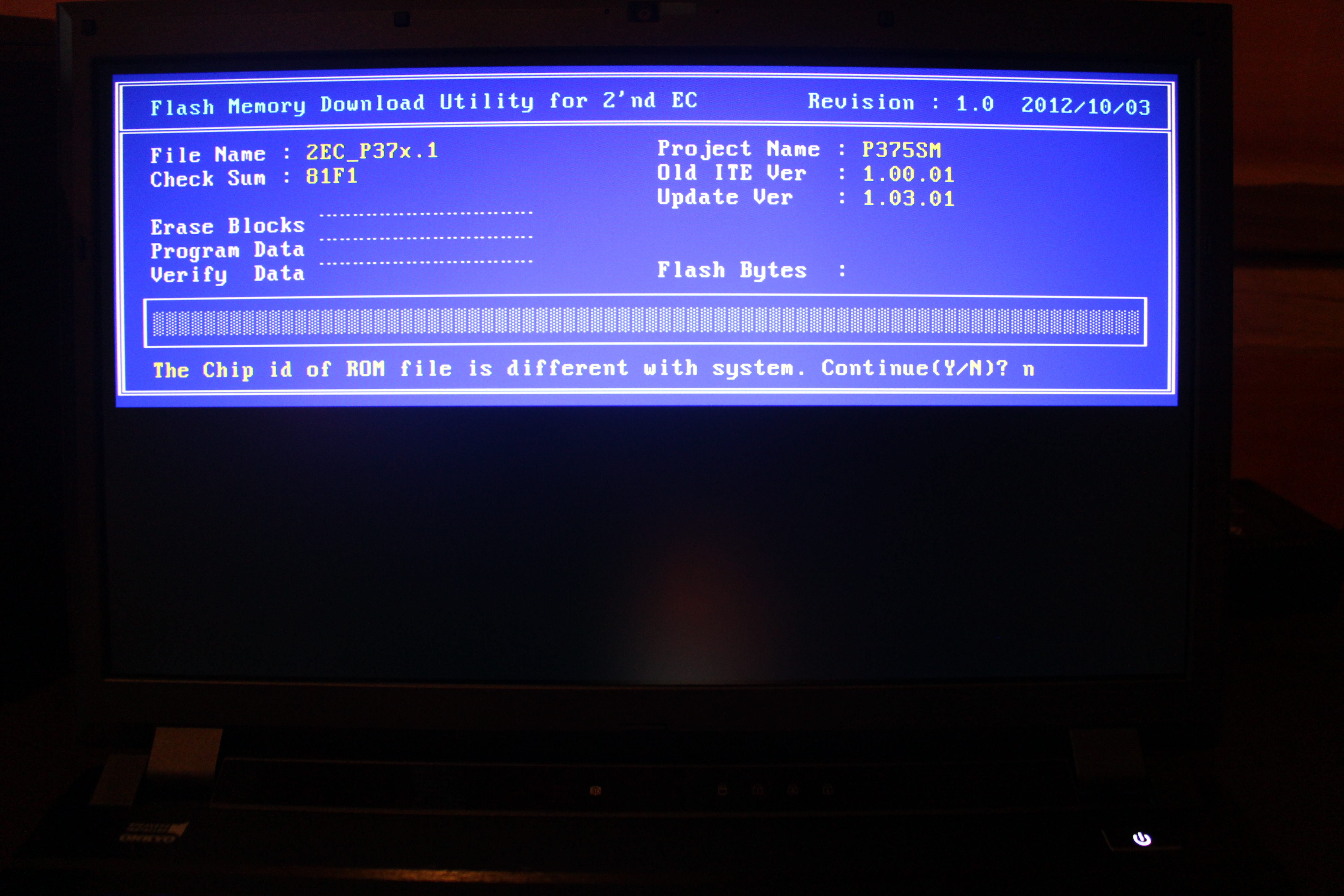

Hello,
my first message to this forum!
I bought a rebranded Clevo P370SM3 and started to update the BIOS to Prema's.
I downloaded it from his site and followed the instructions. After i keyed "step2" few things happened:
- There was text in some phase reading something like:
pdr region does not exist
gpr? region does not exist (not sure wast gpr or gbr)
-Upon updating the EC, it says following:
Project name: P375SM???
Is this ok to continue?
Yep! :D
"pdr region does not exist
gpr? region does not exist"
These are optional parts of the ME Firmware that are not used on these models!
As for the EC2 ID.
Clevo originally planed to only use it for the additional light control on the P375SM model, but later decided to include extended keyboard light functionality on P370SMx, too.
(It is also mentioned in the readme that this is normal and has to be confirmed with "YES")

Yep! :D
As for the EC2 ID.

Back online and back to updating BIOS. It finished flawlessly!
Thank you Prema! No doubt, with every install of your BIOS, you spread a little bit (alot!) of happiness all around the world! Keep up the good work!
