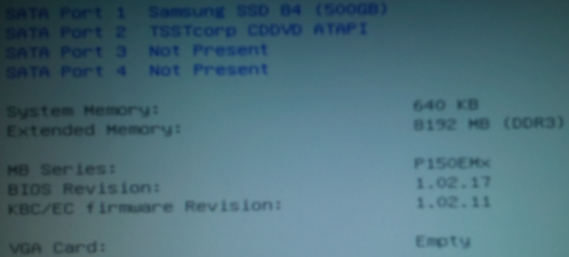

weebr0n Posted December 9, 2013 Share Posted December 9, 2013 Stock is the original Clevo BIOS, PM is the Prema Mod BIOS. We don't need to use Stock files first and can use the Mods directly (except in the one case above).I can provide you with BIOS/EC v4 but if your current BIOS/EC are already higher it will brick your Notebook to downgrade to v4.v4 is ONLY for people whose BIOS/EC is v1.00.03 or lower!!!I checked the BIOS and here are the info copied directly from there,MB Series : P150EMxBIOS Revision: 1.02.17RCLKBC/EC firmware Revision 1.02.11I wish to use the gtx 680m oc vbios as well as the prema mod bios, can you tell me how to proceed from here? Link to comment Share on other sites More sharing options...

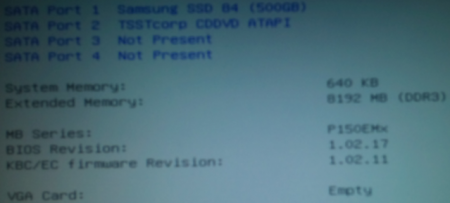

Guest Posted December 9, 2013 Share Posted December 9, 2013 I checked the BIOS and here are the info copied directly from there,MB Series : P150EMxBIOS Revision: 1.02.17RCLKBC/EC firmware Revision 1.02.11I wish to use the gtx 680m oc vbios as well as the prema mod bios, can you tell me how to proceed from here?Create a bootable pendrive:FLASHING GUIDE | Prema ModUse the Mod for your system from the OP according to the location of your Windows key and follow the incl. readme file:P-EM Regular Version > Win key on the right & FULL FAN = FN+9P-EM K2 VERSION > Win key on the left & FULL FAN = FN+1As your BIOS/EC is already up-to-date you can flash the vBIOS before or after the main BIOS Mod.ENJOY! Link to comment Share on other sites More sharing options...

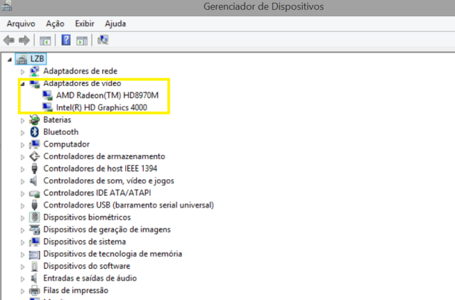

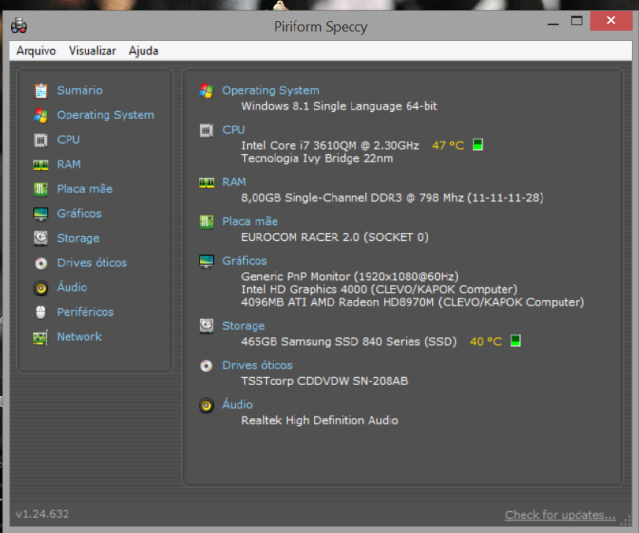

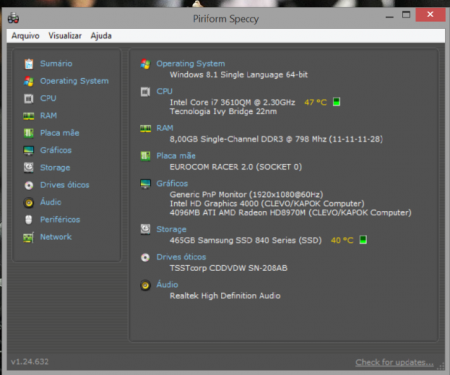

TheWindowlicker Posted December 10, 2013 Share Posted December 10, 2013 Hi, first of all, sorry for my bad english. Can i use that mod bios in form to update my stock bios? Because i'm having some problems with my GPU (Radeon 8970M) and i couldn't find the updated bios in the Eurocom site (ran Speccy and it says Eurocom Racer 2.0 as motherboard). The problems with my dedicated GPU are that i can't use it, i'm using the onboard GPU, Intel HD Graphics 4000. The current drivers of the ATI are the last ones, updated. No yellow exclamation points are shown in the device manager, only when i deactivate the onboard drivers, both exclamation points appears, on the onboard and offboard GPUs. My current bios is 1.02.17 KBC-EC firmware revision: 1.02.11 MB Series: P150EMx VGA Card: empty I've reinstalled WIN 8.1 three times, updated the chipset and GPU drivers. The bios update is my last hope. Thanks. Link to comment Share on other sites More sharing options...
Guest Posted December 10, 2013 Share Posted December 10, 2013 Oh.. I realised im unable to download it yet? perhaps due to insufficient posts..Anyway, my processor is i7 - 3610QM 2.3Ghz, will i be able to overclock it? You will gain BCLK overclock capabillities with the Mod through Intel XTU Software. Hi, first of all, sorry for my bad english. Can i use that mod bios in form to update my stock bios? Because i'm having some problems with my GPU (Radeon 8970M) and i couldn't find the updated bios in the Eurocom site (ran Speccy and it says Eurocom Racer 2.0 as motherboard).The problems with my dedicated GPU are that i can't use it, i'm using the onboard GPU, Intel HD Graphics 4000. The current drivers of the ATI are the last ones, updated. No yellow exclamation points are shown in the device manager, only when i deactivate the onboard drivers, both exclamation points appears, on the onboard and offboard GPUs. ... My current bios is 1.02.17 KBC-EC firmware revision: 1.02.11 MB Series: P150EMx VGA Card: empty I've reinstalled WIN 8.1 three times, updated the chipset and GPU drivers. The bios update is my last hope. Thanks. Your BIOS is the latest stock BIOS/EC. Your 8970M has mostly the wrong vBIOS version made for non switching graphics systems like the P370. Please check your current vBIOS version for the dGPU in GPU-Z. Link to comment Share on other sites More sharing options...
