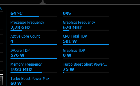

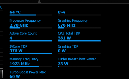

i have some strange issues on my system with 1.05. The cpu is not getting higher than 2,78GHz. I think this is caused by too much tdp on the core. If i flash back to 1.04 with new me, the system is running well with o/c. Any idea?
Here are my specs:
Schenker XMG P702 (Clevo P170EM)
Intel i7-QBC1-ES@4*3,9GHz
Nvidia 675MX@850/1250(=5000)MHz
2*8 GB DDR3-1866 Corsair Vengeance
Samsung SSD 840pro 256GB
Samsung SSD 840pro 512GB
Samsung SSD 840 500GB
Plextor SSD PX-256M5M mSATA 256GB
Using Intel XTU 4.1.0.12
P.S:
sorry for bad english skill. ;)
edit:
i'll try now the 2T-Version.
edit2:
same issue with 2t-version. :(
Those values are entirely out of spec, better uninstall that specific XTU version, clear the cmos and watch the multi with Throttlestop while not using the dGPU. Also what is HWinfo64 reporting in the μCU window?

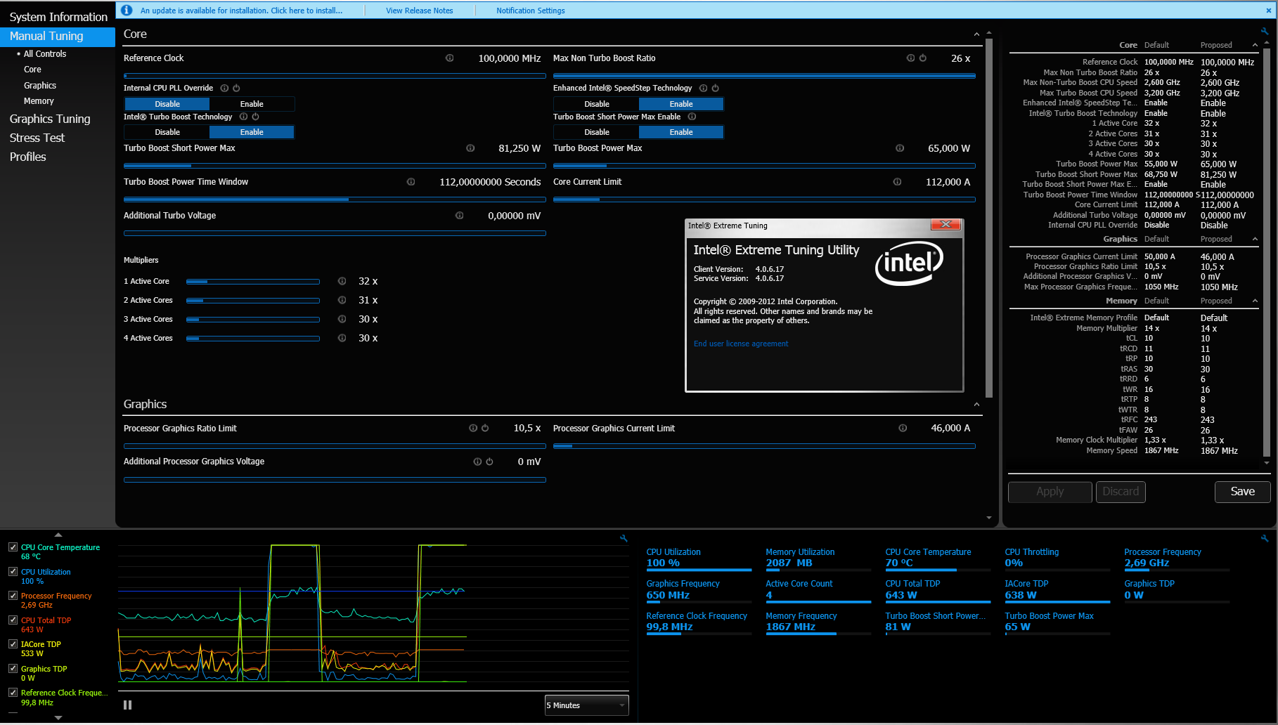

Tested with XTU from clevo (4.0.6.17) at default settings (Bios+ME 1.05). Same issue:
No problem so far with Bios1.04+ME1.05. BCLK is available and usable.
