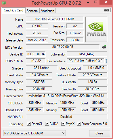

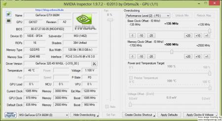

Please post a GPU-z screenshot. And NvidiaInspector screenshot too.
thanks for the quick repy
this is the image of gpu-z
nvidia inspector

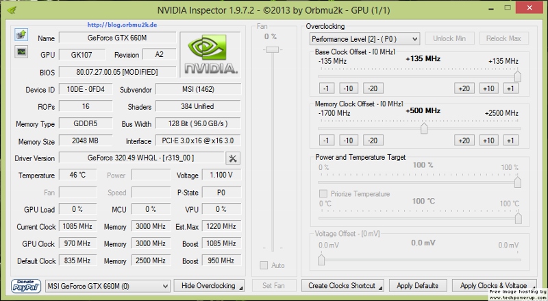

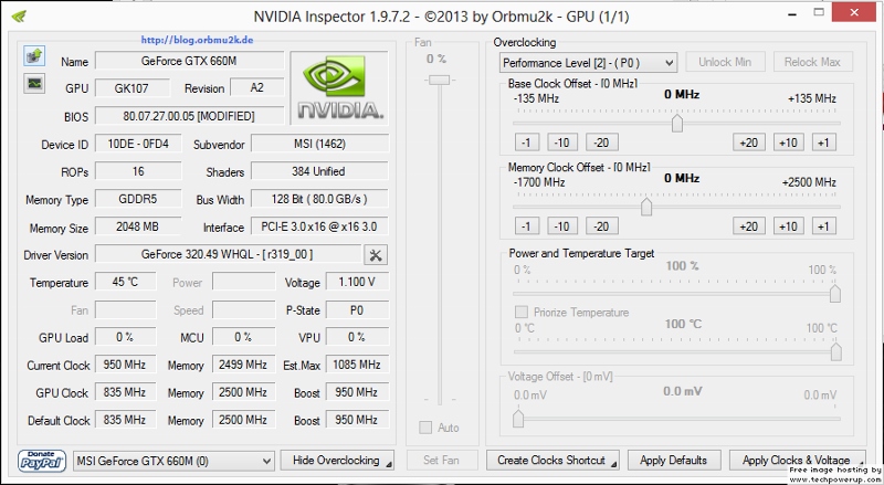

was able to see a guide for forcing nvidia inspector to oc by changing the values here 660M using Nvidia Inspector ?
but even with the high numbers of OC result numbers shown, the coreclock still throttle to 1085 benching with heaven benchmark 4.0. Any other Ideas how to get past the throttle?

nvidia inspector
[ATTACH=CONFIG]8708[/ATTACH]
So you haven't flashed Prema's BIOS. GPU-z says that your video BIOS is not modded. You need to try again. All commands should be launched in Windows (I assume) from 1 to 3. I assume you already have the latest 514 BIOS.
EDIT: I am wrong about GPU-z bios. Perhaps you already flashed right. But anyway try it again to make sure.

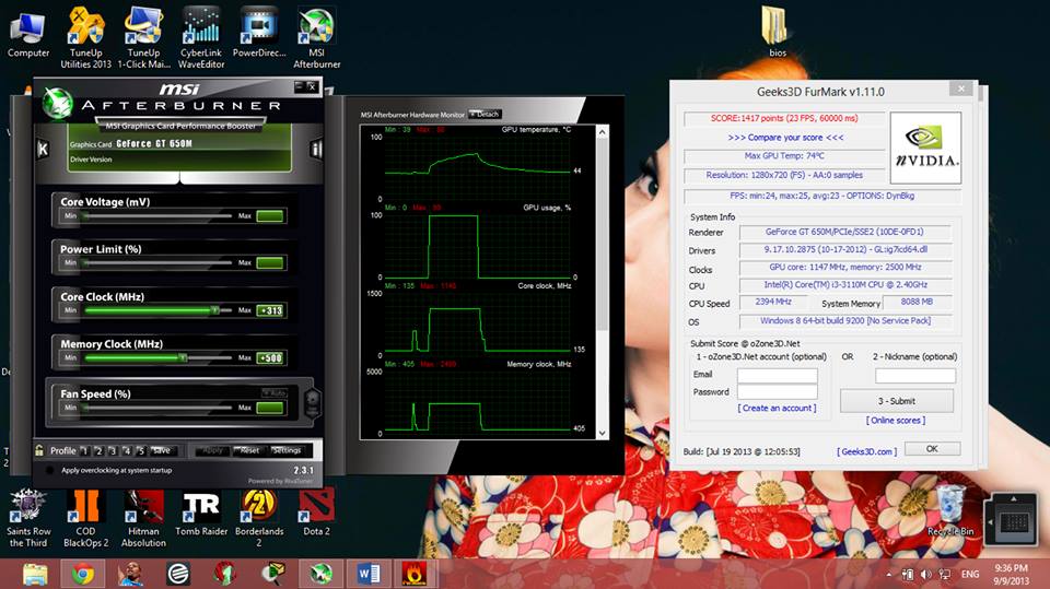

Any idea how much ambient temps affect the ge60? I have a ge60 0NC with a 650m. At home when playing CS:Go I'm hitting 84C, it's probably around 75F in the room I have to play in. Here at work I can't play CS:GO enough to see what temps it's getting to but the office is probably around 62 degrees. I was able to run 3dmark and furmark and the temps never went over 75C. Think I could chalk that up to ambient temps? The reason I'm interested is, I want to overclock my 650M but I'm already worried that it's hitting too high of temps, I did hit 87C at one point while playing.
Thanks!
Ambient temp effect it very much. Very very. But you can drill holes is the bottom of laptop for example or just take off bottom cover, although it is not comfortable at work. Maybe a cooling stand like Notepal U2? Try to put a book under it without blocking holes ad check how max temp has changed.
