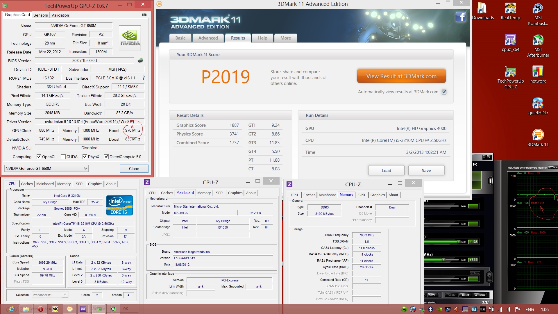

James D Posted March 2, 2013 Share Posted March 2, 2013 All is working as it should. No troubles whatsoever, only positive feelings.Thanks and I bet folks are waiting for a Prema Overvolt Edition:P 1 Link to comment Share on other sites More sharing options...

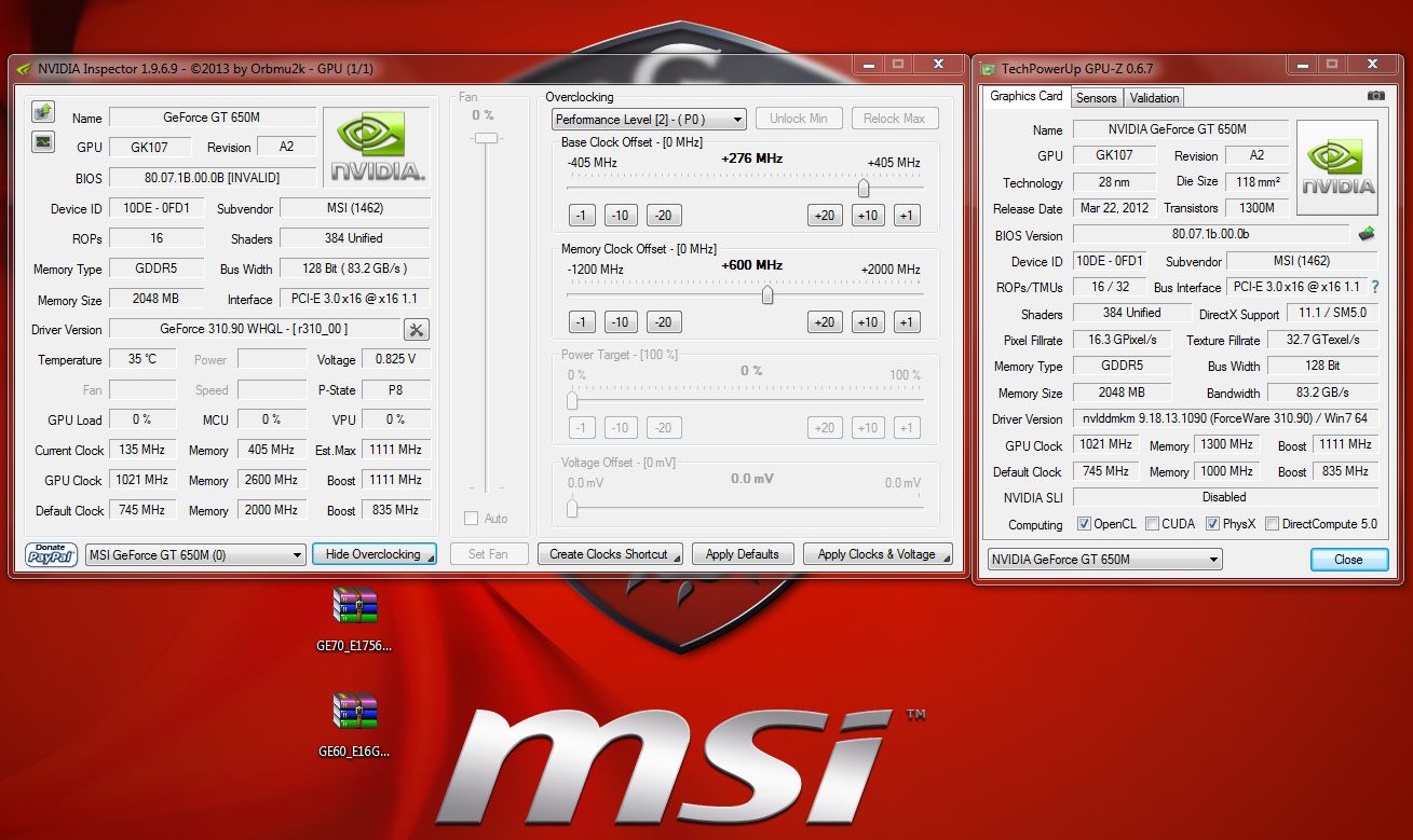

??????? ????????? Posted March 2, 2013 Share Posted March 2, 2013 ok, whatever, but i still have bsod if try change memory clock... gpu core clock i can max set is 1110mhz, thank you, thank you again GE60 Win7 660m work fine, tested world of tanks and sleeping dogs. Link to comment Share on other sites More sharing options...

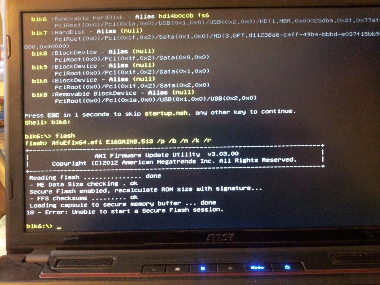

alextech3110 Posted March 2, 2013 Share Posted March 2, 2013 Prema, Help me, if you try to flash the bios GE60_E16GAIMS.513_WIN8_OC an error Link to comment Share on other sites More sharing options...

aaadddad Posted March 3, 2013 Share Posted March 3, 2013 I have just checked, all is working up to 1040 mhz. The higher frequency involve driver failure. May be higher current is required for stable working. Thank you again Premma. Link to comment Share on other sites More sharing options...
svl7 Posted March 3, 2013 Share Posted March 3, 2013 [ATTACH=CONFIG]6200[/ATTACH]Prema, Help me, if you try to flash the bios GE60_E16GAIMS.513_WIN8_OC an errorWhat's your current bios version? Link to comment Share on other sites More sharing options...
alextech3110 Posted March 3, 2013 Share Posted March 3, 2013 current bios version e16gaims.513 (11.08.2012) First Release: http://www.msi.com/product/nb/GE60-0NC.html#/?div=BIOS&nbos=win8 Link to comment Share on other sites More sharing options...
svl7 Posted March 3, 2013 Share Posted March 3, 2013 You can try flashing it with the /CAPSULE flag. Link to comment Share on other sites More sharing options...

alextech3110 Posted March 4, 2013 Share Posted March 4, 2013 AFUEFIX64 /CAPSULE ?FLASH /CAPSULE ?it does not workit, is not clear. Link to comment Share on other sites More sharing options...
Guest Posted March 4, 2013 Share Posted March 4, 2013 "/CAPSULE flag" please explain. I dont understand. What is my mistake? unzip the "FLASH.nsh" file from the attached archive and overwrite the one provided in the mod BIOS. That should solve the issue. Please let us know so we can save others some trouble. EDIT: Removed attachment (/CAPSULE not enough to circumvent security in this case...) Link to comment Share on other sites More sharing options...

alextech3110 Posted March 4, 2013 Share Posted March 4, 2013 "FLASH.zip" not help... "18-error: unable to start a secure flash session" Link to comment Share on other sites More sharing options...
Guest Posted March 4, 2013 Share Posted March 4, 2013 Hello, and whether the work of the GPU Boost technology from Nvidia for your BIOS settings for the GT60-0NC win8 UEFI? With native BIOS overclocking is not working and the GPU Boost technology. problem: not work GPU BOOST & OVERCLOCK (GT-650m - always 745mhz)All hope on Prema.... EDIT: OK, now I understand: the Turbo Boost doesn't work on stock vBIOS at all...LOL. That's no problem once you use the mod you can raise the 3D clocks higher than stock Turbo Boost clocks: "FLASH.zip" not help... "18-error: unable to start a secure flash session" OK, the MSI WIN8 security requires the BIOS to be flashed in a way, which I would have liked to avoid...I have pulled the WIN8 versions for the time being and will put something together once I find the time... EDIT: alextech3110, check your PM for an alternative flash test Link to comment Share on other sites More sharing options...

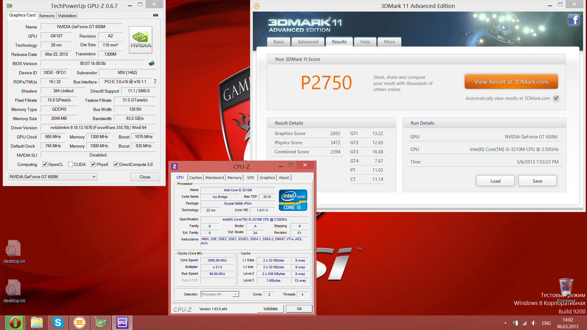

samuel55 Posted March 6, 2013 Share Posted March 6, 2013 Works like a gem! Great Work! am currently stress testing. any max values you could recommend? Edit: after some rounds of stress testing, i found that mt turboboost works. OCing by 245 mhz boosted me to a whopping 1080mhz. making the base 845, which was the turboboosted value i had at stock. i thought that i should give you a heads up @Prema. mines a GE60 with a 650m btw. oh and is 90 degrees max good? Link to comment Share on other sites More sharing options...
Guest Posted March 6, 2013 Share Posted March 6, 2013 Congrats, but you should try to avoid reaching 90c on a daily basis, it's OK for benching etc... Link to comment Share on other sites More sharing options...
