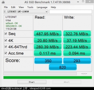

I got the Liteon M3M 256GB I get around 450/380 mb/s (using CrystalMark). Not as advertised but can't complaint about everything in life :) .. I will focus my complaints on the US tax system and high property taxes :)

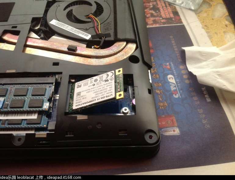

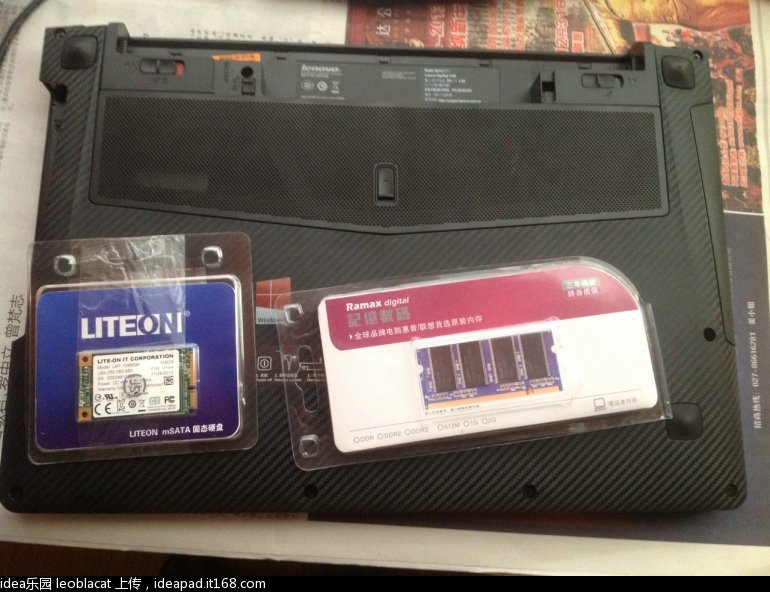

Parts bought.
[ATTACH=CONFIG]6095[/ATTACH]
Put the new msata in place (2 screws needed)
[ATTACH=CONFIG]6096[/ATTACH]
So far I'm enjoying the upgrade and hopefully this answers some questions.
Do you have more pictures of your system disassembled? I've noticed that there are some pretty significant differences just from the 2 pictures above when compared to my Y500. Looks like Lenovo did some updating to the internals to include the cooling. Is your Y500 equipped with the 750m?
n1smo dont you own the 3210M model ?
I noticed there are 35W and 45W boards for Y500.
I am running the i7-3632QM. I could be wrong, but it seems the Asian Y500s are quite a bit different from the rest of the world Y500s. The OP's laptop is the same one as the Lenovo dis-assembly video on YouTube. I wonder if they get better cooling too, I've been watching the Malaysian websites and their Y500 seems to run much cooler, or at least one of the guys posting over there is claiming much cooler temperatures... 55C max.
IF you ever happen to open up your Y500 write down all the FRUs or SKUs you find. I think you have a 35W motherboard and cooling if that exists. I mean the 35W cooling.
