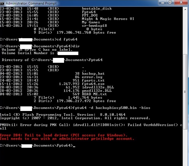

wolla Posted March 23, 2013 Share Posted March 23, 2013 Hi I get the below error message when attempting to backup the existing bios - even though I am running as administrator. "Error 284: Failed to load driver (PCI access for Windows)" Quote Link to comment Share on other sites More sharing options...

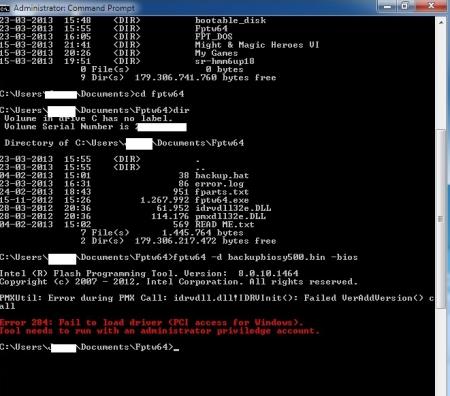

wolla Posted March 24, 2013 Share Posted March 24, 2013 HiI get the below error message when attempting to backup the existing bios - even though I am running as administrator."Error 284: Failed to load driver (PCI access for Windows)"[ATTACH=CONFIG]6374[/ATTACH]Any help on this would be much appreciated! Quote Link to comment Share on other sites More sharing options...
svl7 Posted March 24, 2013 Author Share Posted March 24, 2013 I guess that's a crappy AV software which randomly blocks signed drivers... 1 Quote Link to comment Share on other sites More sharing options...

wolla Posted March 29, 2013 Share Posted March 29, 2013 I guess that's a crappy AV software which randomly blocks signed drivers...You were right - thanks! Quote Link to comment Share on other sites More sharing options...
wolla Posted March 29, 2013 Share Posted March 29, 2013 Made it to the flashing part, but when trying to flash I now get the following error:Error 28: Protected Range Registers are currently set by BIOS, preventing flash access.please contact the target system BIOS vendor for an option to disable Protected Range Re1gisters.Any advise? Quote Link to comment Share on other sites More sharing options...
svl7 Posted March 29, 2013 Author Share Posted March 29, 2013 I advise you to read my instructions carefully. Quote Link to comment Share on other sites More sharing options...
